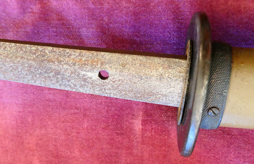

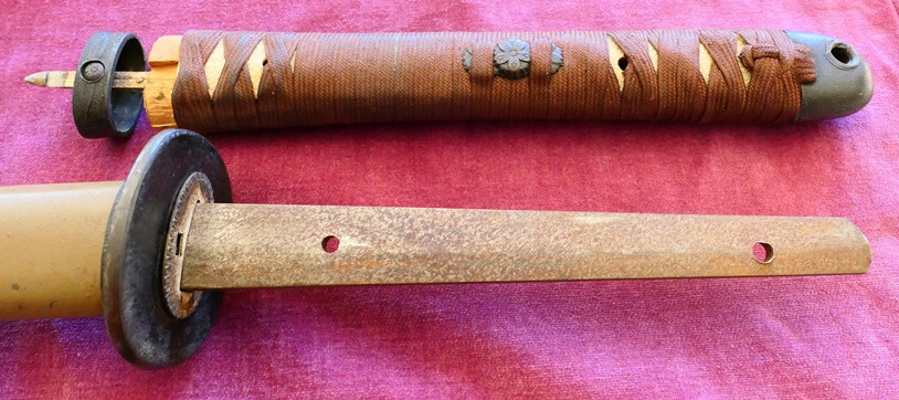

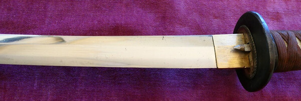

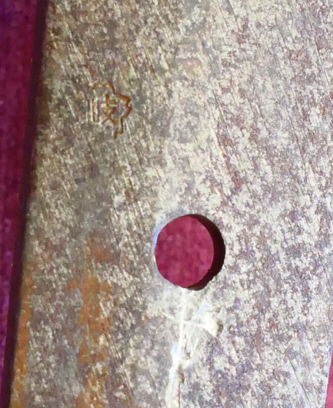

paulatim Posted January 19, 2022 Report Posted January 19, 2022 Further to your comment, George, on your “celluloid same” thread, I have made a new post to show my new (and first) “RS” shin-gunto. Today I closely examined the nagako under strong magnification. I wasn’t expecting find anything other than the painted characters which showed on the former owner’s pics, so I was delighted to discover a “Gifu-in-sakura” stamp! (thank you Bruce P, for your excellent article). Whilst the blade may not be particularly interesting to many, I’m very happy to have this well-preserved example. For me these RS represent much more than what one sees at face-value :-) I’ve attached a number of pics. Regards to all. Paul 3 1 Quote
BANGBANGSAN Posted January 19, 2022 Report Posted January 19, 2022 I used to have one of these Mumei RS when I started collecting Gunto years ago, but I didn't take any photos of the tang. Quote
DTM72 Posted January 19, 2022 Report Posted January 19, 2022 So now we have @paulatim with a mumei RS, @BANGBANGSAN that had an mumei RS. Now we can add mine to the short list. Plus, mine has the celluloid same' as well. This one is getting very strange. 2 Quote
george trotter Posted January 20, 2022 Report Posted January 20, 2022 Well, Paul, Trystan, Dan...I've been 'into' WWII gunto full-on for 20 years and I have never seen an unsigned/undated RS. As your mumei example is "Gi" stamped Dan, it is clear it went through the manufacturing procedure according to the rules. So, interesting...nice example too. Thanks...again, with Japanese swords, never say never and never say always! Regards, 1 1 Quote

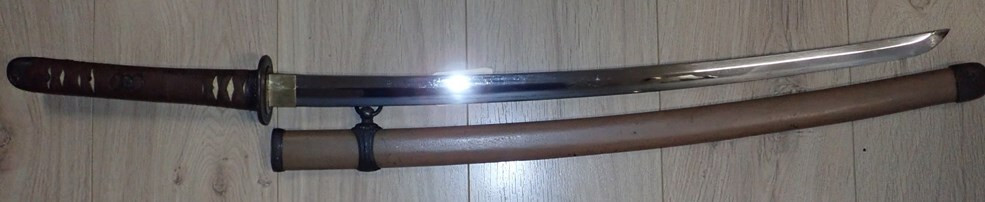

BANGBANGSAN Posted January 20, 2022 Report Posted January 20, 2022 On 1/20/2022 at 2:23 AM, george trotter said: Well, Paul, Trystan, Dan...I've been 'into' WWII gunto full-on for 20 years and I have never seen an unsigned/undated RS. As your mumei example is "Gi" stamped Dan, it is clear it went through the manufacturing procedure according to the rules. So, interesting...nice example too. Thanks...again, with Japanese swords, never say never and never say always! Regards, Expand My friend had a better fitting RS with a mumei blade, it seems arsenal made with the number. There is another one just like he's, and has a very close number. Quote

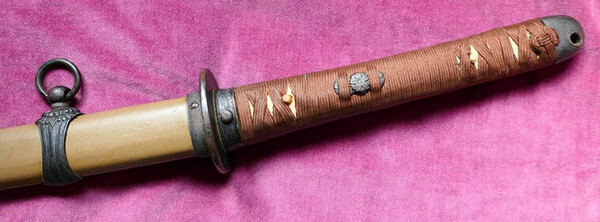

george trotter Posted January 20, 2022 Report Posted January 20, 2022 Interesting. Are both of these gendaito? - yours especially Trystan looks RJT quality but with no mei - strange. Both in good quality fittings. Those RS mounts are the type usually seen on swords made in the Osaka-Kyoto-Hyogo region of the RJT scheme...my type (see pic) of "fat/plain/no hanger or chape type scabbards I have seen about 5-6 times....maybe intended for leather or canvas cover to have hanger loop? These made in same area). I have seen two (see pic) from Kyoto by Kunihide and both were August 1944 and both had small numerals stamped on the nakago mune...mine has 98 and the other has 90. The numbers seem the same size, position and 'layout' as yours - except these do not have the number '1' (smith's tally number?) stamped beside them. I know Bruce has a 'table' of tang numbers (I seem to remember) he has collected, so I think maybe this is one more mystery for Bruce - Sherlock to look into? (I haven't got a pic of the tang mune number on mine Bruce but just say the word and I can do one for you). Regards, 1 Quote
BANGBANGSAN Posted January 20, 2022 Report Posted January 20, 2022 On 1/20/2022 at 2:17 PM, george trotter said: Interesting. Are both of these gendaito? - yours especially Trystan looks RJT quality but with no mei - strange. Both in good quality fittings. Expand Those 2 wood saya RS, one is my friend's, one is from the internet. Both are not likely Gendai but arsenal blade. The one I use to have is in the metal saya cheaper version, not Gendai blade, but I forgot if there is any arsenal mark or numbers on the tang, it was a long time ago. Quote

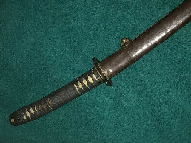

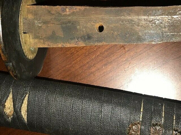

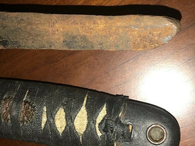

DTM72 Posted February 10, 2022 Report Posted February 10, 2022 Just found another rough shaped mumei nakago on a Type 3 RS on ebay. https://www.ebay.com/itm/284634787477?hash=item42458e2e95:g:qo4AAOSw7odh-XGL @Bruce Pennington @george trotter Quote
vajo Posted February 11, 2022 Report Posted February 11, 2022 Dan that sword looks assembled together from parts and it is not Type3. The ito maki looks made by an amateur Quote
DTM72 Posted February 11, 2022 Report Posted February 11, 2022 On 2/11/2022 at 6:19 AM, vajo said: Dan that sword looks assembled together from parts and it is not Type3. The ito maki looks made by an amateur Expand I noticed the poor quality of this as well, but wondered if this is truely one of the "last-ditch" pieces rushed into use. Possibly forged and assembled outside of Japan. Quote
george trotter Posted February 11, 2022 Report Posted February 11, 2022 Thanks for the link Dan. Gut feeling is ... ummm...nothing to get excited about! Hard to tell much due to poor quality/small size of pics. Blade looks good-ish, tang too rusty/rough to tell much on age etc. Scabbard and tsuba definitely non-military, only hilt fuchi/kashira are RS....one hole in tang?, can't see any sign of a peg hole in the hilt...overall verdict...not RS. Might be a private sword 'militarised' for field use. Regards, 1 Quote
Bruce Pennington Posted February 11, 2022 Report Posted February 11, 2022 These are really puzzling to me. The blade and kissaki look really good: But the nakago are horrid. I might lean toward Dan's @DTM72 idea, as this blade doesn't look Japanese, but rather off-mainland made. With Nick Komiya's post in mind about mainland sword production being almost totally wiped out in the last year of the war and production being forced over to occupied territories. If the blade were crap, I'd even lean toward total fakery, but it looks appropriately aged for WWII, so I'm 51% at a combination of George's and Corry's thoughts - civil tsuba/saya, late war tsuka, island-made blade. In other words, a late-war, work with what you've got, sword. Quote
george trotter Posted February 11, 2022 Report Posted February 11, 2022 that is one H--l of a rough hammered tang!...hard to believe it has a reasonably good blade on the other end... Quote
DTM72 Posted February 11, 2022 Report Posted February 11, 2022 On 2/11/2022 at 2:33 PM, george trotter said: that is one H--l of a rough hammered tang!...hard to believe it has a reasonably good blade on the other end... Expand I feel the same about my RS...it has hammer marks still on it! From the habaki to the kissaki it is beautiful. Single mekugi-ana as well. Could it be that these were rough forged and rough shaped in occupied territory, then shippied to the mainland for final polish and fitting? The polish on mine is a good WWII type polish. Definitely not an amateur type polish. Quote
george trotter Posted February 12, 2022 Report Posted February 12, 2022 On 2/11/2022 at 10:35 PM, DTM72 said: Could it be that these were rough forged and rough shaped in occupied territory, then shippied to the mainland for final polish and fitting? The polish on mine is a good WWII type polish. Definitely not an amateur type polish. Expand That is a hard one Dan. I can only give you my opinion on this. Personally, based on a lifetime study of WWII swords, I really feel that the domestic Japan military showa sword industry did manage to struggle through and kept producing up until August 1945...yes the NCO sword patterns did get more 'economical' in their manufacture as the war progressed, but they seem to have carried on. In the case of Type 98 however, there was no real evidence of 'cutting corners' on parts quality etc and other than the intro of the RS 'optional choice" (still classed as a Type 98) in 1941 the Type 98 stayed generally common and good quality...the dates on the tangs should give evidence that that Type 98 and RS went through til Aug? 1945 (maybe members with 1945 tangs could comment and/or post? - or maybe already on Bruce's lists?). While some other 2 or 3 posts (Trystan) show a mumei RS sword, what is shown here is not a RS...just the use of some RS hilt fittings . Where/how/by whom yours blade was made is unknown...I don't 'feel' it was overseas. Blade production in Japan was going OK to 1945 I think. I say this as I have a RS study book that gives the monthly RJT sword output of a RJT smith I have between 14/8/1944 - 26/2/1945 (about 10/month, as per the RJT rules). Another comment has smiths still doing their payment account paperwork up to 8/1945...so the RJT scheme lasted to the very end of the war it seems. So, I think it wise to assume that the Japanese WWII sword industry overall operated OK in Japan from 1930s-1945. Of course some 'oddities' came in from occupied areas (hobby swords as in Fuller & Gregory?) and the well-known Manchurian industrial setup...but I don't see any evidence for a 'back-up' industry overseas. I can't explain the one you ask about here, but I think it was made local in Japan. Just a point of interest...it is only in the last 6 months that I have seen evidence on NMB of unsigned, rough tang, 1 hole tangs on RS swords...after 50+ years!...I don't think 2 or 3 swords of this type after 50 odd years is evidence of an overseas back-up system....just don't know what it is evidence of...maybe just the 'never say never/ never say always' of Nihonto collecting.. Not much help I know, but don't forget "Okum's Razor" (the simplest answer is usually the right one)... in this case, simply an 'odd' WWII sword in 'cobbled together mix' of fittings...nothing more? Regards, 5 Quote
