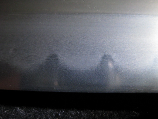

Guest nickn Posted March 5, 2009 Report Posted March 5, 2009 the sword that strarted this post looks from the hard bits a the peak of the gunome to be oil quenched water quenched blades dop not get these hard dead spots i hope this make sense Quote
Guido Posted March 5, 2009 Report Posted March 5, 2009 water quenched blades dop not get these hard dead spotsi hope this make sense Sorry, but even after reading your reply quite a few times it doesn't make any sense at all to me. Not being a native English speaker might be the explanation for that, though. John has a lot of hands-on experience, and Koichi used to earn a living in this field. I have no background in metalurgy, but what they told us makes perfect sense to me. Why can't we just accept what they said? Anybody more qualified may step in, but for the time being I tend to stick with those who know what they're talking about. Quote
Guest nickn Posted March 5, 2009 Report Posted March 5, 2009 oil quenched blades have a hard dead spot at the top of the gunome which you do not see in water quenched gunome hamon this is not my oppinion but fact .from the photos this sword has a gunome based hamon with the tell tale hard dead bright spot that you see on oil quenched swords so in my oppinion its oil quenched i do not have any oil quenched blades in my collection perhaps someone else can post some photos here is a very bad picture of what i mean Quote
Guest nickn Posted March 5, 2009 Report Posted March 5, 2009 if you read the sellers description he says its not nihonto but suggests its not oil quenched he doesnt say its water quenched so from his description the stamp no hada and the photos it quite certain its oil quenched showato Quote

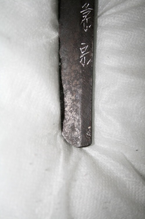

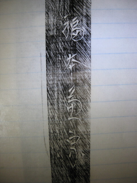

loiner1965 Posted March 5, 2009 Author Report Posted March 5, 2009 just to add.....my sword which is made by fukomoto kanemune which started this thread off and i never noticed before also has the elusive winged wheel stamp on the tang....cannot take good picture of hamon as its hard to capture but easy to see if you understand....i might have it polished lol Quote
loiner1965 Posted March 6, 2009 Author Report Posted March 6, 2009 hard to tell due to light and polish but the temper goes all the way.....not sure if its nortare or three peaks etc Quote
