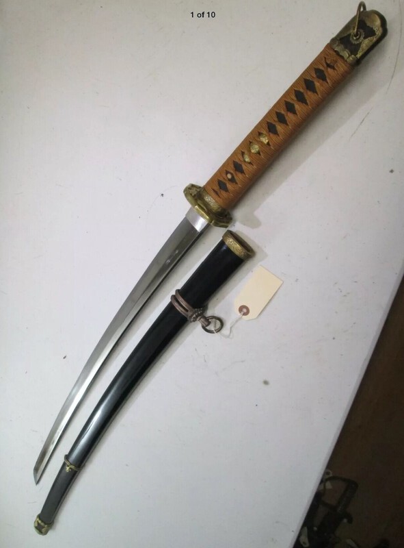

KB1107 Posted January 17, 2022 Report Posted January 17, 2022 Hello all, A friend of mine recently purchased (Or think he did) a WW2 late naval sword. He said it was from the John Plimpton sword collection. He received it today and showed it to me. I immediately had my doubts... I’m not an expert by any means with swords. What caught my eye the most was how clean and perfect everything is... the tsuba is brass (Not iron/naval), the tsuka is perfect (Too perfect), the suspension ring doesn’t match the rest of the saya fittings. The blade is nice and heavy and appears to be the only thing original WW2 part. Any thoughts? The seller seems to have good feedback and appears to be selling a lot of swords from this collection... I hope I’m wrong and it’s just a nice piece. Quote
Bruce Pennington Posted January 17, 2022 Report Posted January 17, 2022 Hmmmmm..................... This has all the appearance of one of the post war souvenir gunto made by the Tenshozan Factory. Read this ARTICLE ON THE POST WAR SOUVENIR. But the souvenir, until now, always had a rounded steel tsuba, and more gilded metal fittings. It's only a guess, but my thinking is that it's one of the first versions of the souvenir. There's certainly a chance it's a late-war gunto. The only thing not "army" is the black fabric same'. But I've seen a good number of these and the overall look is of the souvenir gunto. Quote
Brian Posted January 17, 2022 Report Posted January 17, 2022 All of the people involved in the Plimpton sale are reputable and most are members here. If it's from that collection and one of the sellers (search Plimpton here) you should be fine. It's not a fake, and these have been discussed for many years. It may be wartime, it may be assembled from wartime parts just after the war. Has a stainless naval blade. What did he think he was purchasing? That will decide if he got a good deal or not. Quote
KB1107 Posted January 17, 2022 Author Report Posted January 17, 2022 Thanks Bruce and Brian... he thought (he hopes) the he purchased a late war naval sword. I’ve looked at this morning... the tsuka looked to be black fabric and not black same’. Very good chance it’s a souvenir. The listing said late naval sword. As I said, the blade looks like the only original part to me, but I’m no an expert. i agree, I looked at the swords in that collection and they all appear to be originals. He spent a decent amount of money on this sword, too much if it’s only a souvenir. Quote
Bruce Pennington Posted January 17, 2022 Report Posted January 17, 2022 The souvenirs sell for 400 $ to 500 US$. All the fittings are army, not Navy. People get tricked by the Black scabbard paint, but there were plenty of army swords with black painted scabbards. It can also be confusing to see a navy stamped blade in army fittings. That did happen, but was not common. Quote

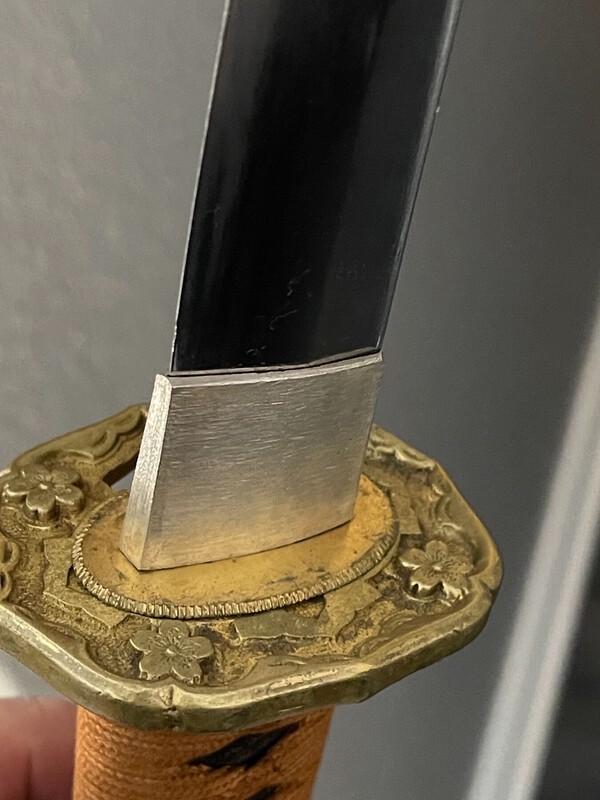

ROKUJURO Posted January 17, 2022 Report Posted January 17, 2022 The HABAKI looks a bit strange, but I cannot see it clearly. Quote
KB1107 Posted January 17, 2022 Author Report Posted January 17, 2022 He sent me pics of the habaki... Quote
Ian B3HR2UH Posted January 17, 2022 Report Posted January 17, 2022 David , your friend didn't get what he thought he was getting . This is horrible. Ian Brooks 1 Quote
KB1107 Posted January 17, 2022 Author Report Posted January 17, 2022 Yup,,, that’s been my concern. I wish he would’ve asked my opinion before he purchased.... $1000.00 mistake Quote
ChrisW Posted January 17, 2022 Report Posted January 17, 2022 That habaki is truly an aberration and the casting quality on that fuchi sticks out like a sore thumb. Did he really get this from the Plimpton collection sale? Quote
KB1107 Posted January 17, 2022 Author Report Posted January 17, 2022 Yes he did... as far as I know. He showed me the listing. I told him to contact them and explain he didn’t get what was advertised. He now too embarrassed to do it... Quote

PNSSHOGUN Posted January 18, 2022 Report Posted January 18, 2022 Hi David, this is from the same collection and a good example of what they should look like: https://www.ebay.com/itm/234381128137?hash=item36923431c9:g:2R0AAOSwtKhh5Yq3 They are smart looking pieces, despite their post war assembly. Quote

ChrisW Posted January 18, 2022 Report Posted January 18, 2022 Appears the habaki is correct! But goodness, it certainly is an eyesore. The overall package looks fine but perhaps the casting quality is low because they were unable to finish them properly and had to rush. I am excited to see the Plimpton collection book. Good luck with the sales Grey! Quote
Brian Posted January 18, 2022 Report Posted January 18, 2022 I think too many people smoking dubious stuff here. When did we go from legit late or post war sword assembled by Japan Sword Co, to terrible quality abomination? Seriously? These are recognized as Japanese swords and are over 75 years old, made in Japan, from mostly wartime made parts. The blade is a genuine SS blade, the fittings likely made late war and some just after. It's not some Chinese repro. They are not junk and many sit in good collections. Telling the OP that it's junk is just not accurate. Especially since research on these is not concluded yet. It is not just a cheap junk souvenir. I expect there is a lot of truth still to be uncovered about these, like how and why they had permission to make and sell these and to whom. I'm with Grey here, and the guys selling the collection. Whoever purchased it, added a decent markup to get to where it sold. And even at the end price it is around where a machine made NCO sword is priced at. Let's not put these at the level of modern Chinese fakes...they are not. 1 1 2 Quote
