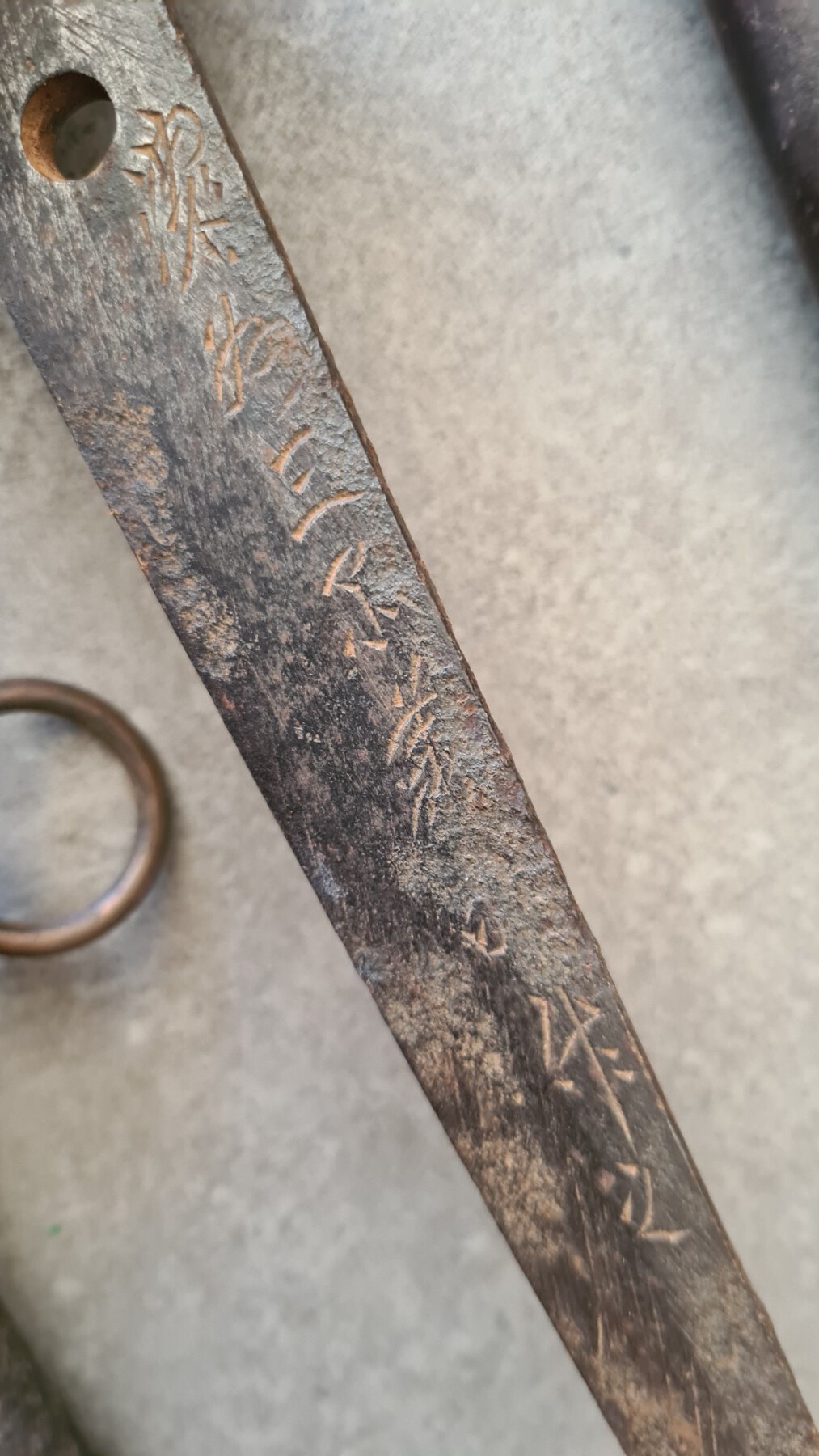

Bazza Posted January 15, 2022 Report Posted January 15, 2022 MINO(? or NOSHU) MIHARA YOSHI ? SAKU KORE BaZZa. Quote

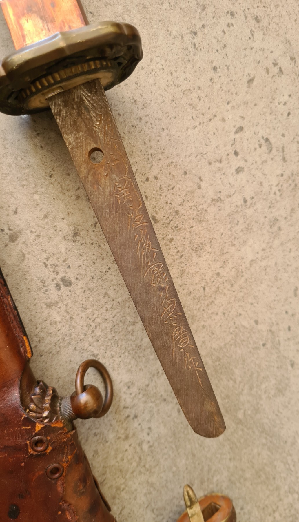

Pippo Posted January 15, 2022 Author Report Posted January 15, 2022 This one was unsure of the signature being correct, blades very straight and tsuba very clean/ new looking, any thoughts? Quote

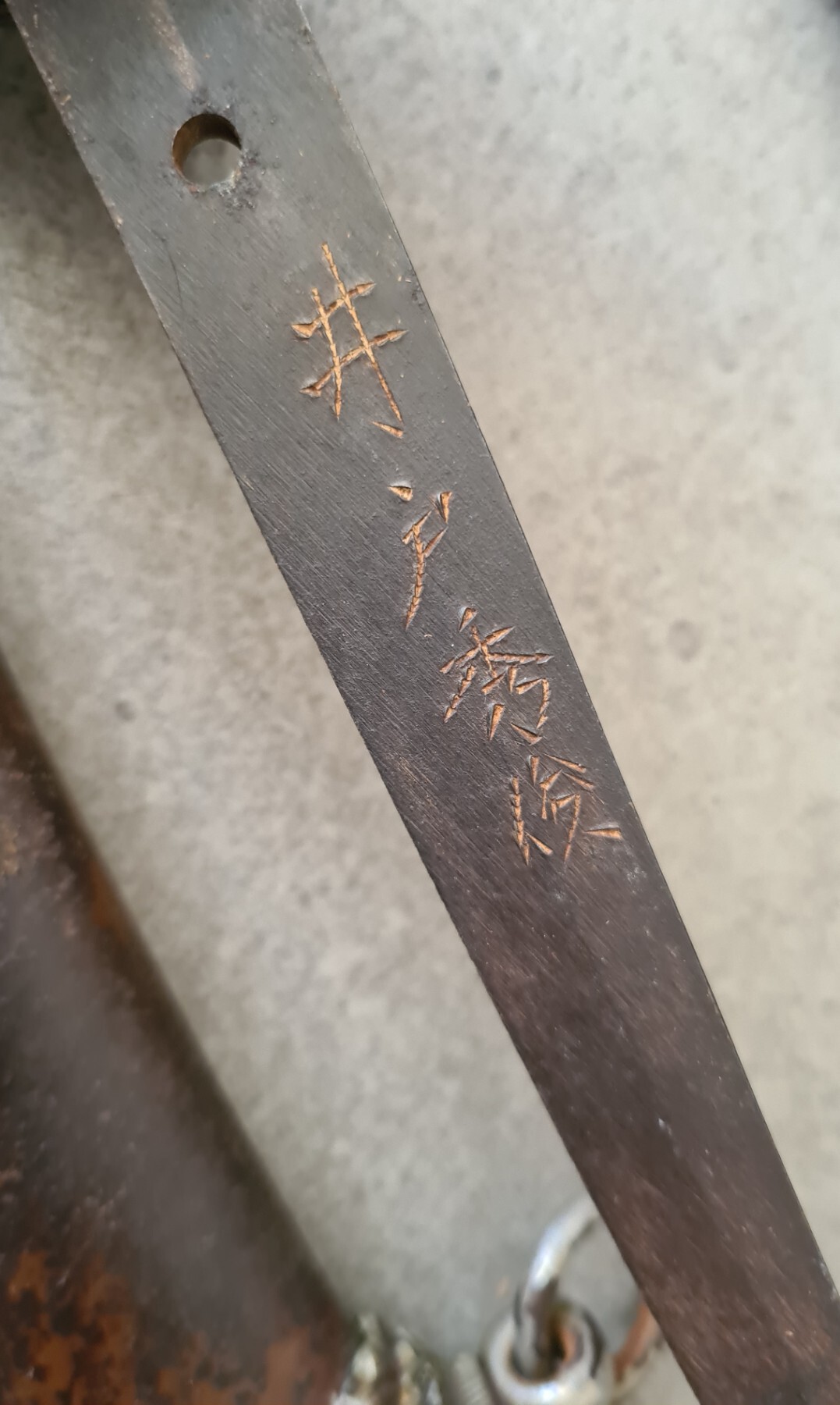

mecox Posted January 15, 2022 Report Posted January 15, 2022 Pippo, all appear to be Seki Mino swords. TOP: Seki ju Goto Kanehiro saku ( has a stamp been filed off at top). He is in Slough p. 43. In 1941 exhibition was 4th seat of 5. In 1942 list he was 6th level of 7. MIDDLE: Ido Hidetoshi real name Ido Toshimi, born June 14 1915. Died Sept 18 1985. In Slough p, 33. In 1942 list as 6 level of 7. He worked in Amahide forge (see the NMB Downloads for AMAHIDE article). LOWER: NoshoMihara Kane (rusted) saku kore. (is the rusted Toki or Aki?) 1 1 Quote
Nobody Posted January 15, 2022 Report Posted January 15, 2022 4 hours ago, Pippo said: Sorry i should sit down and nut these out but only getting 1 day off a week and thats taken up with wifes renos( house not the wife). Any help appreciated For this one; 濃州三品義明作之 - Noshu Mishina Yoshiaki made this. 1 2 Quote

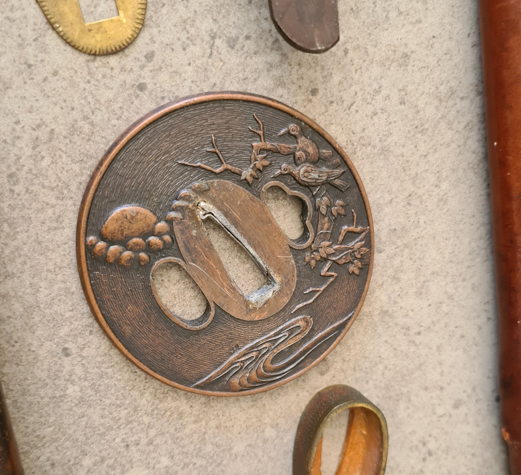

ROKUJURO Posted January 15, 2022 Report Posted January 15, 2022 The TSUBA is a new tourist souvenir item. Quote
Pippo Posted January 15, 2022 Author Report Posted January 15, 2022 Yes, its a new purchase and asked the question about tsuba in the tosogu section as it just didnt seem right, not chinese copy but also not in keeping with the sword. The blade itself is quite straight so thought it might be older but from signature translation is 20th c. Cheers, Pippo 1 Quote
