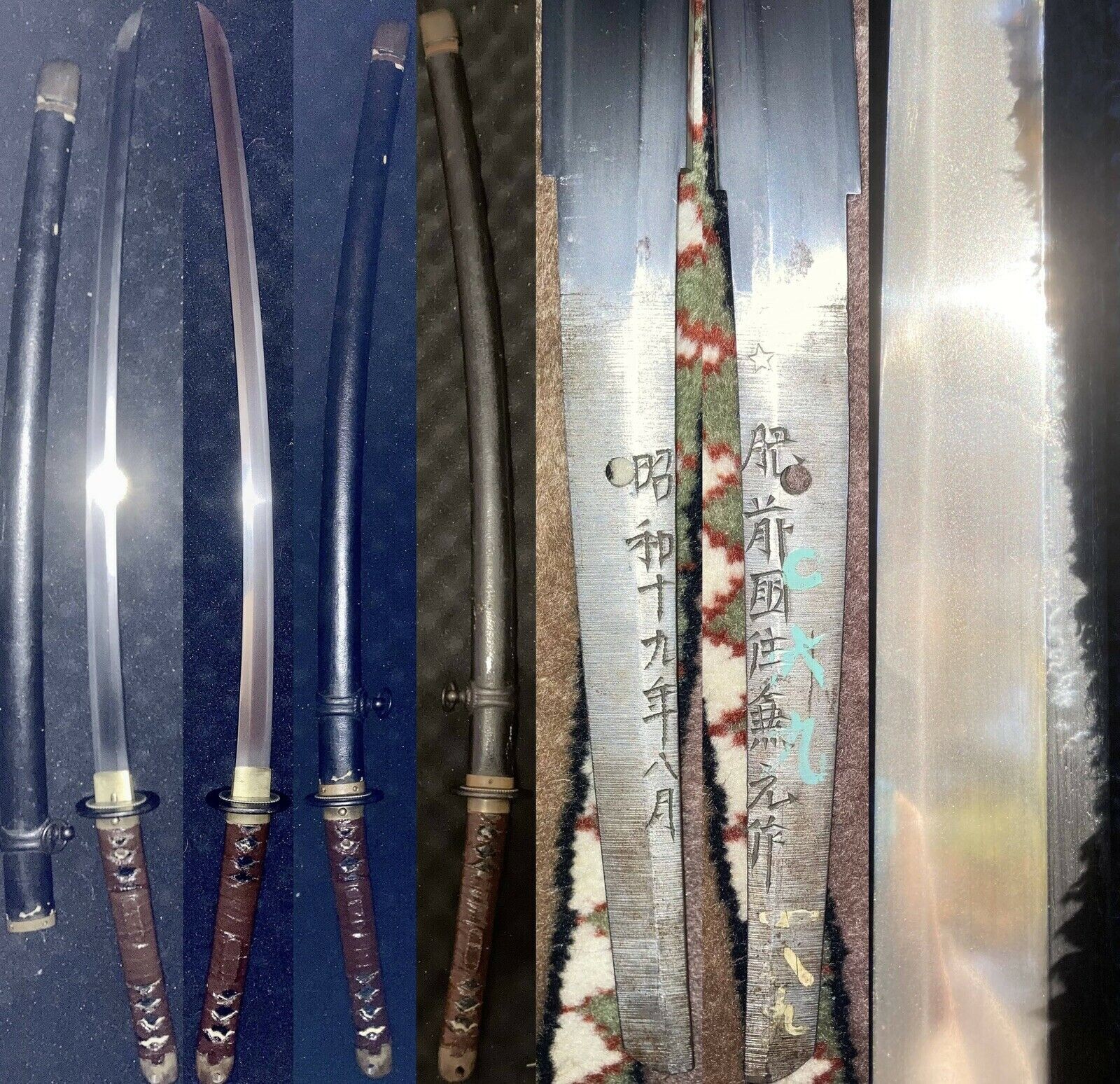

Foo Dog Posted January 14, 2022 Report Posted January 14, 2022 Hello, Need translation for the mei and date on this gendaito. Thank you in advance. Antonio Quote
Ray Singer Posted January 14, 2022 Report Posted January 14, 2022 Hizen no kuni ju Kanemoto saku August 1944 1 Quote
