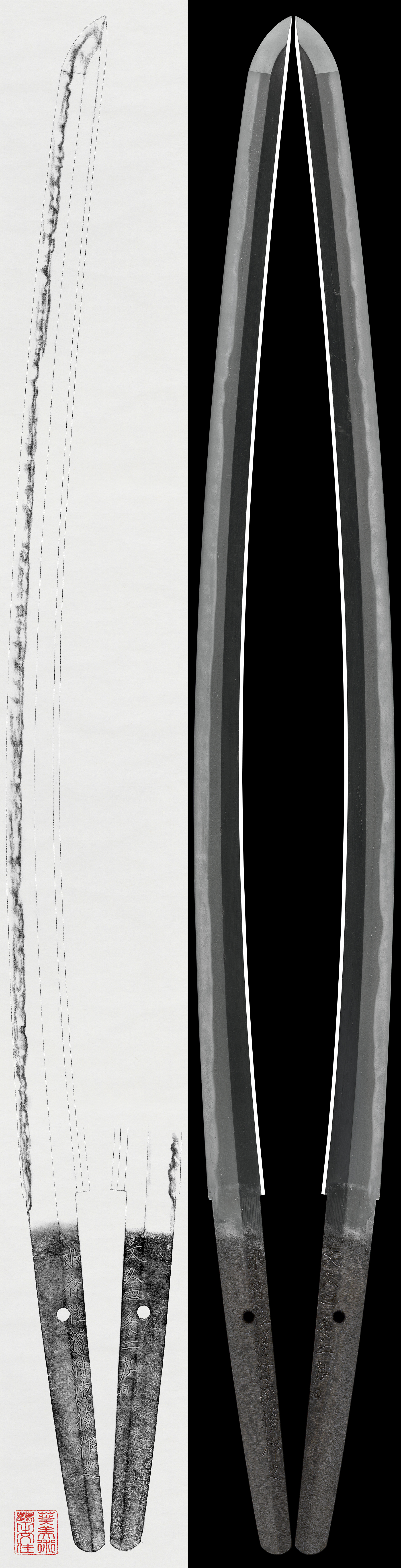

ckaiserca Posted January 21, 2022 Report Posted January 21, 2022 On 1/15/2022 at 10:52 AM, Bruce Pennington said: I just don't see any with ugly, corroded nakago. I guess I'm not seeing any on that site "polished", but I have seen polished nakago. Maybe it's being done by polishers in other countries? Oh, you can certainly find blades with ugly corroded nakago. My latest acquisition speaks for itself: It is from Aoi-Art. NBTHK Hozon attributed as Mino Senjuin (美濃千手院). 1 Quote
