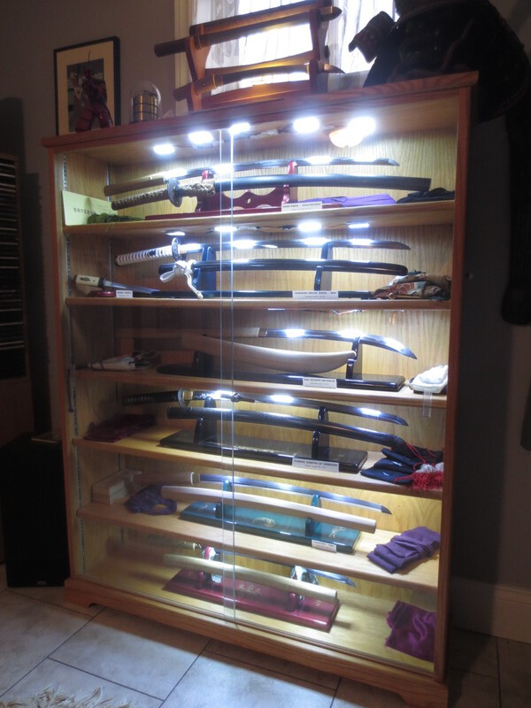

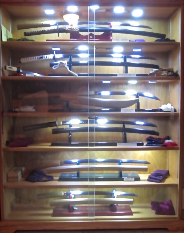

I have displayed my swords for years with a proper coat of oil in this cabinet that has an electric rod often used in gun safes that heats the air slightly and as it circulates in the cabinet it reduces the humidity. Never had any problems with rust and as I like to see my blades on display it has served me well for a long time.
https://www.lockdown.com/products/moisture-control/dehumidifier-rods/golden-rod-dehumidifier-rod/725721.html
Just FYI, there's no mechanism by which heat rods can reduce humidity. As far as humidity is concerned, they only really help prevent condensation.
A real dehumidifier removes water vapour from the air, usually through either condensation or absorption.
The reaction between oxygen, iron and water involves water vapour, so can still happen with a heating rod present.
The barrier layer of oil is providing the protection from corrosion.
Always great to see Brians display.

Brian B I do like your cabinet.

I'm sure with the climate we have in Britain,  that we can use displays similar to Brian's. Including led lights.  Im sure I can find a suitable glass cabinet with lights somewhere 🤔
