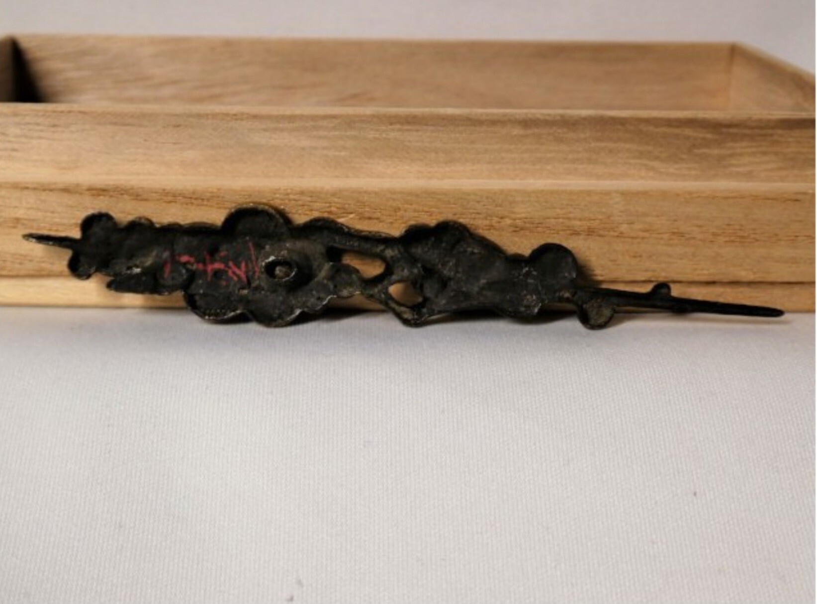

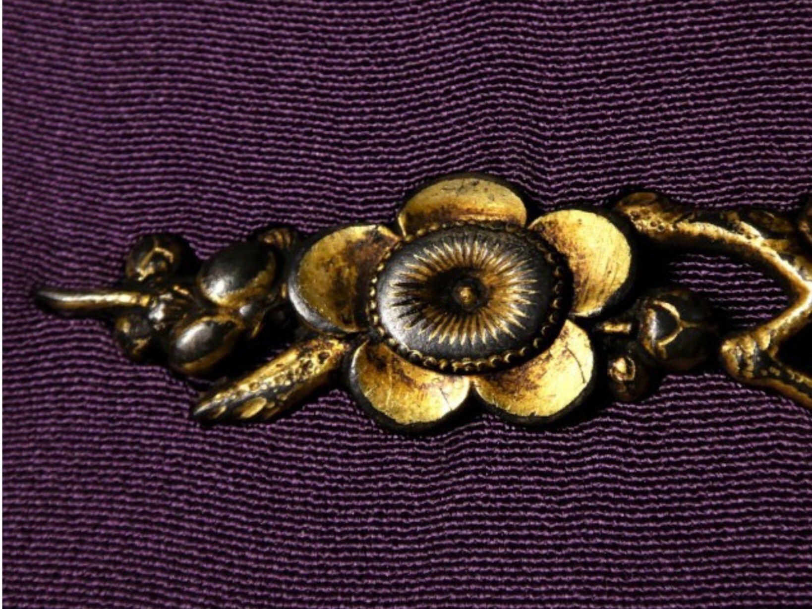

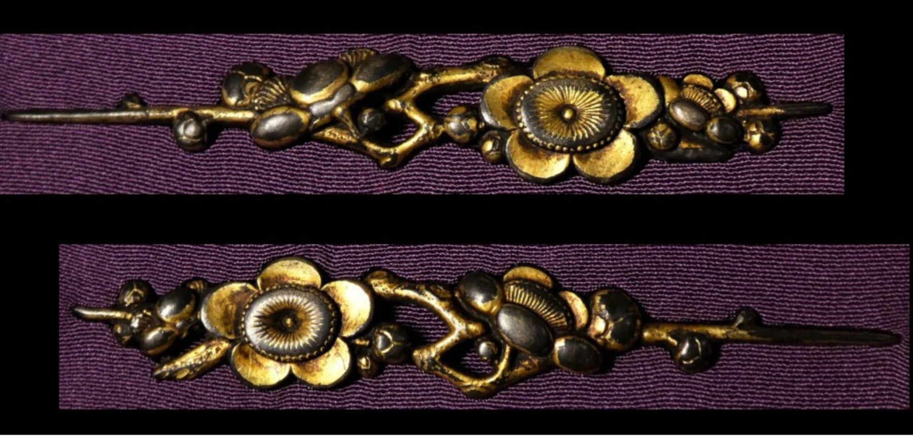

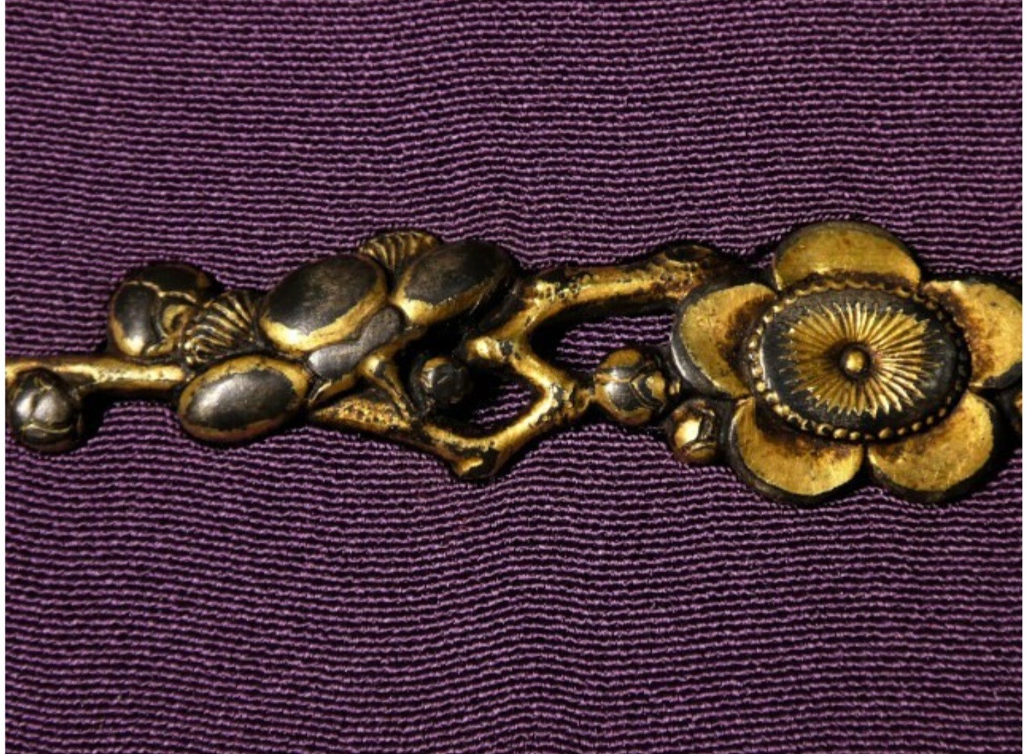

I went in hard to acquire these menuki as I just love them.   They measure a long 9.5cm.  Have a shumei written on the inside which I cannot read.   They are still in Japan and I am just bursting to share them with you.Screenshot_20220105-191737_Chrome.thumb.jpg.7126ce3a0d5bf93fcb820327d8e81f8b.jpgScreenshot_20220105-191737_Chrome.thumb.jpg.7126ce3a0d5bf93fcb820327d8e81f8b.jpg  They have a green paper but I would like to hear opinions from members here.  Mark
  • Like 4
  • Love 1
15 minutes ago, ROKUJURO said:
Mark,
beautiful, but huge! EZO?
When I first saw them Ezo was exactly my thought but the paper says otherwise.   I think these fall into a grey area.🤔   Mark
I think the attribution on the papers is accurate, though ‘Edo-Umetada’ may be more precise. The signature style of the Edo branch of the Umetada was thick gilding in surihagashi [摺り剝がし] (polished to reveal the base metal on the protruding points) which was commonly done on shibuichi to replicate yamagane and create an antique appearance, which can be considered to be reminiscent of ‘Ezo’ tosogu.
Hi Kyle.   No doubt you saw the listing.   Yes the papers say 'UMETADA'.   I do remember reading a comment about Ezo Revival somewhere.   That would explain the size, the base metal and wear to the gilding.  Mark

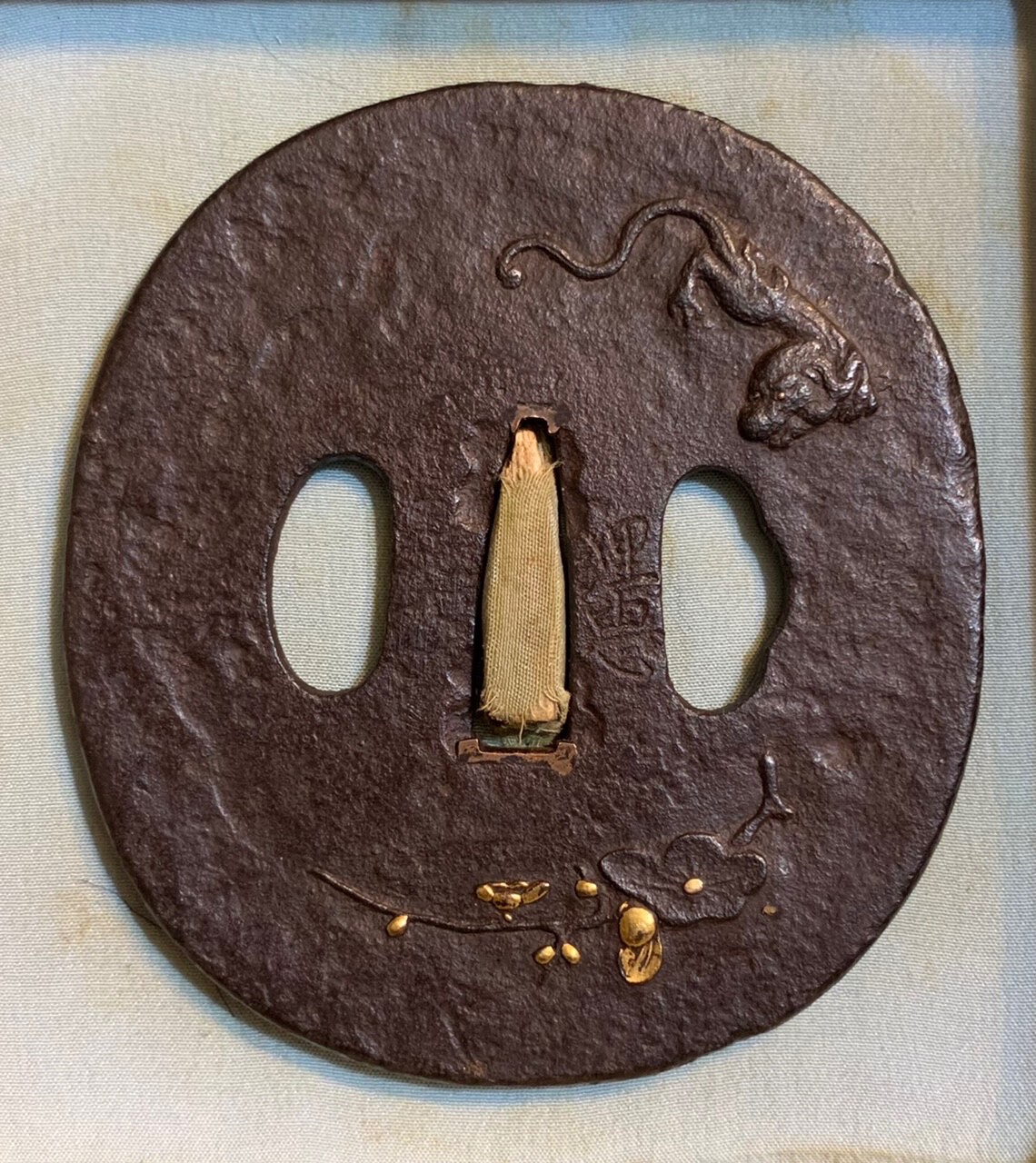

Yes, Mark. I saw them listed online. I’ve attached a good example of an Edo-Umetada tsuba [by Narimasa 就方], which nicely exhibits their surihagashi technique. I had another look at your papers and noticed that the description states that they are made from shakudo. In Sesko’s Toso-Kinko, it notes that the 2nd gen. Narishige [就受], created this style of shibuichi and gilt in surihagashi. I don’t know if Edo-Umetada also worked in shakudo [though I do have a papered suaka Edo-Umetada tsuba], but I recall reading somewhere that early Umetada artists [in Kyoto] also practiced surihagashi, so new papers might actually receive the same attribution.
The papers.  Interesting it seems a low number.  156, not that it means anything.   Kyle I'm surprised to hear they are shakudo,  assumed shibuichi.   But as they say, buy the piece and not the paper.   Contemplating shinsa, potentially achieving nothing but it's out of interest.  Mark  btw  nice tsuba and thanks for the detailed info and reply.
I didn't realize the menuki were that large.  I considered bidding on them myself, but am fighting with myself to save up money for another purchase later this year.
Doc Kyle's writeup is spot-on. My first thought was Ezo, but the longer I look at them the more I agree with Edo revival.   --Still, nice posts on the backside point towards older. Nice set.

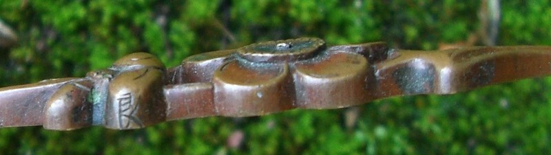

Mark,
as it seems that you cannot receive PMs, I will post this here:

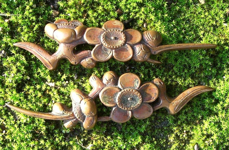

Did you see my set of MENUKI which I showed already a number of years ago? They share the same subject with yours, but are not as long. Other collectors immediately thought they were EZO, but to everybody's amazement they are signed NARA.
They once belonged to the Behrens collection and were sold on auction about 1906, if I remember correctly.
Kind regards,
Jean
5 hours ago, ROKUJURO said:
Mark,

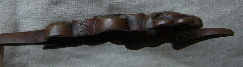

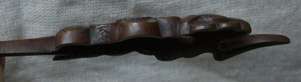

Kind regards,
Jean
Hi, not sure why I couldn't receive your message but nice of you to post your menuki here.  Personally I wouldn't have called ezo on those menuki.   I am just a novice here but what I have been finding out is that the theme of these menuki seem to be used over a broad number of groups and periods.   Do you have a photo of the underneath and have you an opinion as to period of make?  Thanks for taking interest in this thread.
Mark

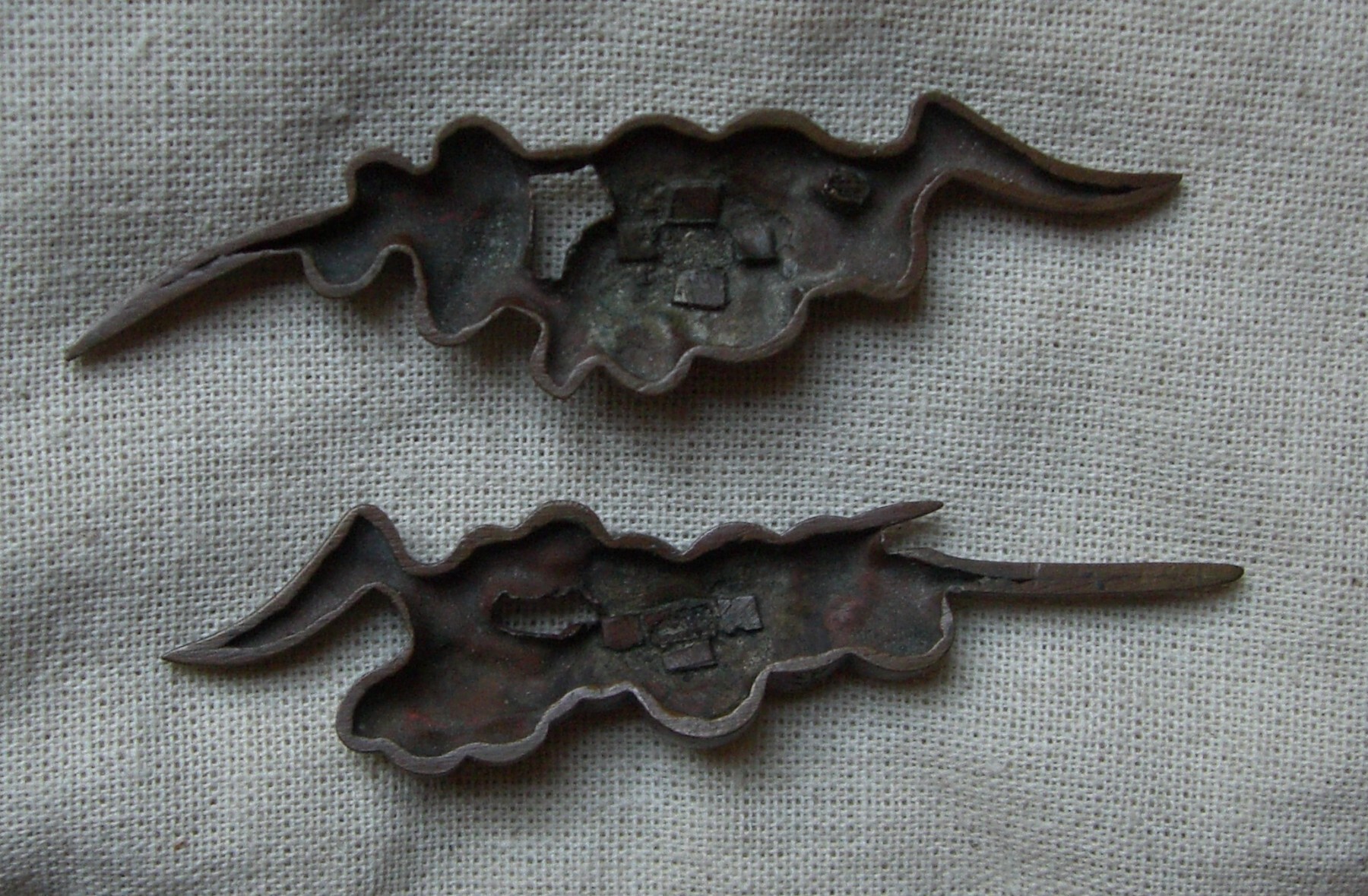

Hi Mark,
I have to confess that I cannot fix the period of manufacture of my MENUKI other than EDO JIDAI, but I don't think they are late EDO. That is just a feeling, not based on factual knowledge.
Hi. I wish I could add some useful info for you but my knowledge is fairly basic.   I would concur with you though that a fair assessment would be early edo, 17th C.  You said they signed, is there a mei on the side?   Thanks again for joining the thread.  Mark

PS Forgot to add sizes to the Umetada rain dragon Tsuba above: 8.2 x 7.6 x 0.4  cm. Tsuchime ji & Tekkotsu.
Very interesting Piers, a nice clarification of the theme.   It seems Umetada were fairly prolific with it.   I don't know for sure but the other tsuba shown by Ian probably fits this school too.   From what I can see it is repeated from muromachi period and seems to be uncommon from the mid edo period.   Also interesting to see those Nara menuki.   I didn't have any experience with that group but searching around it seems they used a fairly highly refined looking copper.   Nice theme, one of my favourites.  Thanks for the input.  Mark
