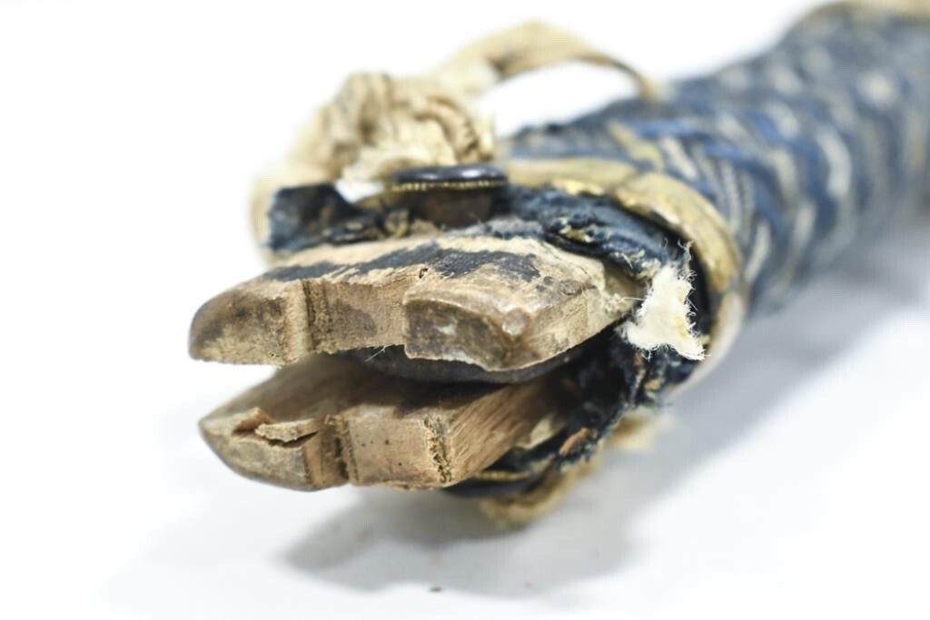

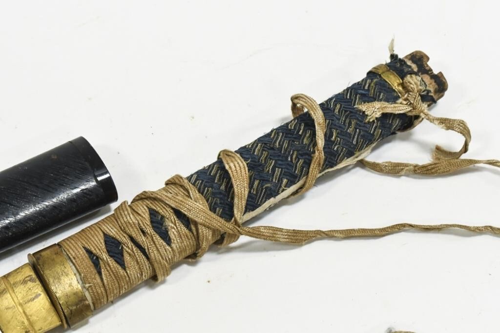

No usual ray skin, looks like another layer of cord. Apologies if there is a term for this; looking to learn more about this and what I'm looking at. Thanks!
I've never seen this before. Doesn't look like a very orthodox wrapping job. I looked around for other examples of this type of wrapping to see if I could find any terminology on it, but couldn't find anything.
David, dont know what the blue ito is, but at kashira looks to be Japanese paper under it.  However, the yellow ito looks like an amateur Western job, as the ito crossovers are all the same way (dont alternate left, right, left etc).  Did this have menuki?
David, I like the oddball as well - sometimes it is like a lucky dip - I think you can find all sorts of replacement pieces for your Koshirae.

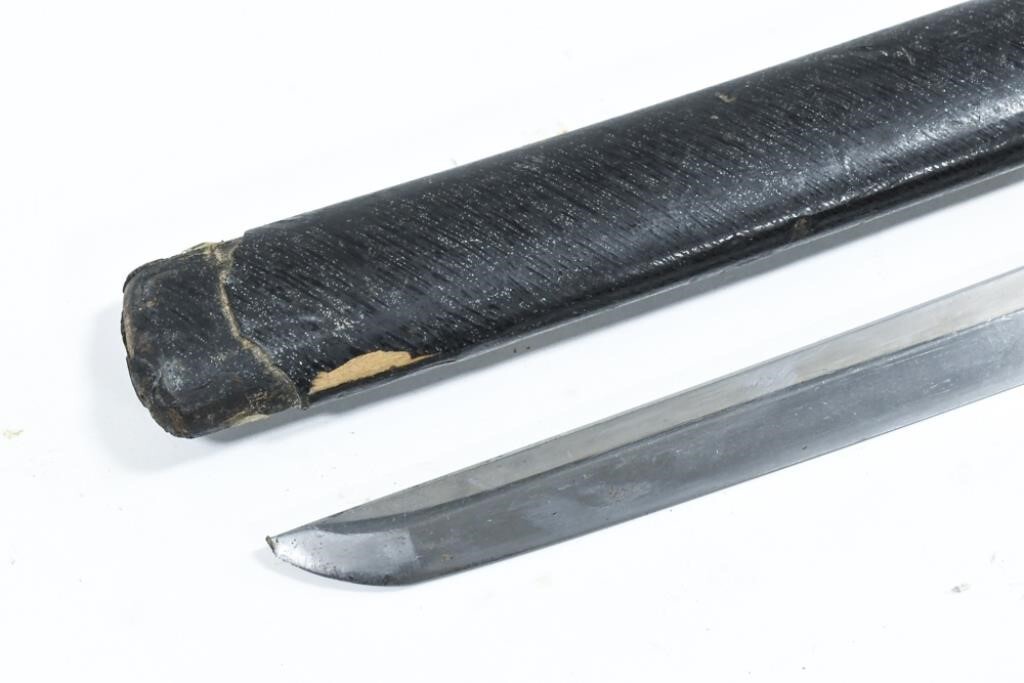

You may need to talk with some of the blade experts but there are options with redefining the Kissaki.  [Ko, or Ikubi ?]
