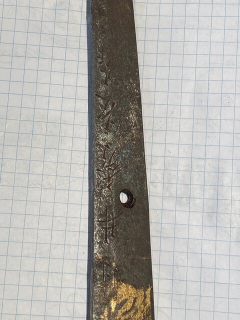

Arty A Posted January 1, 2022 Report Posted January 1, 2022 Would very much appreciate assistance in identifying details about this sword. Not in very good condition by the looks of it. Quote
David Flynn Posted January 1, 2022 Report Posted January 1, 2022 Nakago (Tang) is upside down and hard to read. I think it could be Ido Hidetoshi. Quote

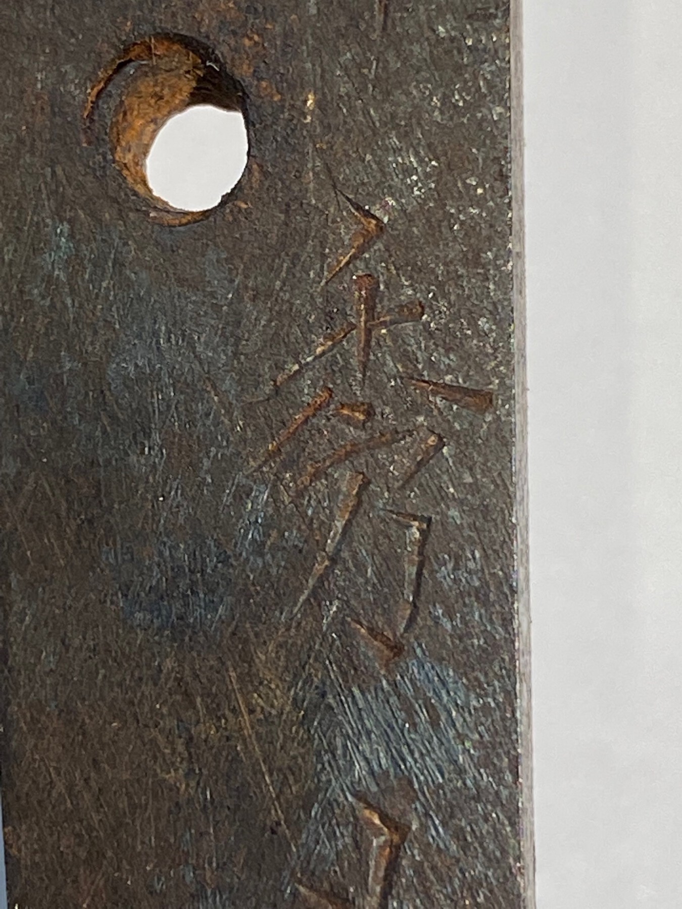

Arty A Posted January 1, 2022 Author Report Posted January 1, 2022 Apologies for bad pic David... here it is character by character... hope its more readable this time. I collect Japanese prints primarily so really don't know much about swords and their value... appreciate your assistance. Quote
Kiipu Posted January 2, 2022 Report Posted January 2, 2022 It is a Type 98 Army officer's sword. The tang is marked as 村井秀次作. I think this is a Seki swordsmith and @mecox should be able to confirm if so. 秀次 = Hidetsugu. Cross-reference to another Hidetsugu sword. 2 swords .need help translating 1 2 Quote
Arty A Posted January 2, 2022 Author Report Posted January 2, 2022 Thank you very much for your reply Quote
mecox Posted January 2, 2022 Report Posted January 2, 2022 Arty, as Kiipu says 村井秀次作 "Murai Hidetsugu saku" family name is Murai and Hidetsugu is given name which he also signs on sword. He was born Taisho 2 (1913) October 23 and registered as a swordsmith in Seki Showa 16 (1941) March 12. He was from Minami, Bugi-gun which appears to be in northern Gifu higher country. Looks to be a basic Showato maker and not to have formally trained as a swordsmith. Not many examples but can find if search NMB. 1 2 Quote
Kiipu Posted January 2, 2022 Report Posted January 2, 2022 Mal, I knew you would have the skinny on this hillbilly swordsmtih! Arthur, I found you another Hidetsugu to look at. Other than these two plus yours, I can find no more. Thanks for sharing pictures of a rather hard to find smith. WWII Guntō - My grandfather received this surrendered Japanese sword while serving in WWII. 2 Quote
