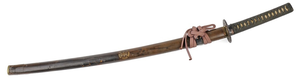

Shuriken Posted December 27, 2021 Report Posted December 27, 2021 Here's a new one to me--a letter presented with the also pictured sword. I'd love to learn what this document and little card at top discusses. Thank you! Quote

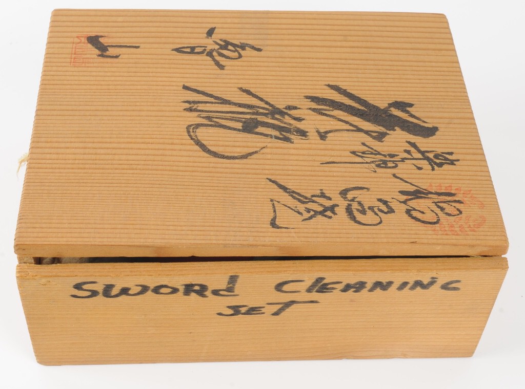

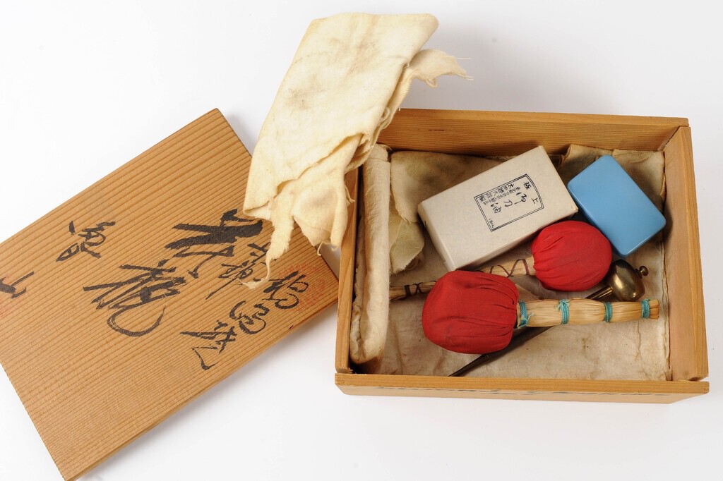

ChrisW Posted December 27, 2021 Report Posted December 27, 2021 Now that's something interesting, sword with presentation papers AND a care kit! Quote
Stephen Posted December 27, 2021 Report Posted December 27, 2021 You can keep the care kit...lol Quote

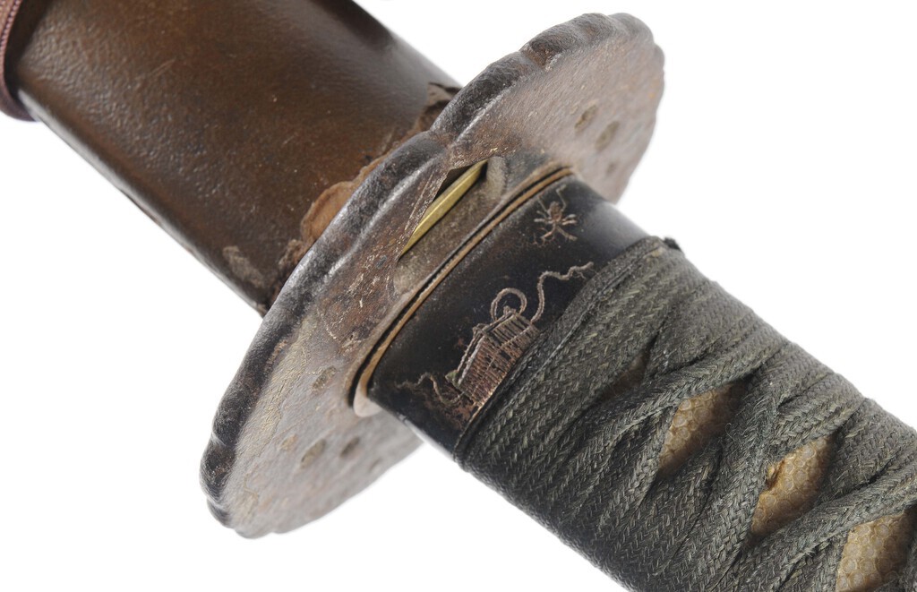

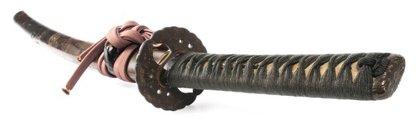

ROKUJURO Posted December 29, 2021 Report Posted December 29, 2021 The HABAKI does not seem to fit that blade. Quote

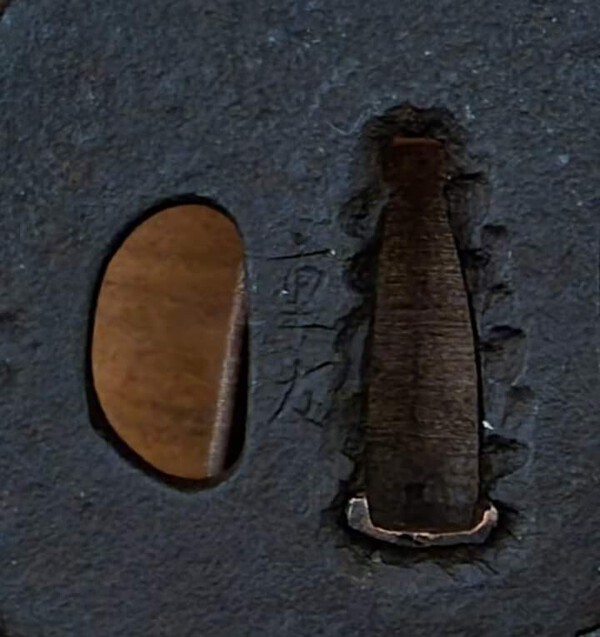

Bugyotsuji Posted December 29, 2021 Report Posted December 29, 2021 I’d like to see the Tsuba in more detail. Quote
Shuriken Posted December 29, 2021 Author Report Posted December 29, 2021 @Bugyotsuji @Stephen What happened here?! 1 Quote
Shuriken Posted December 29, 2021 Author Report Posted December 29, 2021 I'm getting the "chop shop" feel, literally and figuratively. Methinks this soldier was sold a bill of goods... Quote
Stephen Posted December 30, 2021 Report Posted December 30, 2021 On 12/29/2021 at 9:49 PM, Shuriken said: @Bugyotsuji @Stephen What happened here?! Expand In reference to the Ana? Its been fitted many times. They chisel it to make a tight fit. I don't think Chop shop....i see a very old blade. 2 Quote
Shuriken Posted December 31, 2021 Author Report Posted December 31, 2021 I'm amazed that someone would literally hack the iron tsuba like that, and not make any attempt at cleaning up the work. Japanese sword making always seems to have a feeling of artistry to it. Would a smith offer this sword to his daimyo with that workmanship? Quote
Stephen Posted December 31, 2021 Report Posted December 31, 2021 No its not a offer sword....think working class samurai. Quote
Stephen Posted December 31, 2021 Report Posted December 31, 2021 PS look for tsuba on net or for sale. More than a few ...even famous ones...like that. Quote

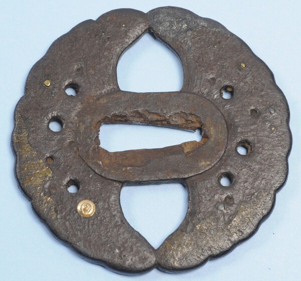

Shuriken Posted December 31, 2021 Author Report Posted December 31, 2021 On 12/31/2021 at 4:51 PM, Stephen said: PS look for tsuba on net or for sale. More than a few ...even famous ones...like that. Expand Thank you for opening my eyes @Stephen which happens here on NMB almost every day. You're absolutely right, of course! And then I found this tsuba on eBay which not only has similar, if not same level of modification, but the overall shape and design is very similar! https://www.ebay.com/itm/324945004066?chn=ps&norover=1&mkevt=1&mkrid=711-117182-37290-0&mkcid=2&itemid=324945004066&targetid=1262749491582&device=c&mktype=&googleloc=9031025&poi=&campaignid=14859008593&mkgroupid=130497710760&rlsatarget=pla-1262749491582&abcId=9300678&merchantid=223125019&gclid=CjwKCAiA8bqOBhANEiwA-sIlN74P1EFv3kaIRvufYtew5VvxSEvD4WgF3r3e2-FjY9KFyKDyWMSwNRoC5kcQAvD_BwE Quote

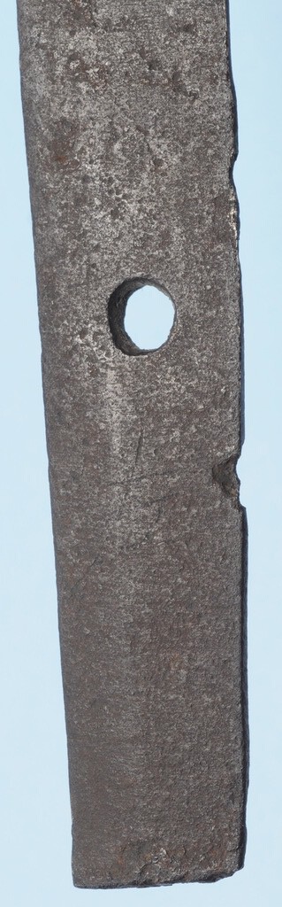

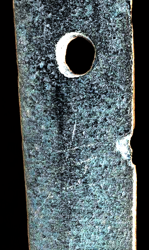

DTM72 Posted December 31, 2021 Report Posted December 31, 2021 On 12/29/2021 at 9:50 PM, Shuriken said: Expand Looks to be the remnants of a signature there. appears to be signed tachi mei. 1 Quote
Stephen Posted December 31, 2021 Report Posted December 31, 2021 100% in agreement Dan .... papers may say not signed but it is. Quote
vajo Posted January 1, 2022 Report Posted January 1, 2022 looks like an old sword. Later than muromachi? nice tsuba btw. Aoi leaves i think. (edit: what shall we do with the dr...) 1 Quote
ROKUJURO Posted January 1, 2022 Report Posted January 1, 2022 When the metal breaks off like this close to the NAKAGO-ANA, this could be an indication that it might be cast. Design is probably ICHO (Ginkgo leaves). Quote

george trotter Posted January 1, 2022 Report Posted January 1, 2022 That kanji below the mekugi ana looks like 'SA'. can't make out the others. 1 Quote

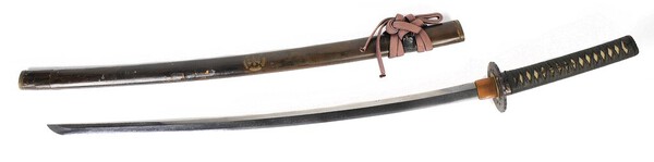

Stephen Posted January 1, 2022 Report Posted January 1, 2022 Let's dig deeper into the sword. How about a shot the other side of the Tang. Some photos of the blade especially the kissaki. The sugata thats the entire blade sans fittings. The nagasa measurements. The tip to munemachi notch. Please dont lay on white cloth the first photo looks like the upper hamon is missing. White is the worst background. You're in Cali so it can't be too cold outside, photos with your sun at your back,it really brings out a lot. Finally any close-ups of any activity such as hada hamon ... Anything that you can photograph Quote

Stephen Posted January 1, 2022 Report Posted January 1, 2022 On 1/1/2022 at 12:52 AM, ROKUJURO said: When the metal breaks off like this close to the NAKAGO-ANA, this could be an indication that it might be cast. Expand Jean are you saying all tsuba chiseled like that are cast? Quote
ROKUJURO Posted January 1, 2022 Report Posted January 1, 2022 Stephen, No, I'm not saying that. But it might be an indication. Looking closely, a TAGANE mark pushes the metal in the direction of the NAKAGO-ANA, where it can be filed to fit the blade exactly. The bottom of these TAGANE marks are usually smooth from the (TAGANE) tip. Sometimes you see clearly that the metal could not be 'moved' as it should have been if it had sufficient ductility. Cast iron usually breaks like a Cookie and cannot be pushed in a certain direction, it rather breaks off. The surface in such a case is usually coarse and not smooth. I have seen copied TSUBA with cast-in TAGANE marks. These look different from totally handmade TSUBA which has to do with the casting process. In older TSUBA which have had a lot of corrosion, the indentations can also be less smooth and look dubious. I don't think that there is a hard and fast rule; one has to see the respective TSUBA in hand and consider the general condition and age to make an assessment. 1 Quote
