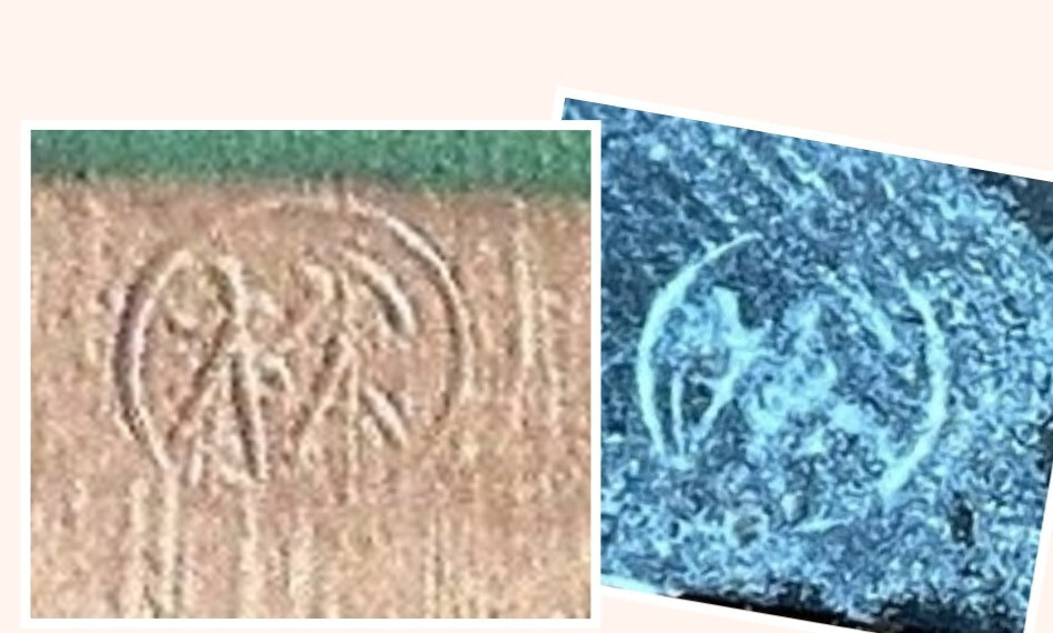

Apollox Posted December 27, 2021 Author Report Posted December 27, 2021 I've taken some more photo's as best I can. There is a round stamp at the top of the tang, which I can not make anything out. I know I shouldn't try to clean it to try an get a clearer image, but is there anything I can do to be able to see what this stamp is (maybe talc powder or something similar) Regards Matt 1 Quote
PNSSHOGUN Posted December 28, 2021 Report Posted December 28, 2021 Hi Andy, yes talc will work. In this case it does appear it wasn't struck particularly well to begin with an the natural oxidization and gunk has obscured it further. A very nice sword and a good family heirloom. Quote
Apollox Posted December 28, 2021 Author Report Posted December 28, 2021 More photos with tac powder Regards Matt Quote
Bruce Pennington Posted December 28, 2021 Report Posted December 28, 2021 So. The plot thickens. I'm fairly certain that is a Matsu stamp: I don't see evidence of a number, although corrosion could have destroyed them. Making this more interesting, if it is a Matsu stamp, is that the majority of Matsu stamps have been found on blades made in the Niigata prefecture. We have 2 recorded from neighboring Nagano, and now this one from either: Aichi, Mino, Dewa province (which back then included Yamagata), Yamagata, or Gifu, which is where the known Kaneyoshi smiths operated from. As you can see, they all neighbor Niigata and Nagano, so I'm starting to think this stamp was an Army stamp used for certain areas, like the katakana stamps we see with numbers. @george trotter - thoughts? 7 1 Quote
george trotter Posted December 28, 2021 Report Posted December 28, 2021 Hi Bruce, thanks for putting this together. I does look to me that this is a Matsu stamp....a mountings shop ID stamp? from that area. I think, from the photos supplied by Matt that this blade has: 1. no star stamp 2. no date 3. one hole 4. is in RS mounts. I think this info and the photos themselves seem to show this is not a war-time made blade, but a pretty straight bladed, short tanged, probably Mino Province shinshinto blade with some age on the tang that has been mounted in RS mounts in WWII. The mounting shop did this private order job and put their shop stamp on the tang. The blade shape etc, and tang file marks, shape and nakago jiri looks to me to likely be one of the Mino Kaneyoshi smiths, possibly of 1781 see Hawley Revised 1981 KAN 3093 p.244. None of my books have an oshi of these smiths or I would post it. (If I am correct) this is probably the first non-gendaito/showato blade we have seen in these mounts. I always thought it likely that one would show up one day....this is it? I'd be interested in members thoughts....don't be shy, if I am wrong, just say so... Regards, 1 1 Quote
Bruce Pennington Posted December 28, 2021 Report Posted December 28, 2021 Well, that’s a twist in the plot I didn’t see coming! Great observations about the older blade in the RS fittings. You may also be swaying me in your direction of the stamp being a shop logo, as military stamps are not found at that end of the nakago. Quote
