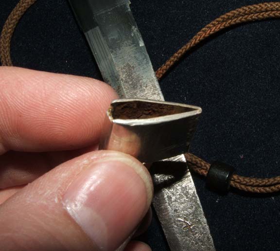

kusunokimasahige Posted March 1, 2009 Report Posted March 1, 2009 Well. I personally judge it by the size of the habaki and nakago. Too small to be of practical wakizashi use. It would be nice if someone could place for instance a package of sigarettes next to it for scale reference. I have once seen three Bunraku swords (early to mid edo period) in a museum display about Japanese culture & theatre in the Netherlands, which also had the magnificent dolls on display. All were forged, all had hamon and all were nihon-to, but well... small, very small nihon-to. substantially smaller than even boys days swords. That is, when looking at the habaki and nakago, and having seen the sizes of the Bunraku dolls and hands, i would still go for that idea... however since Japanese love miniatures of all kinds, this even might have been a smith's special gift to someone... I have been interested in Bunraku since i was 10 years old and my parents let me watch an awesome Bunraku play on television during the Holland Festival, after which i got the book: the Master Puppeteer from them and well even tried making my own puppets.. I still find it the most thrilling and beautiful puppet theatre ever, even better than the marionette stuff Europe had in the 17 and 18th century... KM a great link which also has some nice vids : http://www2.ntj.jac.go.jp/unesco/bunraku/en/ Quote

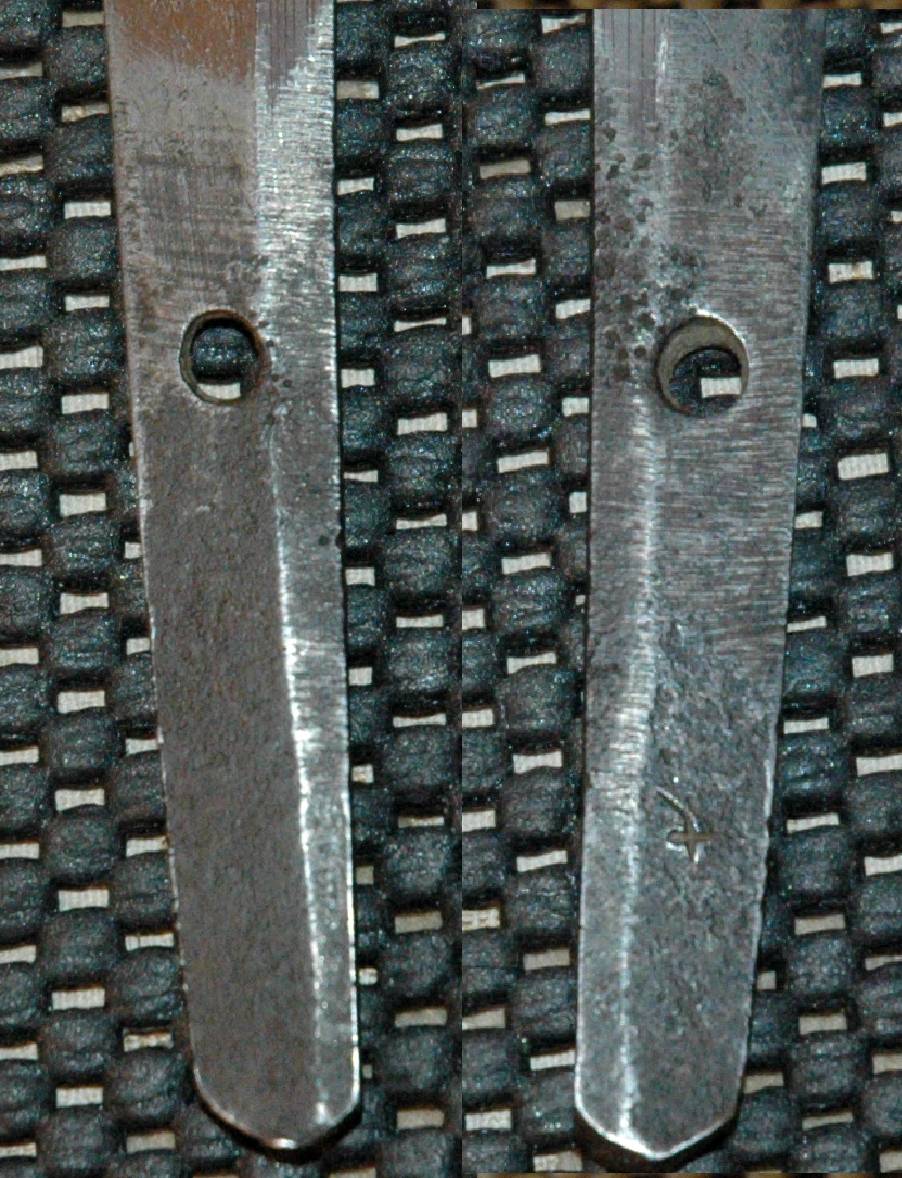

Brian Posted March 1, 2009 Report Posted March 1, 2009 I think it's clear from the scale pics that this isn't a regular wakizashi or tanto. I vote for Boy's Day sword, but could be for Bunraku. You likely won't know which one for sure. The small kanji on the nakago appears to be for "10" but not sure why. A good attempt at the blade inscription might help solve the puzzle. Brian Quote

kusunokimasahige Posted March 18, 2009 Report Posted March 18, 2009 I dont see the Mei anywhere so please post good close up pics of both sides of the nakago. KM Quote
kusunokimasahige Posted March 19, 2009 Report Posted March 19, 2009 Sorry, but that is no mei, it is a quote of some kind.. what is on the nakago? I meant photos of the part which is in the hilt, with the hole in... : download/file.php?id=9934 download/file.php?id=9935 look closely under your hand in the second pic... it shows some kind of chiseled cross indentation... Could you send clear close up pics of both sides of the nakago please ?? KM Quote
