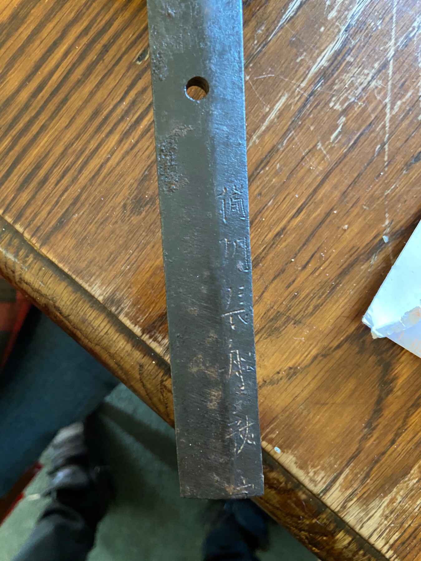

Nicholas Posted December 24, 2021 Report Posted December 24, 2021 Can someone please help me translate. I believe it starts bishu osafune but that’s all I got. Thank you. Quote
uwe Posted December 24, 2021 Report Posted December 24, 2021 If pushed I would go for “永禄十年八..” (August 1567) Hope I’ve found all strokes this time… 2 1 Quote
Bugyotsuji Posted December 24, 2021 Report Posted December 24, 2021 You could... consider 茂実 Shigezane/Morizane? 1 1 Quote
Shugyosha Posted December 24, 2021 Report Posted December 24, 2021 Hi Nick, I've looked long and hard at it and I keep coming back to the obvious one: Sukesada 祐定 I think that the "mouth" part of the right hand radical for Suke isn't clearly done and that the placement of the strokes in the left hand radical makes it look a bit like the halberd 戈 which sent me in the wrong direction. I can't find any kanji with this radical and the left hand one礻which is clearly part of the Suke kanji. Anyhow, that's my logic. 3 1 Quote
uwe Posted December 24, 2021 Report Posted December 24, 2021 丈 For the right side radical makes no sense….Thinking the other way round I could follow John’s reading! Hope somebody can confirm or comes up with a better idea 🤓 1 1 Quote
Nobody Posted December 24, 2021 Report Posted December 24, 2021 When I saw the mei, I thought it was Sukesada (祐定) without doubt. 1 3 Quote
Nicholas Posted December 24, 2021 Author Report Posted December 24, 2021 8 hours ago, uwe said: If pushed I would go for “永禄十年八..” (August 1567) Hope I’ve found all strokes this time… That’s what I was thinking. It’s hard to see but I believe 禄 is the second character. Thanks for your help. Quote
Nicholas Posted December 24, 2021 Author Report Posted December 24, 2021 7 hours ago, Shugyosha said: Hi Nick, I've looked long and hard at it and I keep coming back to the obvious one: Sukesada 祐定 I think that the "mouth" part of the right hand radical for Suke isn't clearly done and that the placement of the strokes in the left hand radical makes it look a bit like the halberd 戈 which sent me in the wrong direction. I can't find any kanji with this radical and the left hand one礻which is clearly part of the Suke kanji. Anyhow, that's my logic. I agree. Suke was my guess because it was the closest I could find. But I’m far from good at translating kanji, let alone kanji with 500 years of rust build up. Thank you for your help. 1 Quote
Peter Bleed Posted December 25, 2021 Report Posted December 25, 2021 If the rest of this sword at all fits with what were were shown, this should be an obvious Bizen product. Ho-hum.... It might be rather good "of type", but I bet it is just a late koto Bizento.... P Quote
