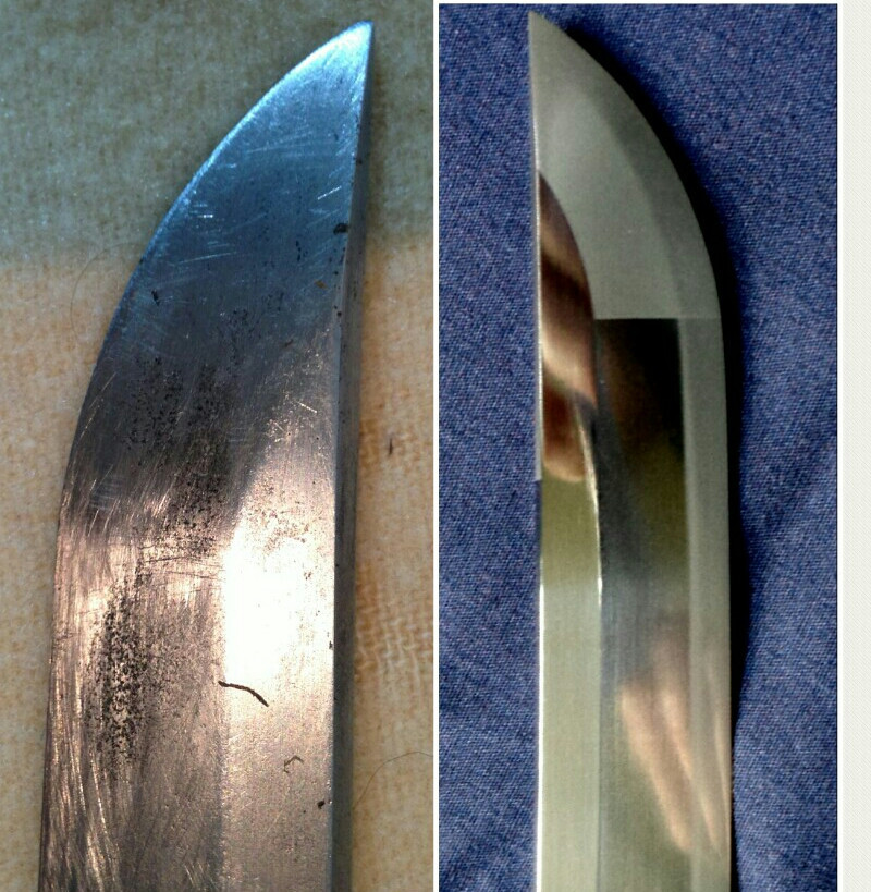

Bruce Pennington Posted December 27, 2021 Report Posted December 27, 2021 My blade was in similar condition. It was my dad's, so I decided to have it polished. They come out quite beautiful, but it costs more than $2,000 to have it done. 1 Quote
