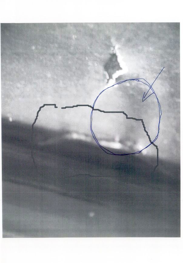

I have seen a small Flaw on the top of the boshi/mune, maybe 12 mm behind the point:
http://www.kvarnberg.se/ShuShinKan/KMKa ... wOnTip.jpg
I have seen another flaw in the bohi: When I get it right it is a shinogi ware :
http://www.kvarnberg.se/ShuShinKan/KMKa ... w_bohi.jpg
Additionally there is a bigger flaw: (big means max 3mm)
http://www.kvarnberg.se/ShuShinKan/KMKa ... wBlade.jpg
Could you please tell me if one of them counts as a fatal flaw?
None of them is in the hamon or borders with it. Anyhow, they are too deep to be erased with a polish.
I have read that flaws are quite normal and I am aware that the sword is not a masterpiece, compared with other masters work.

It is not flows but Artic crevices (taken through magnifying lens) :D . It is called Fukure. Carbon air pocket which opened upon for example in the polishing process.
Very interesting pictures. I felt like I was looking at pictures of Jupiter or something. :shock: Anyhow, because they focus on such small areas they lose context. Nothing looks fatal from what I can see though. John

Yeah..looks like a fukure that opened up a bit on one side.
However these ultra-magnified shots don't work for me...we can't see them as they are normally seen when the pics are through an electron microscope :badgrin:
Either way, look like normal flaws to me, nothing fatal unless they are in the hamon. Just part of the norm in blades that aren't perfect. Fukure are ugly though..especially when they open up.

Just to be brief, what is fatal flaw : it is a flaw which puts in danger the very existence of the blade, meaning by this, a flaw which could lead to the breaking of the blade, or of a part of it. They concern the hamon.
Kitae ware, fukure, bent ... don't affect a blade viability but its artistic value
Are you really sure Jacques about kitae ware and fukure being fatal
I wrote
They (fatal flaws) concern the hamon
I have never seen a fukure in the hamon, perhaps have you some example to show us
Concerning kitae ware and yaki ire - I am quoting Usagiya website :
Open layer (kitae-ware, in Japanese)
This kind of flaw is the easiest to be found.
It is not good for its visibility. But in most cases, it is not so serious as it looks like.
It is only a trouble for eyes.
A small flaw from fold welding work does not make the quality of the steel down.
No kitae-ware does not mean good steel.
We have to see the colour and brightness of the steel (in other words, the condition of the steel particles) to know its quality.
Sometimes, a thin open layer becomes a blister (fukure in Japanese). Unfortunately it looks so bad for eye. It is a pitiful flaw.
Tempering cracks (yaki-ware)
This kind of flaw is most terrible. Some of them are really bad.
It is a little difficult to be found. It is thinner than a hair line, but sharp and deep.
This crack appears in the hamon area by a mistake in tempering work.
It has some different types. (Do not confuse an open layer in the hamon area to a tempering crack.)
and here is a link to Dr Stein website :
http://home.earthlink.net/~steinrl/kizu.htm
It seems that :
Neither of them have seen a fukure in the hamon (they must have seen/held some blades in their Nihonto life.)
Kitae ware though unpleasant to the eyes seem not fatal as some yaki ire.
But it is a very good remark Jacques and I woul like Ted/Guido/Eric/Reinhard to tell us if they have ever seen a fukure in the hamon
Not really common, but fukure can occur in the yakiba. I have one here in the shop, but I wouldn't call it fatal eventhough it's in the yakiba because the surrounding steel has a great deal of mass around it to support it.
We have to be careful not to confuse what is fatal from an art value standpoint, versus a weapon standpoint. While the sword I have here has limited value as collectable art, it is still a fully functioning and dependable weapon. All fukure are not created equal. The magnitude and location of any flaw determine the level of concern. Saiha blades are technically fatal flaws (at least from the art collector's view), but so many are out there and can be regarded as still functioning weapons.
