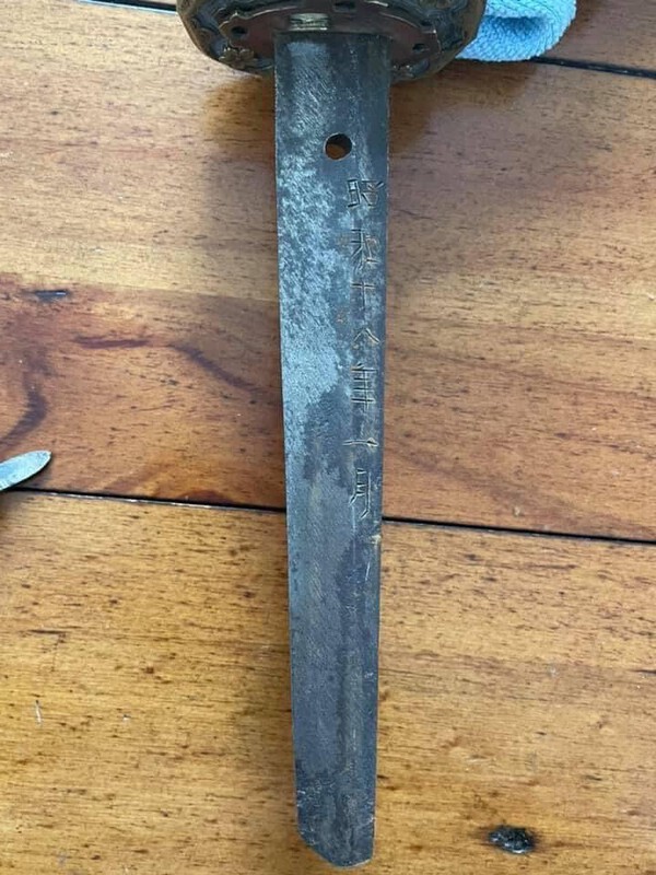

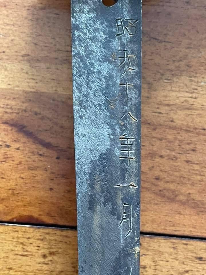

Can anyone could help me out with this sword. Any information would be most welcome, I have not seen a number stamped nakago before but I’m no expert.
regards29BAE2E7-9AC2-4E10-8FFC-62AF38030F3C.thumb.jpeg.e9cd76c67ac6f03479b044d80ec3129b.jpegFE87F00A-BBAD-4EDD-A0B6-F6E8FDC9D10F.thumb.jpeg.b67d102170c1c9e320d27c56e85c46f9.jpegD5A9FCD8-6030-4B7E-8173-9F3133A80DF1.thumb.jpeg.74f3b0a04d5605809d134e509d803420.jpeg
Hi Dave   ,
you have supplied the date , which is dated Showa 1943 , the numbers are generally accepted as factory assembly numbers for matching up the sword fittings .

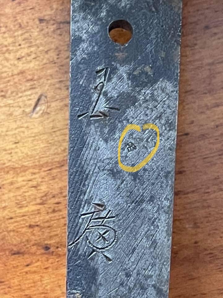

Is there a star at the top? Or other stamps?
This is the last photo I have and don’t see anything… sorry
So, it seems this Type 98 is credited to Seki smith "Kunihiro" in 1943. And this would be considered Showato (non-traditional blade, oil-tempered) as is common with guntos, correct?
Japaneseswordindex shows 3 Kunihiro mei and one of them is this one:
http://japaneseswordindex.com/oshigata/kunihir2.jpg
Nihontoclub shows 2 kunihiro, one from Fukuoka, the other from Aomori, both using the scquare kanji for Kunihiro 國廣.
Kataoka Kunihiro was RJT qualified, which is why I was wondering about a possible star stamp, but his mei looked like this:
http://japaneseswordindex.com/oshigata/kunihiro.jpg
I saw that small mark too, but don't know what to think about it.  It could be a poorly struck Seki or Nagoya mark, but neither would necessarily mean the blade is showato, as they both show up in small form on star-stamped blades.

Thanks SteveM and BangBangSan for the bailout.  I just do not like this smith's penmanship.  He must have been one of those former blacksmiths!  And congrats to Detective Bruce for tracking him down and verifying such a smith existed.
