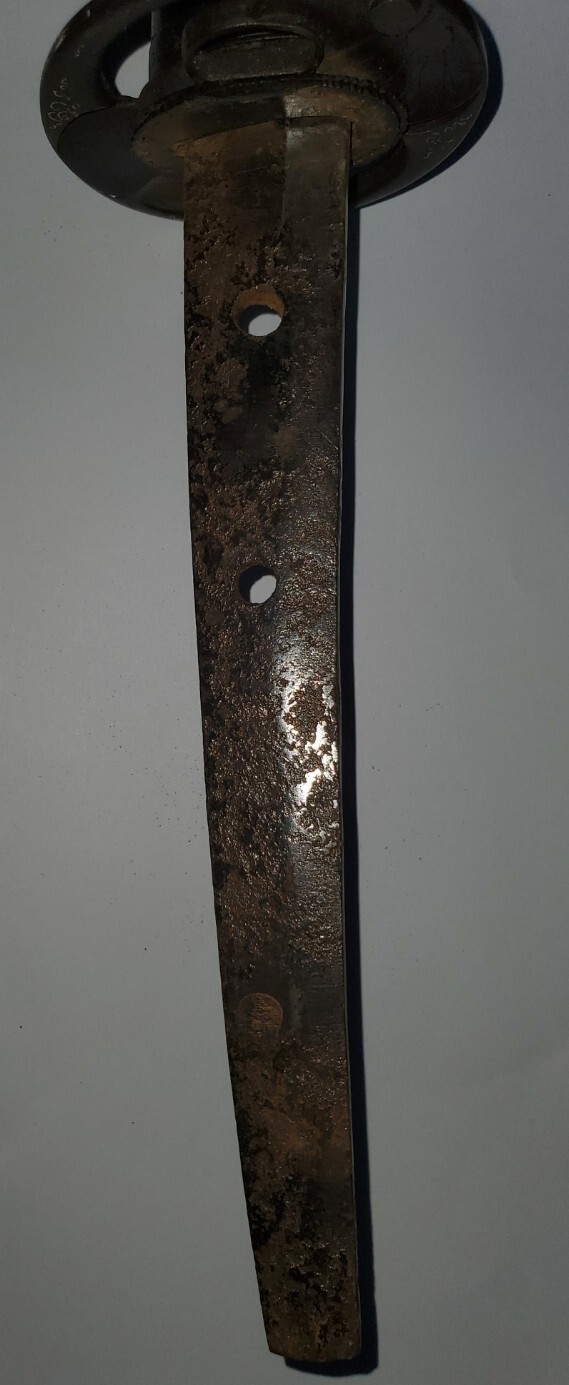

Here is the bare blade. Tip appears to be missing which is a shame.
It is magnetic (steel?), and does appear quite old. I've only worn gloves while touching it as I read horror stories or finger print rust spots.
Tang is a nice dark color, but I do not see a signature anywhere. Got plenty of pics if you want more!
Wish it were in better shape! But it has not enjoyed bring in an attic for 15+ years!
I supose its an old blade because you have 2 holes for the bambo wood lock so we can presume that the blade where mounted 2 times with different handles during time
I suggest you to go see somebody that can evaluate properly the sword
My 2 cents
Eric.

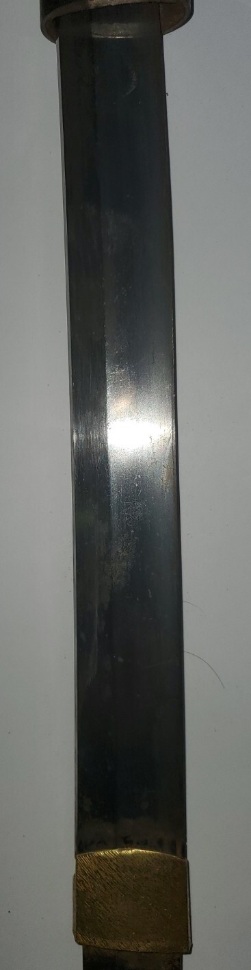

The tip (kissaki) appears to be mostly intact and as stated, the blade appears to be older. Could we get some close ups of the nakago, kissaki, and any activity in the steel you might be able to see? (such as hamon, hada)
Please see attached! Do these help any? Have higher quality, but too large to upload.

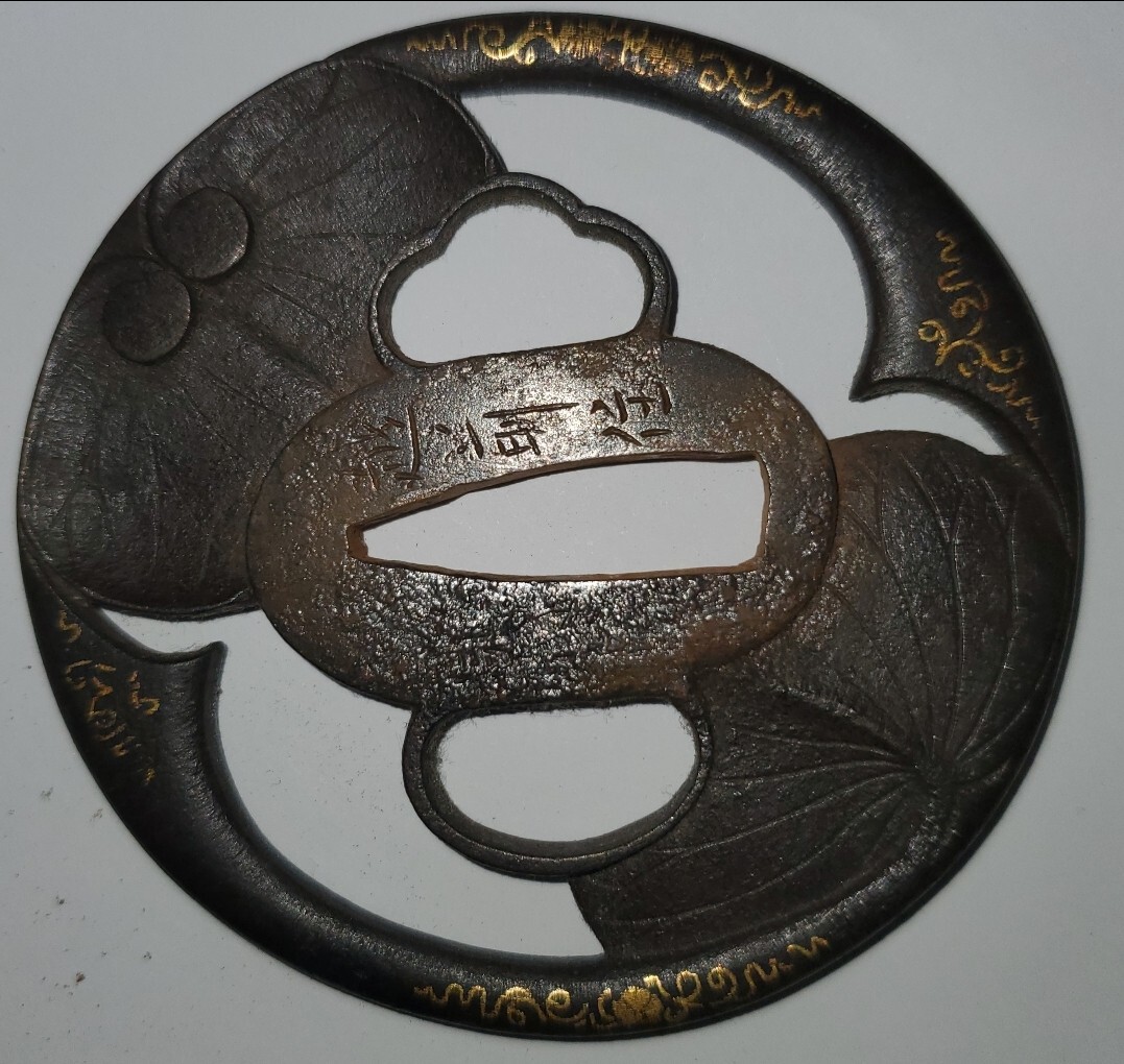

Did notice characters...maybe signature?

The very tip of the kissaki is indeed snapped off, however it is most assuredly not fatal and a good togishi can easily rectify it. The blade appears to be older than WWII by virtue of the patination of the nakago and the fact that there are two mekugi-ana. The tsuba is also quite nice but I am unable to read kanji so you'll have to wait on a translation from someone else.
