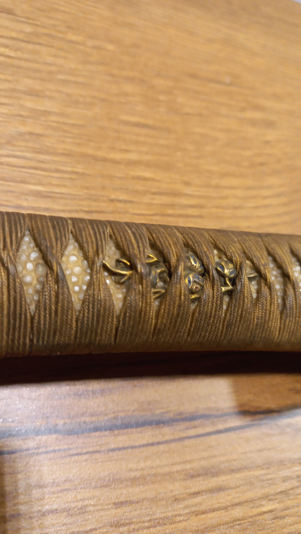

Kurikata Posted December 15, 2021 Report Posted December 15, 2021 Hi, Difficult to see them clearly behind the tsuka ito but could these menuki be from Ezo school? Thank you Quote
Bazza Posted December 17, 2021 Report Posted December 17, 2021 I don't think so as they don't have the requisite degree of 'silver' colour in the alloy... BaZZa. 1 Quote
Kurikata Posted December 17, 2021 Author Report Posted December 17, 2021 Bazza just to confirm after a close look, that they are fully coper but their design make me think they might be from muromachi erea. Thank you for your interest. Quote

ROKUJURO Posted December 18, 2021 Report Posted December 18, 2021 15 hours ago, Kurikata said: .....they are fully copper ...... Bruno, on my screen the colour of the MENUKI is more like brass, not copper. Generally, I think it is difficult to judge MENUKI when they are hidden under the TSUKA-ITO. In your case I think I see hints that they might not be traditionally made, but the photos are not too good, and - as said above - an assessment is difficult. Probably better photos (or betters eyes than mine) will prove that I am wrong. Quote
Kurikata Posted December 18, 2021 Author Report Posted December 18, 2021 Thank you @BazzaBazza for these very fine exemples. @ROKUJURO Jean you are perfectly right, it is more brass than copper and yes my pictures are very bad and you have eagle eyes. A Last attempt With a (i hope) better picture. Quote
Iekatsu Posted December 18, 2021 Report Posted December 18, 2021 I agree with the others, not Ezo. The motif is Japanese peppercorns, its common in mino work. 1 Quote
Kurikata Posted December 19, 2021 Author Report Posted December 19, 2021 Thank you @IekatsuThomas to have given an information i didn't have. 1 Quote
