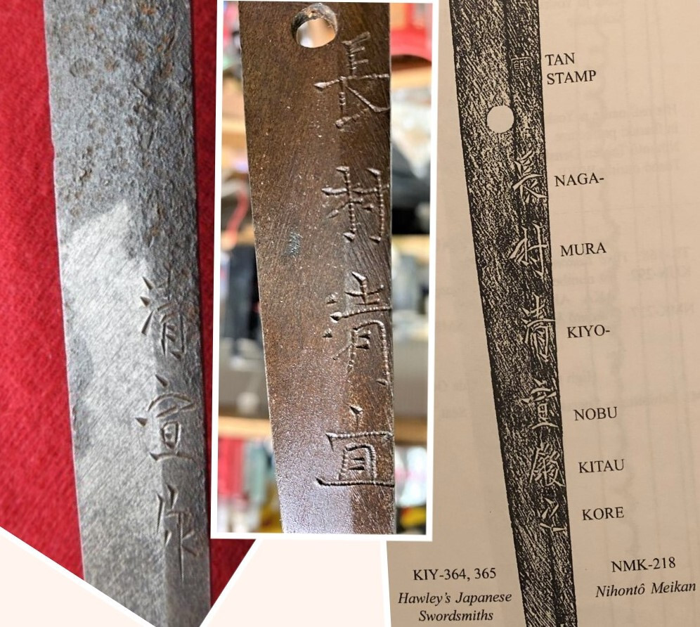

So, here are the 3 for comparison.  All 3 are different.  As we know, the reason could be because 3 different people - the smith, an apprentice, a mei-signer (always forget the word for that!) - could have done the 3.  Or, as we know, during WWII sometimes there were multiple smiths going by the same art name.

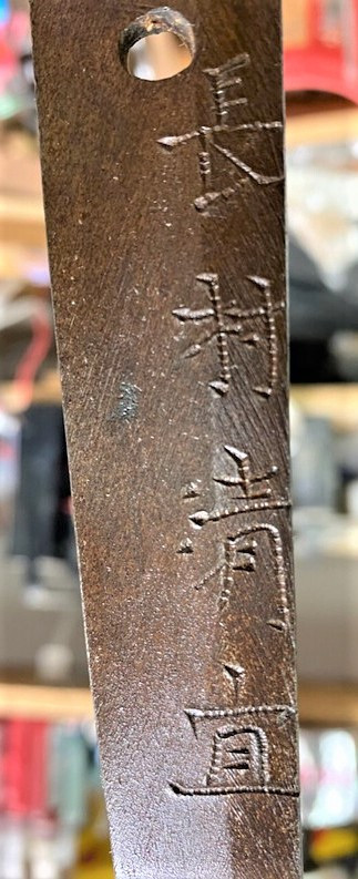

Sorry to take so long to get back to you on the measurement of the Seiki stamp.  Thought i had checked the "notify me on replies to this topic"-nope!
Attached are some pics of the stamp/scale.  I also measured it with calipers and it is about 4mm sq.
The boundary on one side is kind of vague, but that is my best measurement w/ the naked eye.

Thanks Dennis!  So it's the small Seki stamp of the Nagoya Army Arsenal inspectors.  That puts this blade in the 1943-45 timeframe.
A nice showato like yours, with intact leather cover, is in the range of $1,000-2,000 USD.
I'm assuming there's nothing on the other side of the nakago, where a date would be?

Correct, when i took the handle off to get the stamp pics i checked the other side and 'nothing'.
