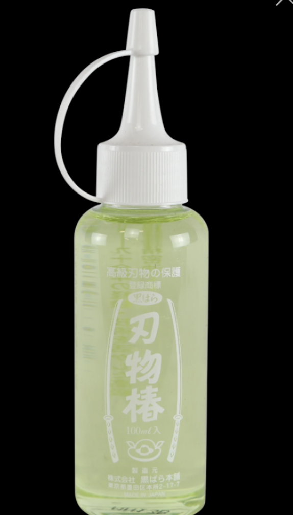

Yoshihiro TSOIL 100% Pure Tsubaki Japanese Knife Maintenance Oil With Complimentary Sabitori Rust Eraser, 3.4 oz, Large, Golden Yellow https://www.amazon.com/dp/B00AZ6SYSY/ref=cm_sw_r_apan_glt_fabc_ZDTTCNSJ5K1X6WMRAWSA
DO NOT be tempted with the rust eraser (maybe on your kitchen knife)
Comes with your own microfiber or you can get the bottle by itself for $9.99

Appreciate that. I ordered it already.
