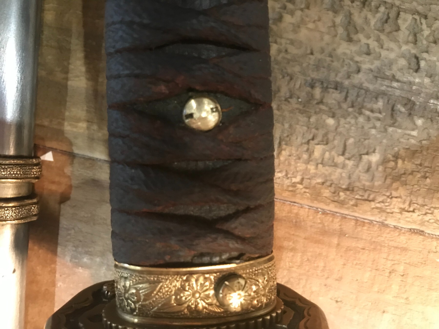

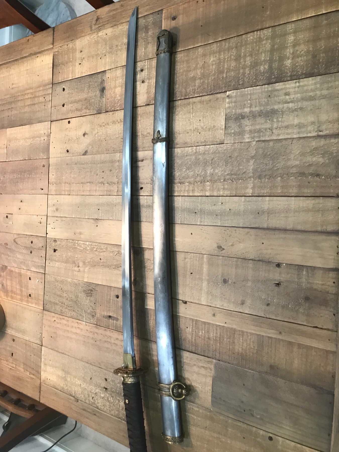

I am new to the Forum and Shin-Gunto , I came across this sword in an online auction and bought it on an impulse buy as I have always loved history
It a real Shin-Gunto ? hoping its not a fake or put together !!

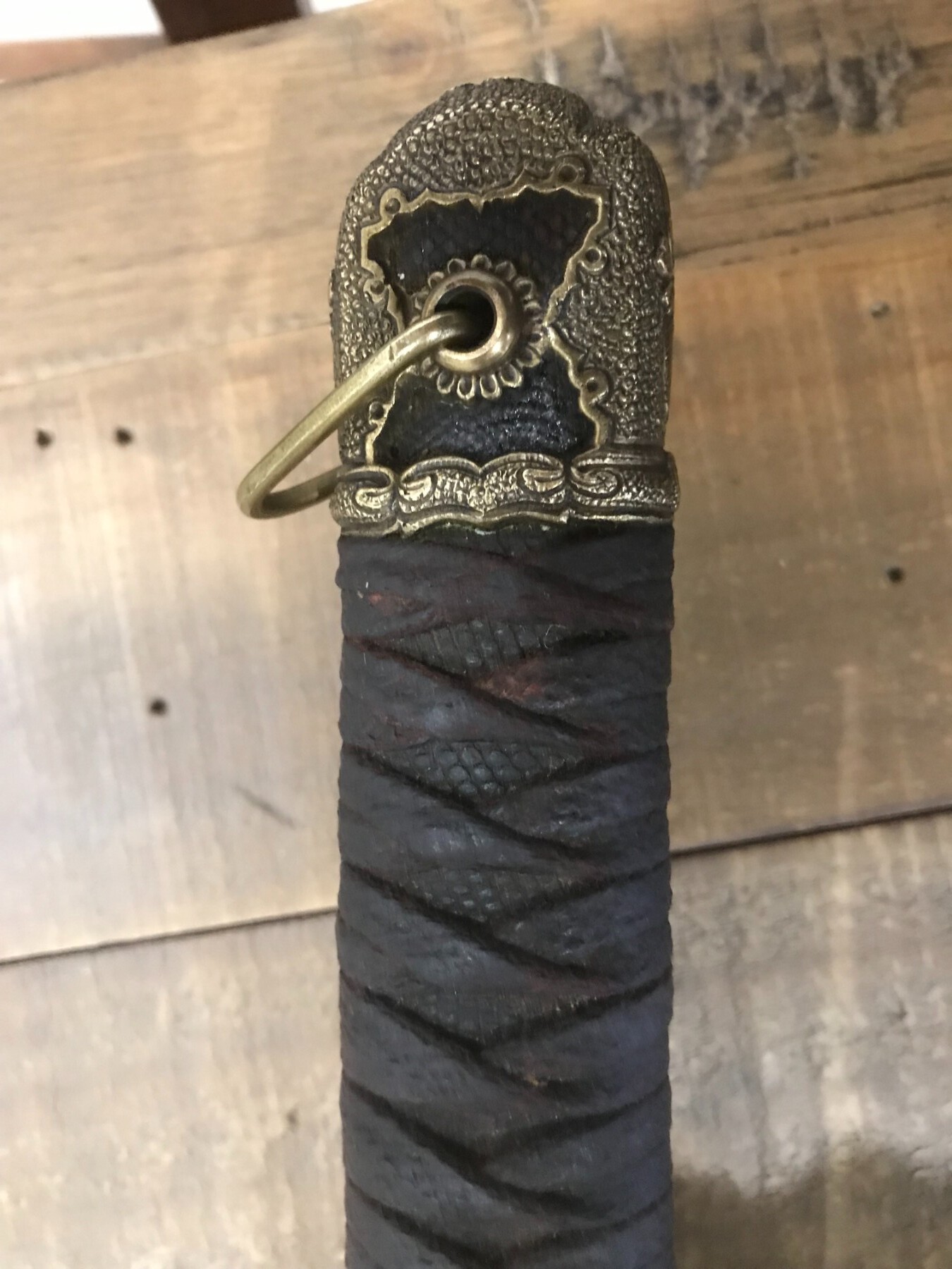

 I have been looking through your Forum and there are some strange things about it ,  the fittings are Army but the wrap (Ray ?)is Black like they seem to do on some Navy swords , and I think the blade must be Stainless-steel , which I guess would also be a Navy thing to stop them from rusting
It’s a shame about the state of the scabbard it has lost all pain /leather , and the blade is not very Sharpe it does look like the edge is bevelled (I have a practical plus Katana and the edge looks very different)  is there anything I can do safely to sharpen a little ?

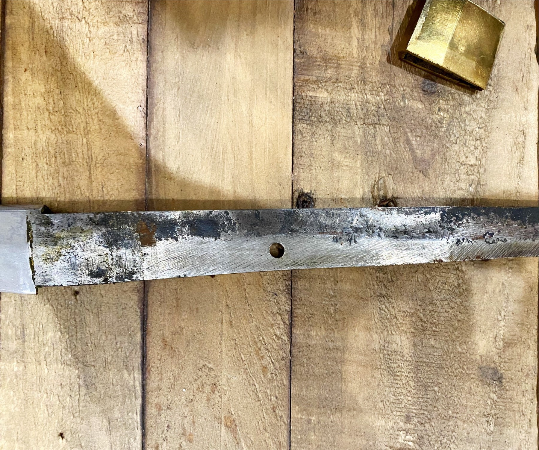

also would like to take it apart but it has a screw in  pin and then end on one side is blocked (see pic) i assume i need a special tool to undo it ?

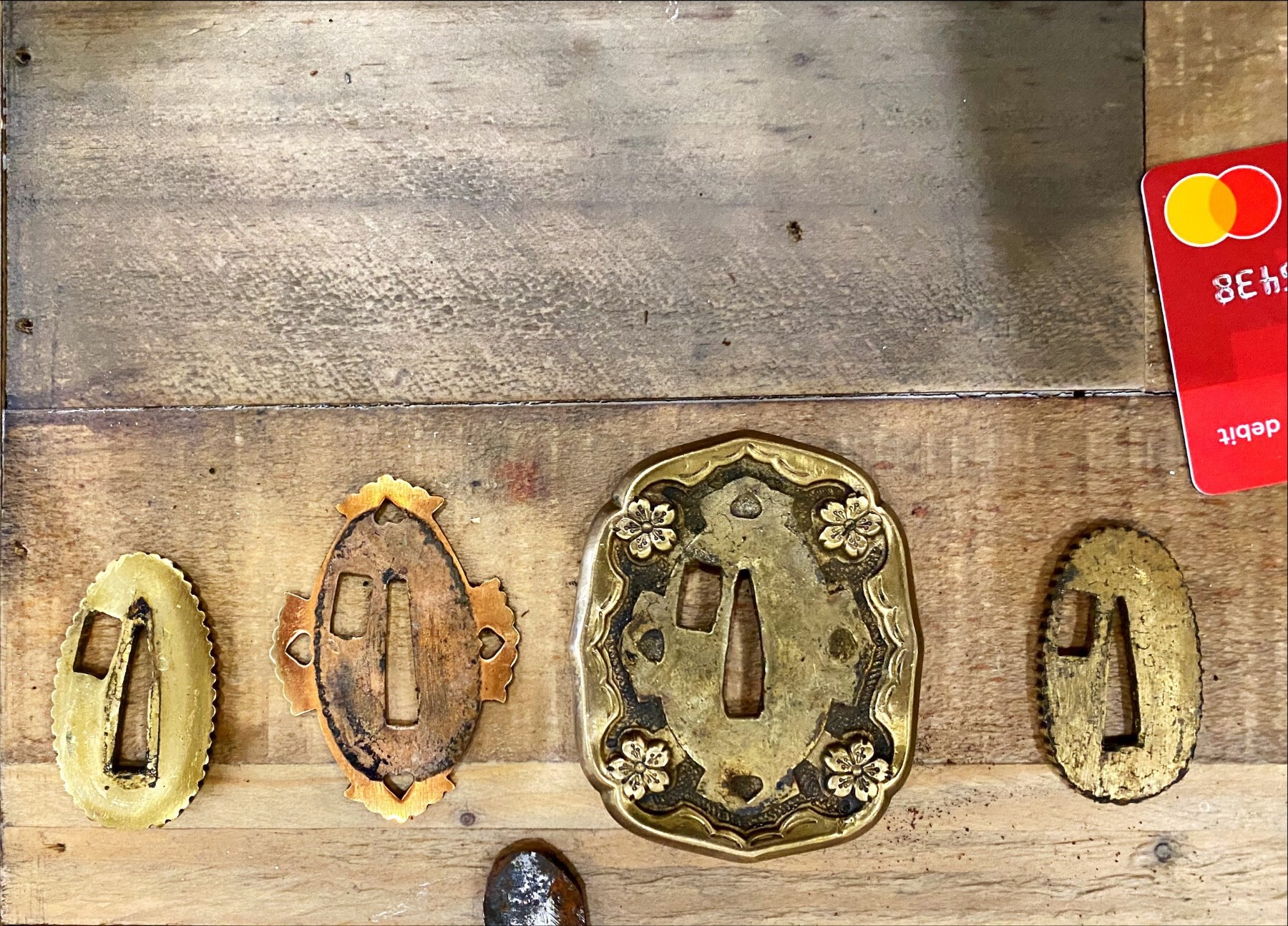

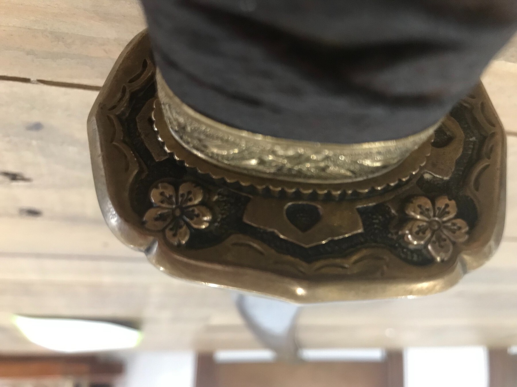

thanks for your reply , very sad to hear that !  it was listed as genuine WW2 era  sword could you give me more details as to why  (see pics for fittings detail )

There is actually nothing there that looks genuine. To someone with no experience yes, but to anyone who had owned one for a while...nope.
The wrap is bad, completely wrong and so is the underlying material. The fittings are poorly cast, and would never be on a genuine one. They are in the correct style yes...but are still way off.

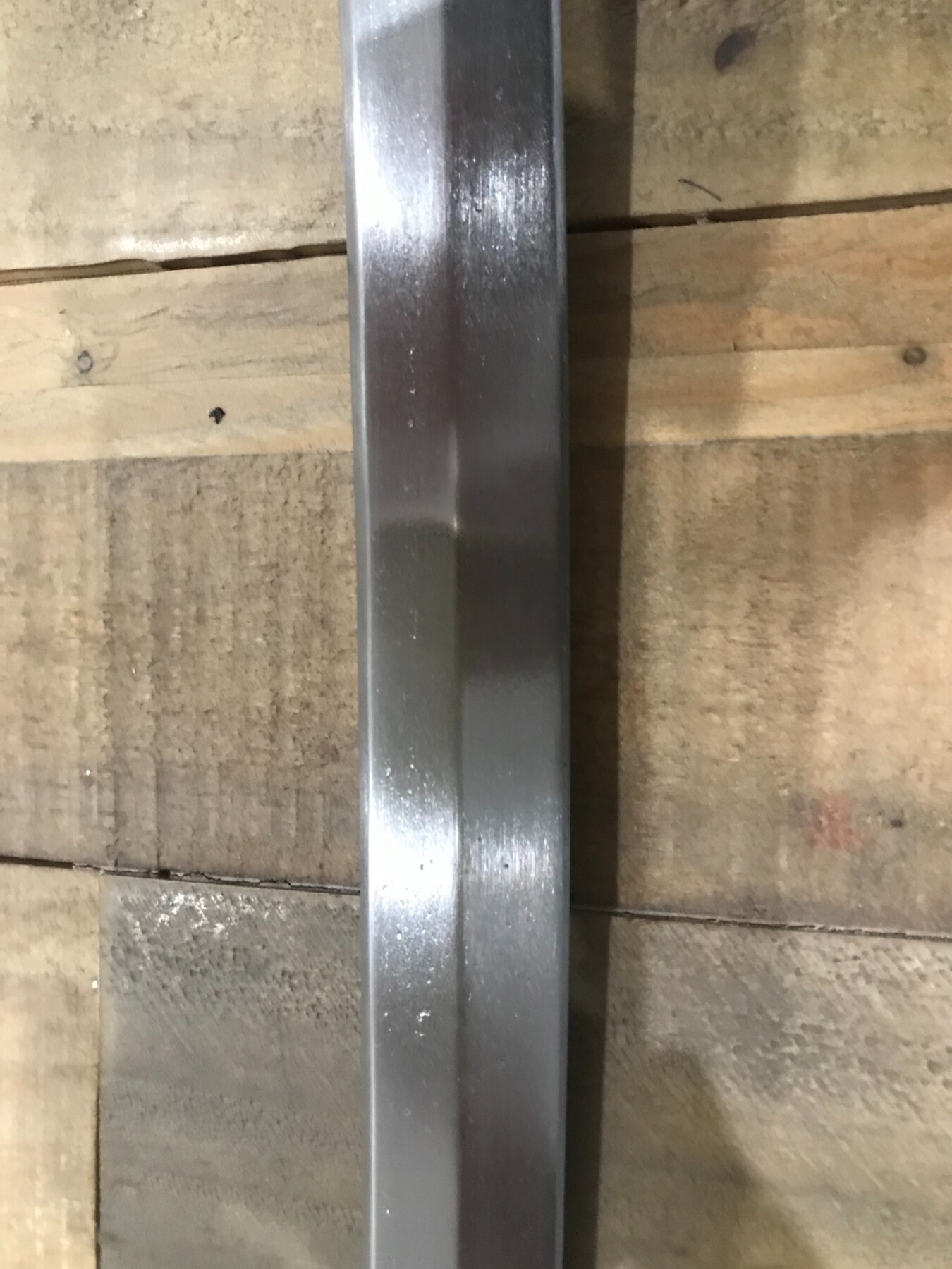

Blade is really poor, all the edges are rounded off, nothing crisp. No hamon to be seen.
Please remove the handle and post the bare tang as that will tell 100%
If it is as bad as expected, then 2 or 3 of the experts on this forum should be sufficient as many of them are subject matter experts.

                   As above ,reproduction 100%.... Type in  on a search engine - WW2 Japanese Officers sword for sale and you will find a photograph of a similar sword ,copy it and send it to the auction house  with these reports and it should be enough.....If not ,report them to their governing body or local trade description officer.....Be careful not to damage ,alter or clean the sword...Best if it is returned untouched in original package.... if possible ? ......If you alter or damage it you are stuck with it ! Good luck..

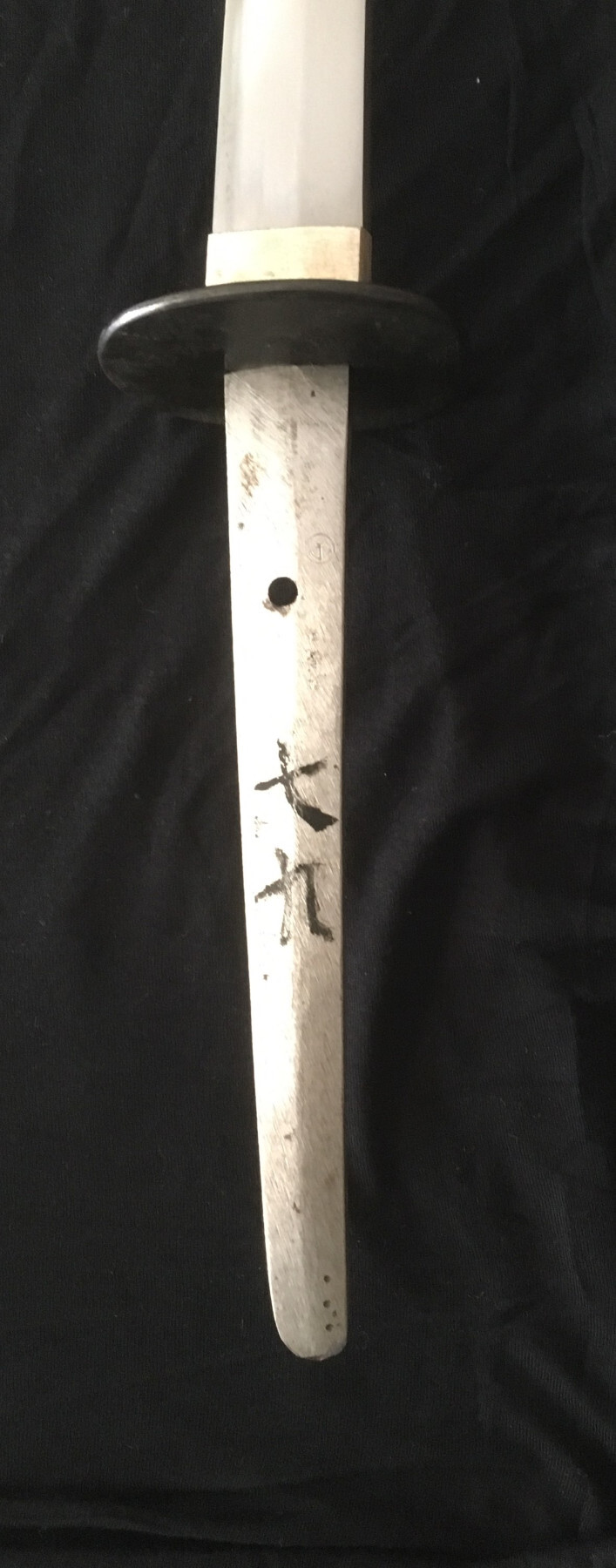

thanks  for your help i have removed the handle see pics below

Hi John,
as it looks like a stainless steel blade (other than the lack of any rust how can you tell ) do stainless steel blades also have marks on Tang ? sorry just learning about this at the moment , the rust on the tang seemed to come from a separate thin bit that looked like it was there to keep the handle fit well , do you think its stainless ? and is that also a sign that all is not right with the sword ? trying to gather info before the auction house call me back

Nigel,
100% Chinese fake.  Please get your money back.  The blade is one-piece, rolled steel, highly buffed.  I can show you pics of stainless steel nakago & blades, but for now here are some comparisons you can use with the seller:

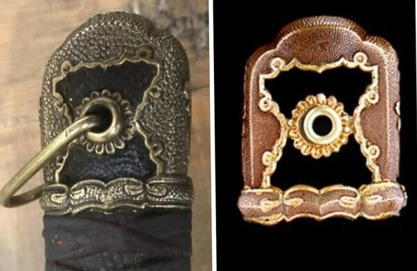

Kabutogane - no legitimate Japanese kabutogane looks like this one:
Fuchi - the fakers never get the detail right:

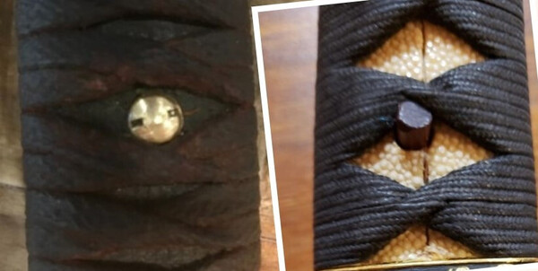

Officer swords used bamboo pegs, not screws (Yes the Contingency Model did, but this one is trying to be a Type 98):

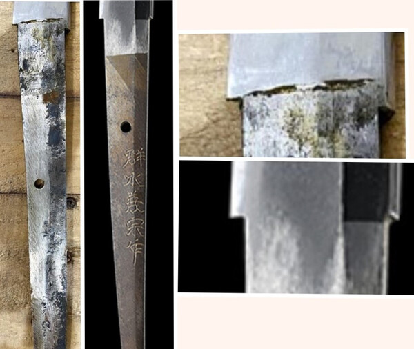

The nakago (tang) has no shinogi (the line that runs down the length of it), the yasurime (file marks are horrid compared to Japanese work); and the machi (the small notches where the nakago meets the blade) on Japanese swords are aligned (except on NCO blades) and the Chinese copies are always offset:
