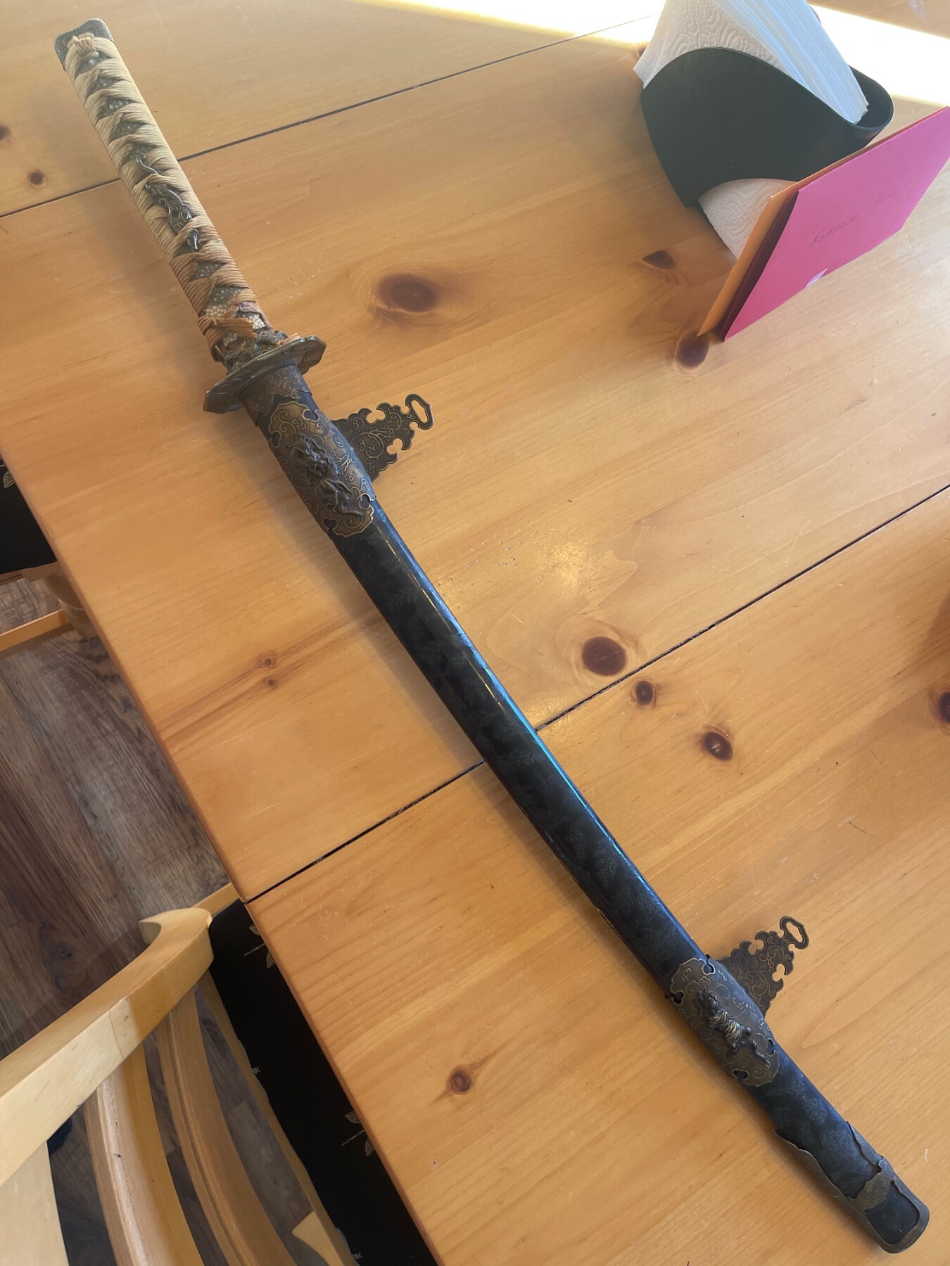

Andy Spohn Posted December 11, 2021 Report Posted December 11, 2021 While deployed in WWII my grandfather was in a liberated city in which he found a Japanese sword. It has been handed down to me and I was hoping I could find out more about it. I’d like to find out if it’s a machine blade made or forged and who the made the sword. Is there any way to determine this information? Quote
Lareon Posted December 11, 2021 Report Posted December 11, 2021 7 minutes ago, Andy Spohn said: While deployed in WWII my grandfather was in a liberated city in which he found a Japanese sword. It has been handed down to me and I was hoping I could find out more about it. I’d like to find out if it’s a machine blade made or forged and who the made the sword. Is there any way to determine this information? Post up some pictures of the sword and we can help you out Quote
ChrisW Posted December 11, 2021 Report Posted December 11, 2021 Yes, but you need to take some good pictures and post them there. If possible, get us the following kind of pictures: In mounts, sheathed. Unsheathed. IF it has a retaining pin in the handle, gently remove that pin and take the following: Bare blade, end to end, with the blade collar removed. Close up of the tang (nakago), both sides. Close up of the tip (boshi) Close up of any activity in the steel (Hada and hamon, which is the activity in the skin of the steel and the hard cutting edge respectively.) Pictures of the other fittings. 1 Quote
Andy Spohn Posted December 12, 2021 Author Report Posted December 12, 2021 Hello, thanks for the quick response. Attached are the photos I could get of the sword. I got on wooden peg out of the handle but couldn’t see if there were any others. I wasn’t able to get the handle off with mild pressure. How hard should I have to pull to get it off? I don’t want to break the handle or cause worse shape then it is already starting to get in (as you can see by the wrap on the handle. thanks, andy IMG_2395.HEIC IMG_2389.HEIC Quote
Andy Spohn Posted December 12, 2021 Author Report Posted December 12, 2021 Some more photos IMG_2387.HEIC IMG_2388.HEIC Quote
Andy Spohn Posted December 12, 2021 Author Report Posted December 12, 2021 More photos: is there a different way to upload these? I have 19 in total. IMG_2392.HEIC IMG_2390.HEIC Quote

Lareon Posted December 12, 2021 Report Posted December 12, 2021 Yes that link is fine Thats not a ww2 sword. Quote
Lareon Posted December 12, 2021 Report Posted December 12, 2021 18 minutes ago, Andy Spohn said: When I have the peg pulled out, I can’t see through it, what should I do? What button are you referring to? The button would be from a ww2 sword but since it's not ww2 it won't have a button so you can ignore that. I was hoping when you pulled the peg out you could see through so there were no obstructions to stop you taking the handle off. Quote

Andy Spohn Posted December 12, 2021 Author Report Posted December 12, 2021 Well, got it off! Very little force needed to be applied. This link provides some photos of the chips or nix in the blade and the handle. https://share.icloud.com/photos/02YaoMJrIAqGrOT1cl2Jwpumw Quote
Lareon Posted December 12, 2021 Report Posted December 12, 2021 Well interesting. That looks like a folded nakago. Orikaeshi It's one way to keep the signature when shortening the nagako. The filled semi circles are the old mekugi ana Quote

Andy Spohn Posted December 13, 2021 Author Report Posted December 13, 2021 So I was able to zoom in and get some better photos of the signature and the whole sword. https://share.icloud.com/photos/02ilGyuBmQDjwkLUSafS9BW2g Quote
PNSSHOGUN Posted December 13, 2021 Report Posted December 13, 2021 You may get better results in the Nihonto section. This could be quite a good sword, the fittings are Tachi style and of promising quality. The folded Mei was generally done for better quality smiths, the first character could be 勝 - Katsu Quote
SteveM Posted December 13, 2021 Report Posted December 13, 2021 It says 藤嶋 (Fujishima). It is a name used by a school of sword smiths: some great, some not so great. Judging from the orikaeshi mei, the signature on this sword is (or is trying to be) one of the older Fujishima smiths. Be aware - there are a lot of fakes in the sword world. 4 Quote
