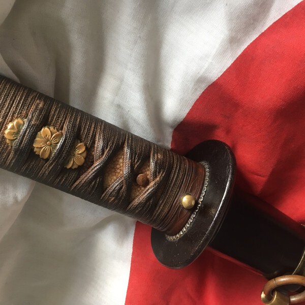

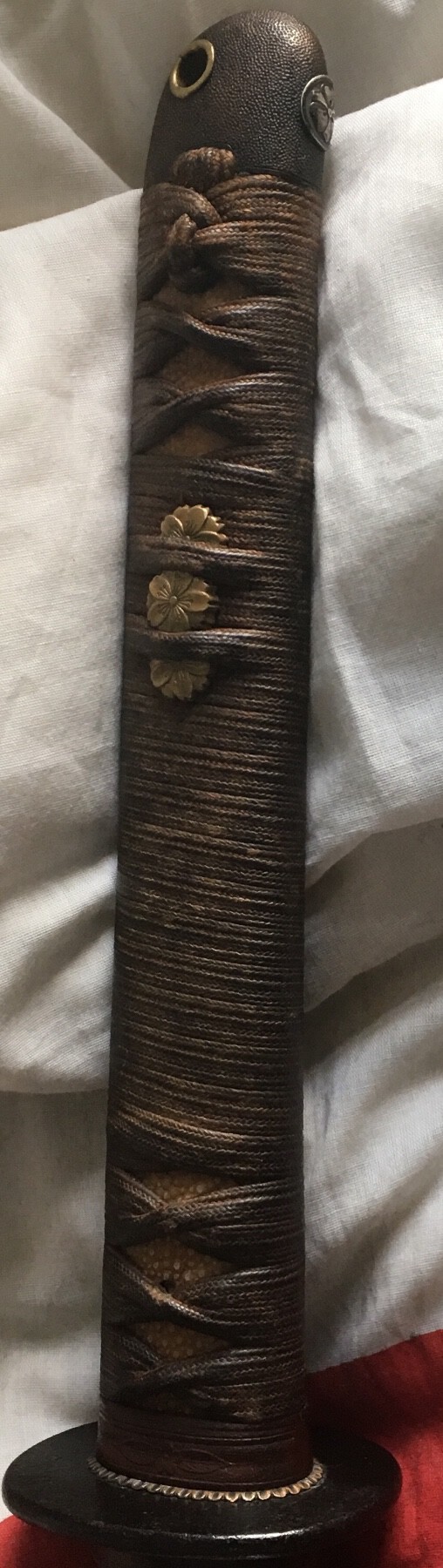

ECDA8CB5-AC87-4E42-A95A-8C9333EAE800.thumb.jpeg.71e55c313610a2af3323a6c62acbb887.jpegD7AA4252-2D5D-4549-982C-781753E27037.thumb.jpeg.9e77ddc64128c0faf69e29fff12ca2be.jpegMy latest sword is a Type 3 Gendaito blade signed I believe by AKIHISA.
The fiitings are in good order with a mon attached.

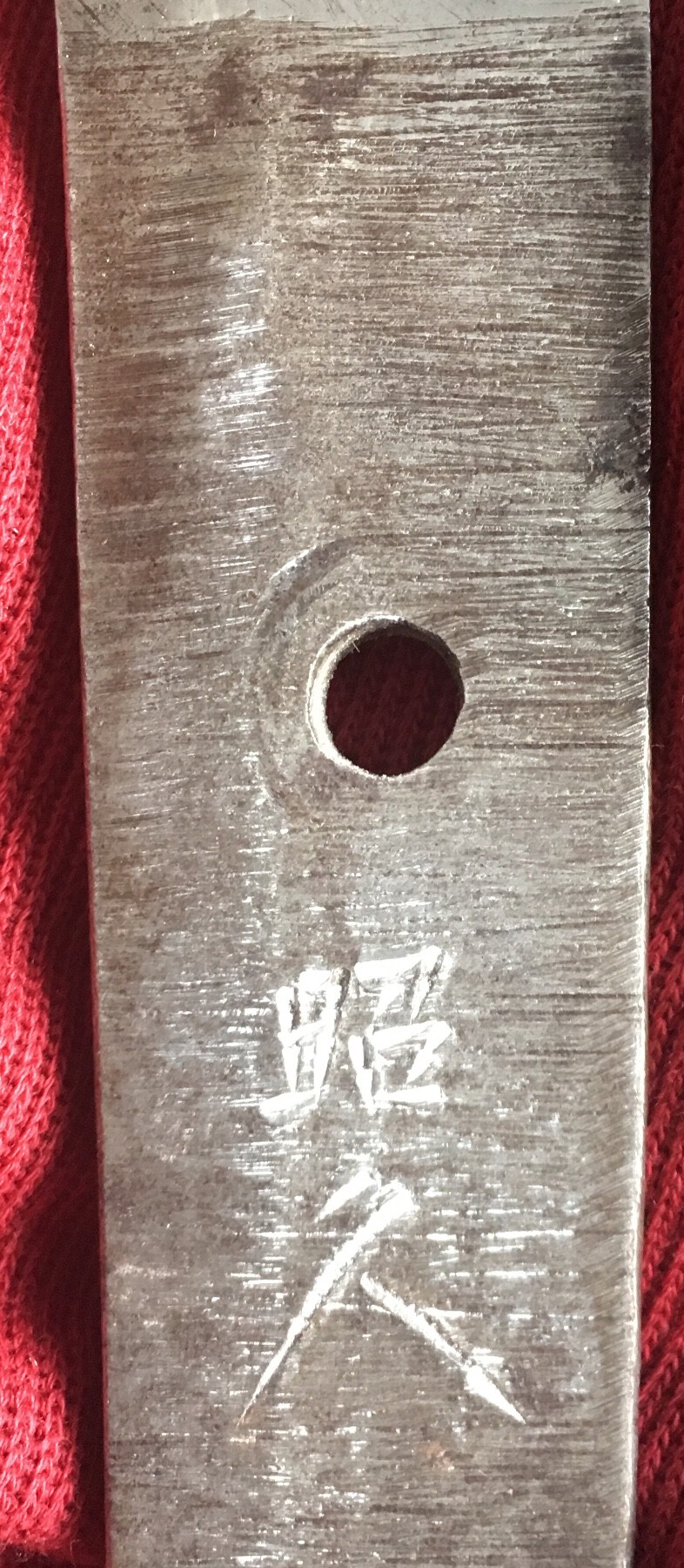

Having checked the blade there are no evidence of any markings only what’s on the tang.

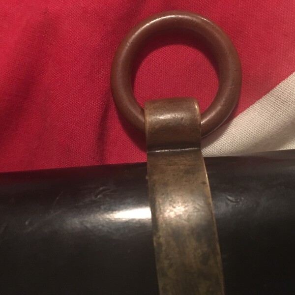

Saya appears to have been made for a leather cover, based on the smooth surface paint and the haikan (ashi).  Pretty unique and rare.
Bruce not sure on the leather cover the fittings on the hilt and sayer all show the same amount of wear 26770247-04A4-426B-B1B3-2A9276821F88.thumb.jpeg.e9089dad54b514013b9102eb52a35066.jpegF434C96C-62DB-412D-9F68-C1C439495AEA.thumb.jpeg.cebbc62f55706ddb48664f2efc0646ca.jpegAD5776B7-5760-4782-85AA-9A94D07EEB6E.thumb.jpeg.6f2ee40313a911f6fe1187e358031aae.jpeg

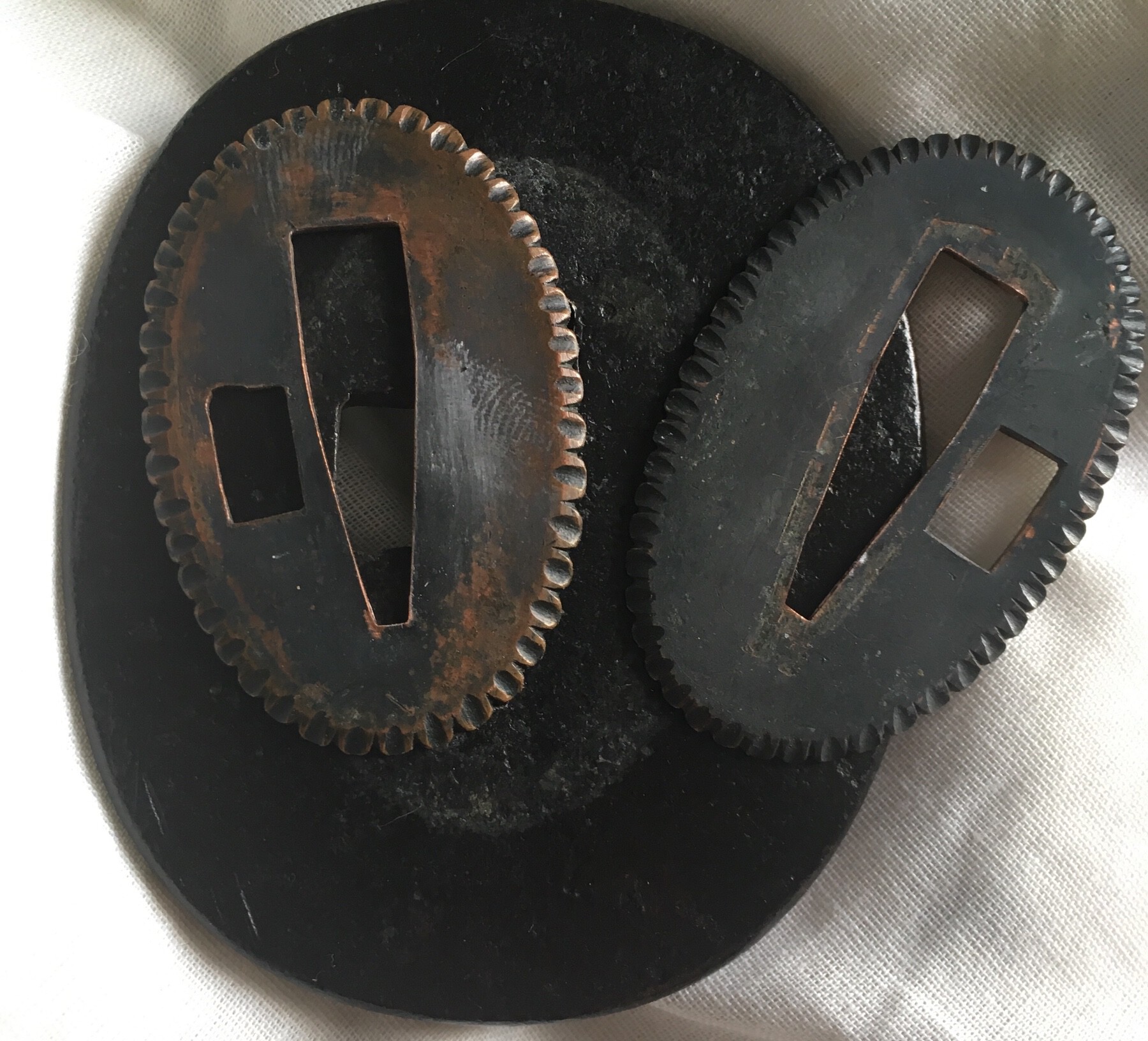

The Saya is a bit odd, can't ever recall seeing a Type 3 with a "combat" style saya like that. As Bruce suggests, this likely would have had a leather cover. Otherwise a great example, it is extremely uncommon to find Mon on this pattern of mounts.
This officer definitely had a individualist streak!  But we've seen that with other gunto, too.  Just the first one we've seen in RS fittings.
Gareth, while anything is possible with gunto, I can assure you the haikan on this was meant for a leather cover.  Rinji seishiki haikan look like this:
Here is a photo of several styles of haikan made for leather-covered saya:
Nice blade by Yamagami Akihisa of Niigata.
Just for us WWII nerds (I mean Bruce and me) can you tell us if there is a stamp and number on the tip of the date side of the tang?
Usually a 'matsu' kanji in a circle with a number.
As this blade is dated sho 17/11 I think it should be numbered about 575
Also, does it have a star stamp on the top of the name side of tang.
