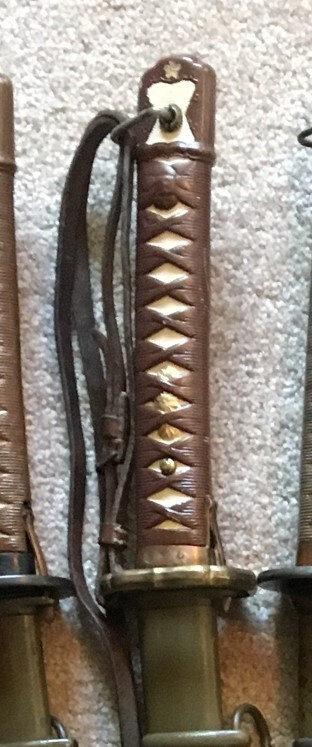

paul griff Posted December 8, 2021 Author Report Posted December 8, 2021 Hello, Thank you for the information and comments....Some more photo’s attached and if anyone needs more just let me know.. Regards, Paul.. 1 Quote
paul griff Posted December 8, 2021 Author Report Posted December 8, 2021 Hello, A couple more of the hilt and with a knot for my new “best friend”.... Regards, Paul.. 1 Quote

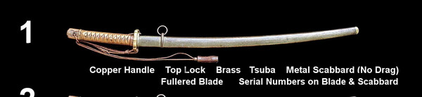

Bruce Pennington Posted December 8, 2021 Report Posted December 8, 2021 Paul, Don't know if your tassel came that way, but with the brass tsuba 95s, they're designed to start at the tsuba, then loop through the sarute, and then hang down. Here's a couple of pics, one from Ohmura, and one of mine: 1 1 Quote
paul griff Posted December 8, 2021 Author Report Posted December 8, 2021 Hello Bruce, Thank you,.....altering it now....Knot is a replacement I have had for years but very good quality....nearly all the nco knots I come across are really fragile so I just use this one for effect. Regards, Paul.. 2 Quote
Lareon Posted December 8, 2021 Report Posted December 8, 2021 1 hour ago, paul griff said: Hello Bruce, Thank you,.....altering it now....Knot is a replacement I have had for years but very good quality....nearly all the nco knots I come across are really fragile so I just use this one for effect. Regards, Paul.. I have tassels for all my swords but the sad thing is they mostly live in bags with their respective sword written on them so they don't degrade further 1 Quote
