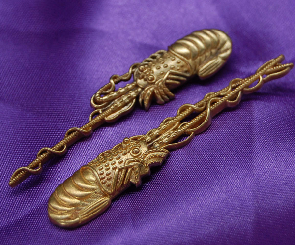

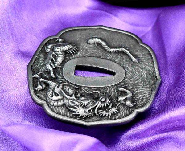

vajo Posted December 5, 2021 Report Posted December 5, 2021 from chinese producers. Frightning. Tsuba $90 (2 x available) sofecoke sword | eBay Stores Hard Times 3 1 Quote
b.hennick Posted December 5, 2021 Report Posted December 5, 2021 I agree. They will be bought, enhanced, and resold many times. 3 Quote
Fred Geyer Posted December 5, 2021 Report Posted December 5, 2021 Look at the Ebay site he has sold hundreds of the fake fittings, one more way to ruin a hobby for the new person everyone should look at what they are producing to educate yourself Fred Geyer 3 Quote

vajo Posted December 5, 2021 Author Report Posted December 5, 2021 Thats true Jesse, but i'm fascinated to see such quality and details for $30. I would like to see chinese blade e.g. from simon lee fitted with that kind of replics. Such a sword would look good in my opinion. Quote

vajo Posted December 7, 2021 Author Report Posted December 7, 2021 I wonder how he gets such fine details from casting. They are lightyears away from the normal chinese stuff for replica and training katana. In the right hands it will be hard to judge from photos if its real or not. Quote
mas4t0 Posted December 7, 2021 Report Posted December 7, 2021 On 12/7/2021 at 8:13 PM, vajo said: I wonder how he gets such fine details from casting. They are lightyears away from the normal chinese stuff for replica and training katana. In the right hands it will be hard to judge from photos if its real or not. Expand I'd assume they're made of copper, bronze, brass, aluminium or zinc and are cast in plaster moulds. It's not a complex process, but it's significantly more labor intensive than investment (lost-wax) casting. 1 Quote

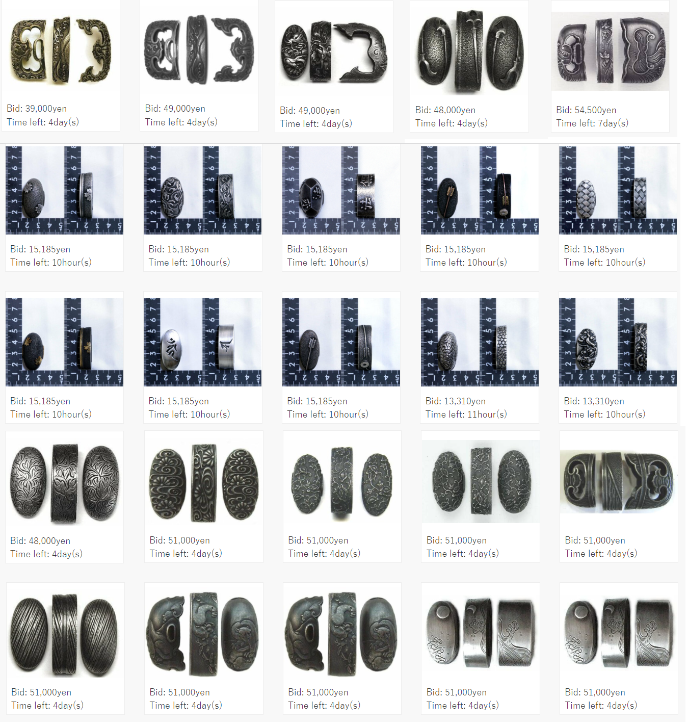

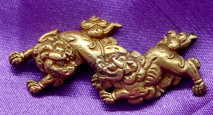

Spartancrest Posted December 8, 2021 Report Posted December 8, 2021 Jean L. What frightens me is a huge number of fakes that are listed at the high end of prices not the low. You might laugh at some of these: https://www.jauce.com/auction/c738641596 https://www.ebay.com.au/itm/254393179943 - https://www.ebay.com.au/itm/265400937434 - https://www.ebay.com.au/itm/313782033171 [WTF] https://www.ebay.com.au/itm/324320515489 - https://www.ebay.com.au/itm/313782032622 - https://www.ebay.com.au/itm/265418601464 The two cast replicas below are ridiculously priced for their scrap value - I have two myself and have images of nearly a dozen just like them - all but one are fakes. And these are not as good as the new ones coming out. Mark: I swear some fakes are punched out in the same manner as coinage - industrial counterfeits! You might like to check the prices on these modern fakes. 2 Quote
