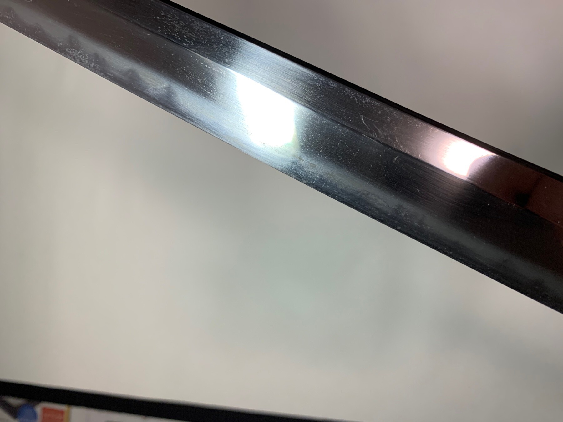

I am not 100% on this kanji but the blade is traditionally made with an oil quench and the hamon is real.
Nagasa is just under 26inches

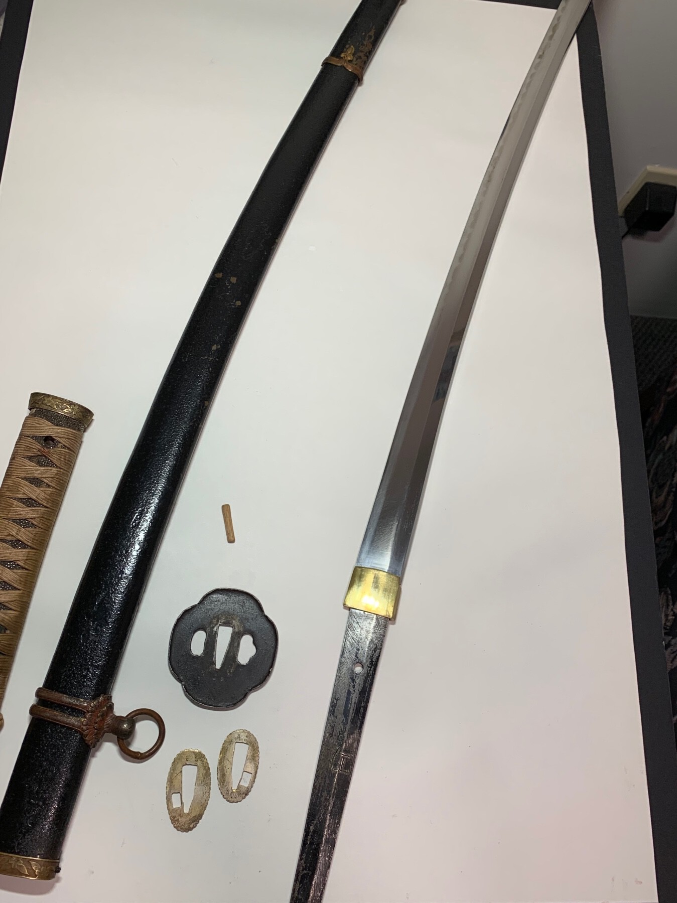

locking pin is missing

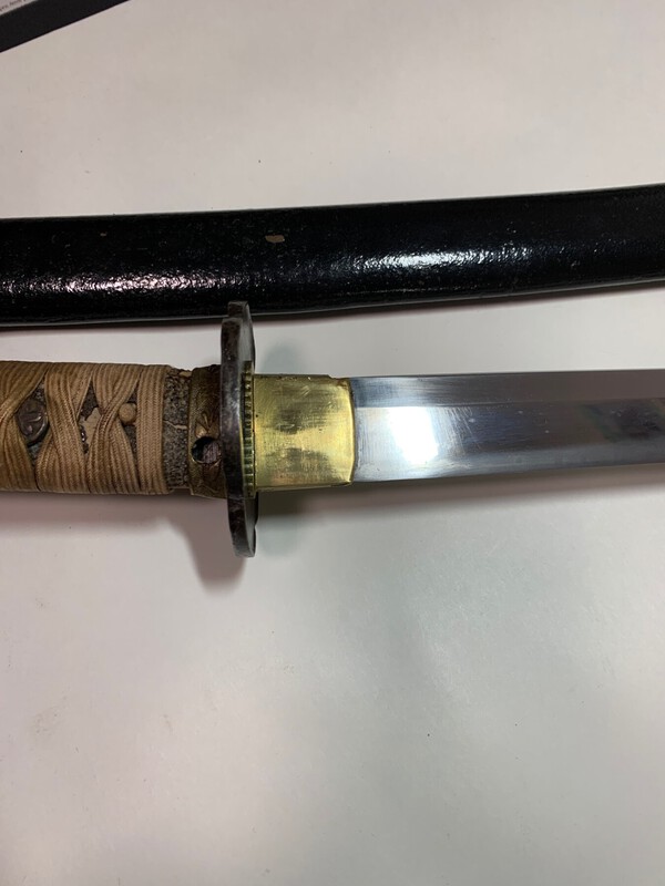

tang , saya , tassel loop Tsuba has been treated with black urushi resin for weather.
fittings are all tight and line up properly.
seppas are numbered 45
no nicks or chips
A tiny bit of discolouration in a few parts of the blade
a bit of chipped paint and rust on the saya
blade is heavy and wide.

the hamon and blade show quality
all the parts fit tight and line up
there are lots of WW2 blades that have Urushi resin for protection against snow or it could be even for being close to salt water

Hamon seems to have some nice activity for me for being out of polish

My take..it's gimei. The hamon is completely different to Emura's usual. And you said so yourself...looks oil quenched. That means not Gendaito and therefore not Emura. I haven't seen an Emura Showato.
THAT SAID...it's priced very fairly now for a WW2 sword, even if gimei. So should sell with or without the mei. Buy it as a gimei at a reasonably price, and if it turns out to be a Gendaito....score.
