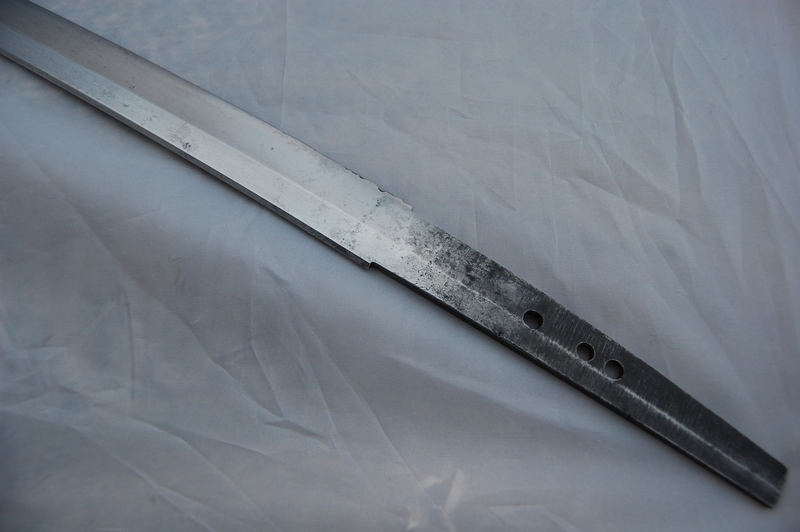

loiner1965 Posted February 22, 2009 Report Posted February 22, 2009 esp for john stuart...not very good pics of my friends wakizashi and unknowingly he commited the inmoral sin in cleaning the tang but that was years ago........its out of polish but he says you can see the suguhu / straight temper in the blade...someone verified it as genuine and it has been on this forum a few years ago as i and another sent in the kanji for rich turner to translate. the 100,000 dollar question is would you buy an out of polish and no papered omi daijo fujiwara tadahiro which has been through the wars and minor damage around the habiki........i love it Quote

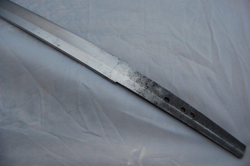

loiner1965 Posted February 22, 2009 Author Report Posted February 22, 2009 here you are paul.....the tang was cleaned by my friend years ago as he knows nothing about nihonto as the sword was his fathers from a debt i believe Quote
paulb Posted February 22, 2009 Report Posted February 22, 2009 Well, on first view the mei looks within the range of Omi Daijo signatures. In partcular the Fujiwara characters and the Hiro character look to be good matches. (kick your friend for cleaning it though) All I can say so far is that it is not an obvious fake (of which there are many) As said before it depends what he wants for it and how much you would be prepared to spend to bring it up to standard. good luck Paul Quote
loiner1965 Posted February 22, 2009 Author Report Posted February 22, 2009 Well, on first view the mei looks within the range of Omi Daijo signatures. In partcular the Fujiwara characters and the Hiro character look to be good matches. (kick your friend for cleaning it though) All I can say so far is that it is not an obvious fake (of which there are many) As said before it depends what he wants for it and how much you would be prepared to spend to bring it up to standard. good luck Paul told him they are 99 out of 100 fakes of this smith out there but i also told him 2 years ago i believe its genuine...i love to have it but he will not sell and i respect him for that.only live 30 miles from me and he is a genuine man and as took time out to try and photograph it as best he can for me this weekend......cannot wish for more Quote

Clive Sinclaire Posted March 17, 2009 Report Posted March 17, 2009 It's a great shame that there is so much wrong with the nakago and it is a million miles away from ubu. The mei looks pretty good but the suriage, machi-okuri, 3 mekugi-ana and it looks like damage to the ha-machi, mean you need to buy this very cheap indeed. I would pass on it as there will always another Tadahiro along in a minute! Clive Quote
loiner1965 Posted March 18, 2009 Author Report Posted March 18, 2009 It's a great shame that there is so much wrong with the nakago and it is a million miles away from ubu. The mei looks pretty good but the suriage, machi-okuri, 3 mekugi-ana and it looks like damage to the ha-machi, mean you need to buy this very cheap indeed. I would pass on it as there will always another Tadahiro along in a minute!Clive would love to have it clive but he will not sell as it was his fathers and like most things in life he doesnt need to sell lol Quote
