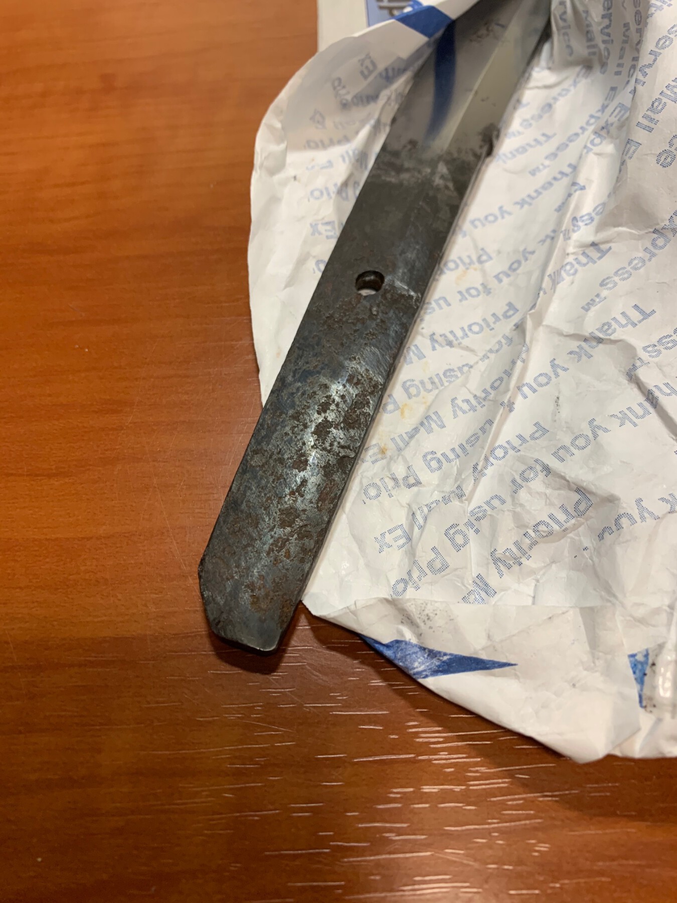

Mason,
Well done with the mei!
It looks like a Kaga shinto, Kiyomitsu perhaps. It is machi okuri rather than suriage.
It seems like a nice sword.
The NAKAGO of this blade looks as if it was welded onto a blade. The material seem wrong/not of the same age and the filing close to the MEKUGI-ANA as well as the colouration look strange.  But that may be a light effect on the photo. Tha 'MEI' is very questionable, and the NAKAGO JIRI perhaps wants to look like KAGA, but these are quite different.
