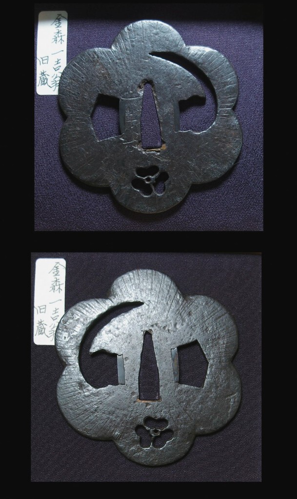

Your tsuba is a Ko-sukashi  [sukashi, limited in size and in negative silhouette] with a single Sakura [Cherry blossom]. Sakura could also be a family Mon [heraldic symbol - so possibly also seen as a Mon-sukashi] the plate surface is done in Amida-yasuri [radiating lines, often known as the halo of the Amida Buddha]

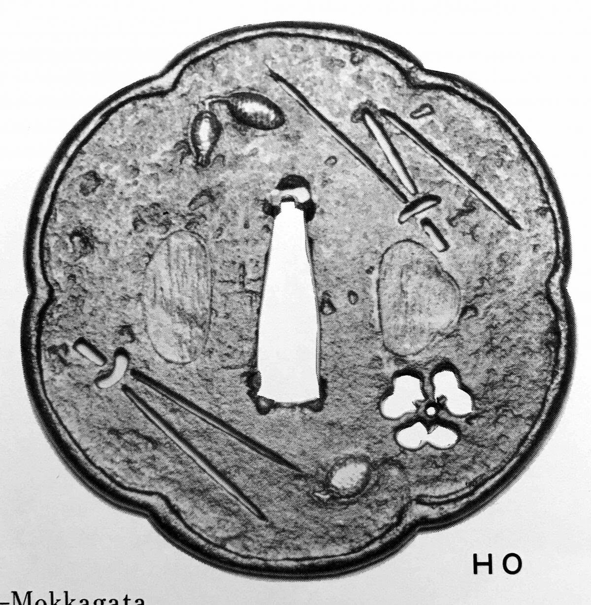

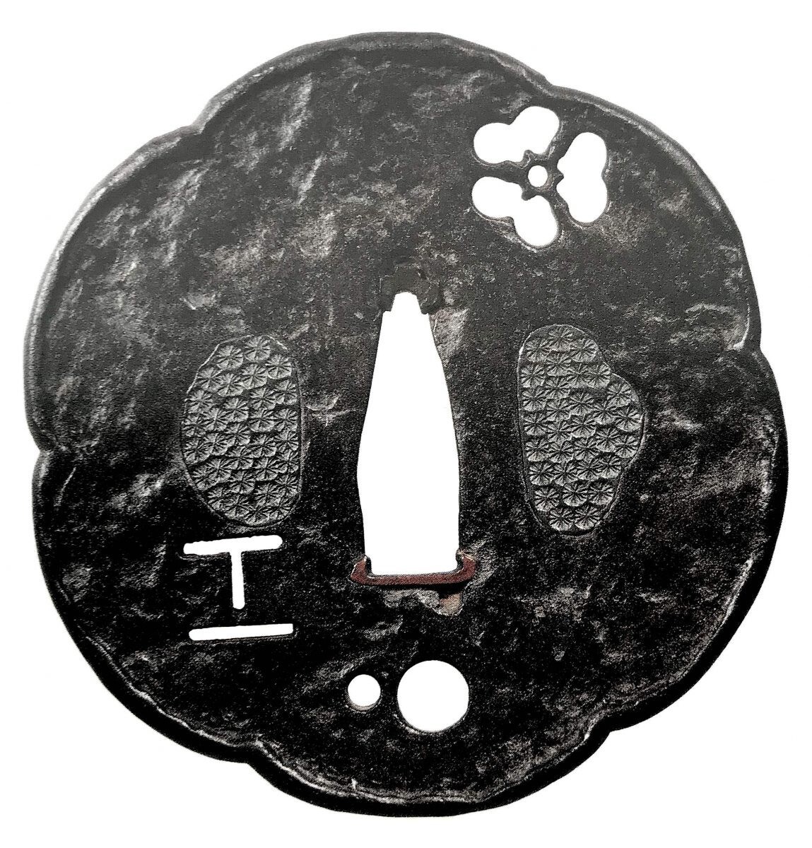

The sukashi element is an oxalis (wood sorrel) IMO.  While he doesn't have anything to do with the tsuba in question, the Nidai Yamakichibei regularly used this motif.

The SUKASHI cut-out looks more like a KATABAMI flower to me. The surface of the TSUBA is covered with AMIDA YASURIME.
