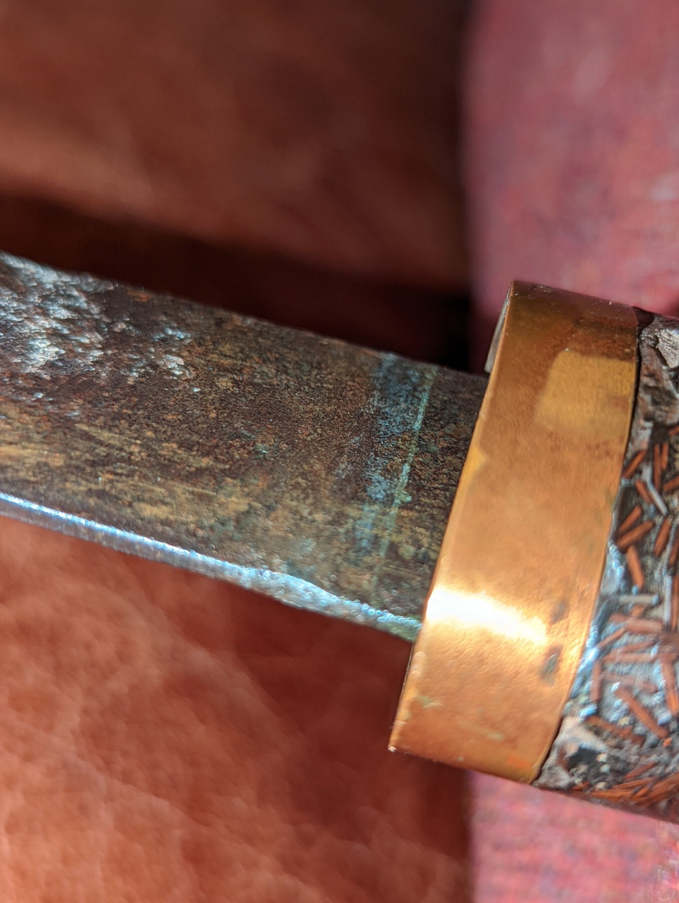

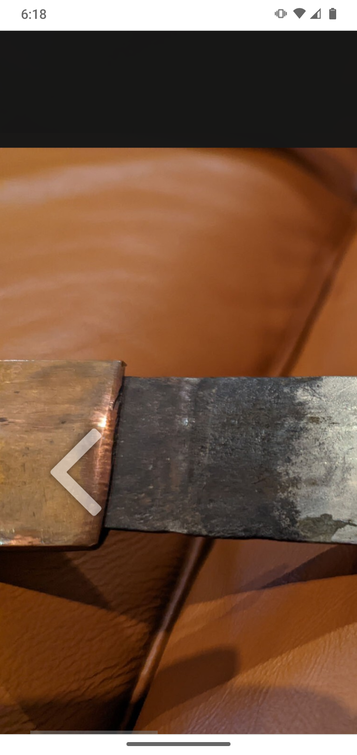

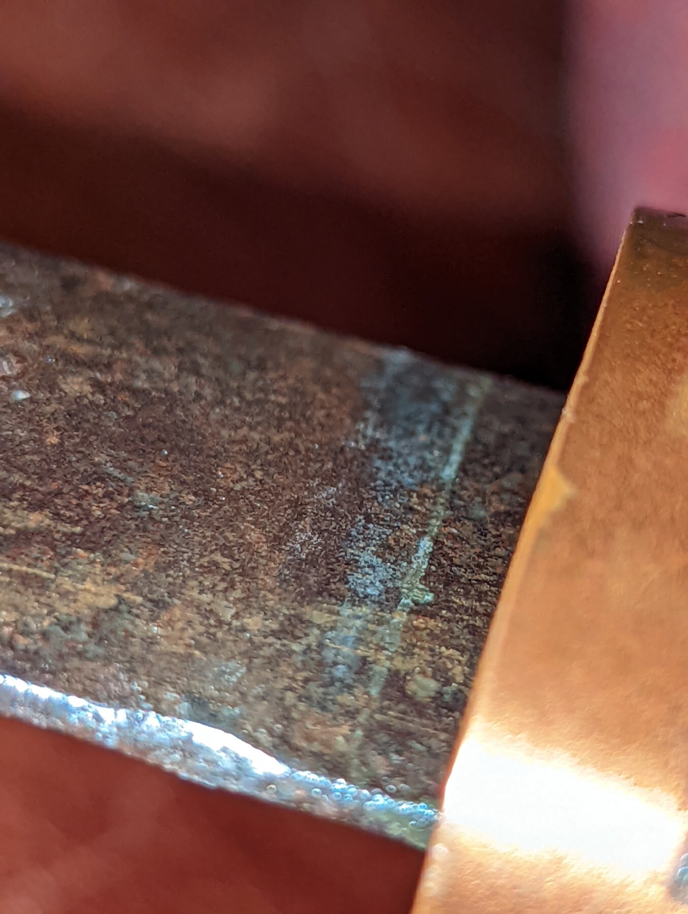

Stephen Posted November 27, 2021 Report Posted November 27, 2021 Yes the Nihonto God's smiled on you or better known as blind luck. LOL The next time you have it apart Id like to see where the blade meets the nakago the dark line ... Detailed pictures please. Quote
Stephen Posted November 27, 2021 Report Posted November 27, 2021 Just want to rule out the long nakago added to blade. Quote
Bugyotsuji Posted November 27, 2021 Report Posted November 27, 2021 Stephen, glad you asked that question and not me. Quote
Lareon Posted November 27, 2021 Author Report Posted November 27, 2021 Yup here you go. I took quite a lot of photos of this area so if you want anything more let me know. It lines up perfectly with the last Seppa and tsuba so I'm thinking it's some kind of marking from that 1 2 Quote

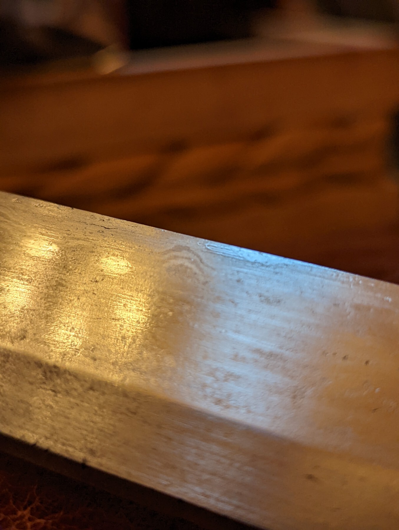

Lareon Posted November 27, 2021 Author Report Posted November 27, 2021 Every time I take this out and look at it. I see a new beautiful section in a different light. Quote

Stephen Posted November 27, 2021 Report Posted November 27, 2021 Yes! Tanks! Calms any fear i had. 1 Quote

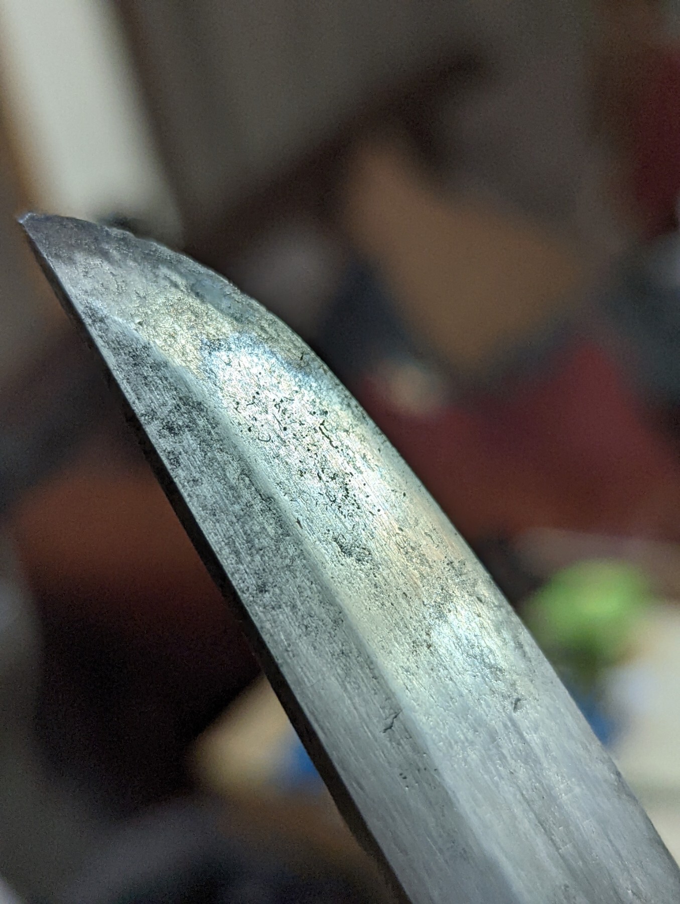

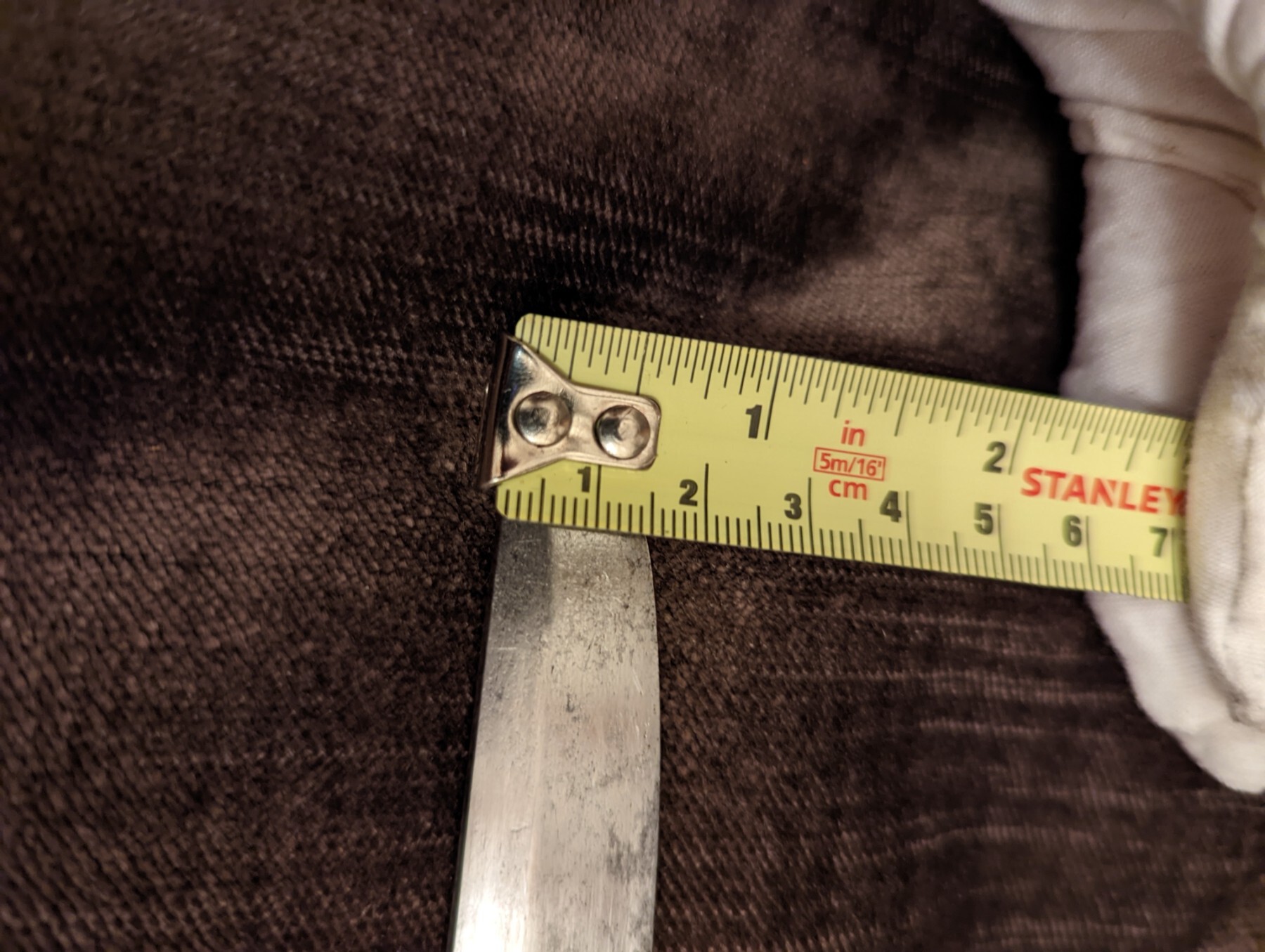

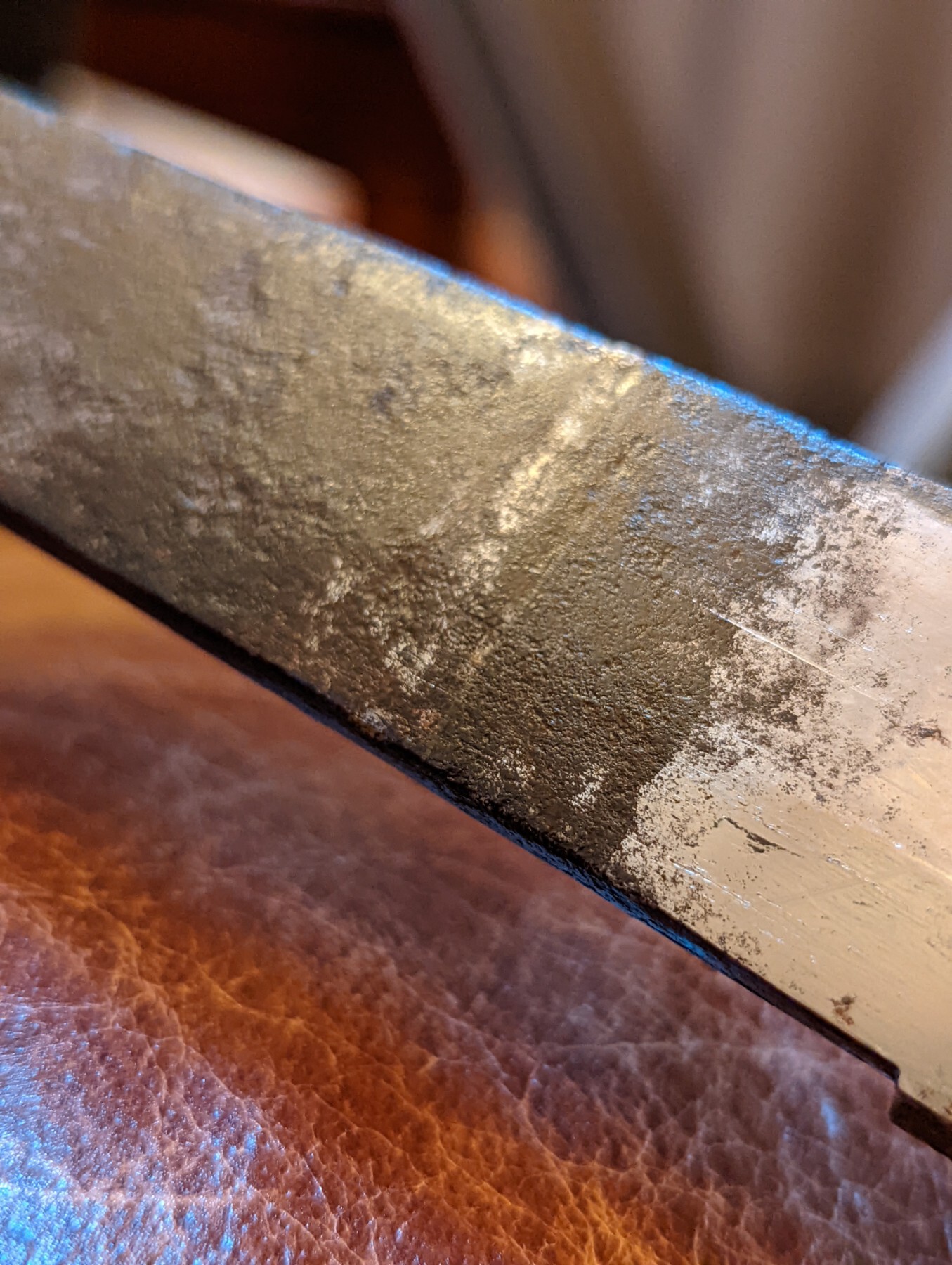

Lareon Posted November 27, 2021 Author Report Posted November 27, 2021 Here is the kissaki. It measures 1.5cm from the point shown in the photo. @Rivkin I can't see the hamon around this area at all Total length of of the whole sword is 120cm in the koshirae. Quote
Franco Posted November 27, 2021 Report Posted November 27, 2021 On 11/27/2021 at 6:11 PM, Lareon said: I can't see the hamon around this area at all Expand This should top the list of things to do whether it be seeking help (the eye) from an experienced collector or even going so far as having a window opened by a polisher. Confirmation of the presence of the boshi will be the determining factor for what comes next. 1 Quote

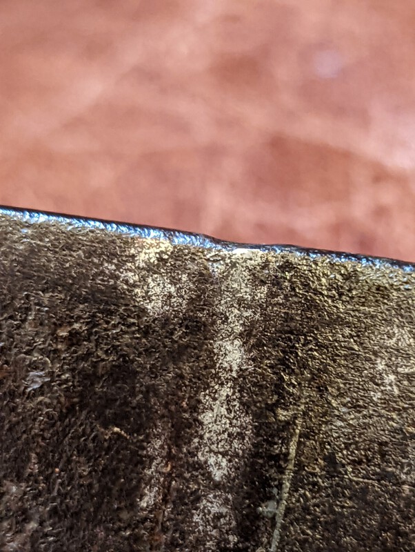

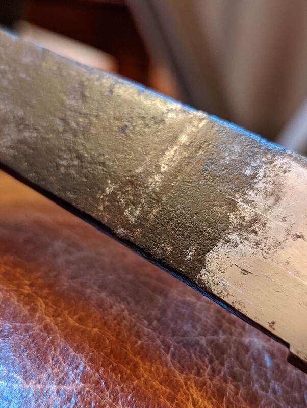

Lareon Posted November 28, 2021 Author Report Posted November 28, 2021 Ok so update. In the daylight I can see the boshi clearly and managed to get a photo of it 2 Quote
Franco Posted November 28, 2021 Report Posted November 28, 2021 On 11/27/2021 at 10:43 PM, dkirkpatrick said: I have to disagree that the presence of boshi should dictate what is done. Expand On 11/28/2021 at 12:51 AM, Stephen said: Rest your fears about boshi and other red flags ppl want to wave. Expand On 11/28/2021 at 10:10 AM, Jussi Ekholm said: I agree with Doug and Stephen above, don't be too stressed about small things. Expand My, my, my, did I say not to polish, did I say you don't have options, did I say it shouldn't be sent for shinsa, did I even say it couldn't pass a Juyo shinsa? Well, did I? Just to lay aside fears and stress and whatever else your wondering minds might conjure up and attach to my thinking, thoughts, I know for a fact that there are juyo swords with a polisher drawn in boshi and hamon (interruptions), but from a collector and sword owner perspective it would be advisable knowing whether there is a boshi problem going in before determining and making choices about how to proceed. I'm happy to hear that Tony can see a boshi, and if that is in fact the case then it removes seeing if there is a boshi off the top of the list of things to do. Good day. Quote
