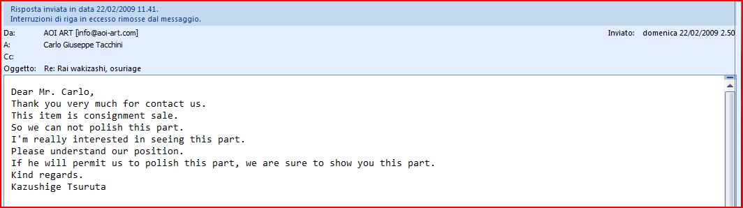

Getting any images from Tsuruta-san will be of very limited value. In order to fully view the kitae, the cross section needs to be prepared by polishing and etching.
