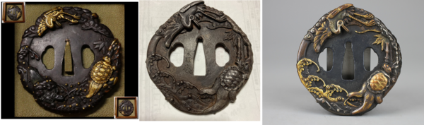

Can anyone spot the difference between this - ���������� ���ס������ޡ��ٹ� Ŵ�����ס�����ס��ĤС�。���� - and this- ����������� ���������!! 104580</a></h3>                                              </div>
apart from the scratches?  Answer is 30,500 yen  https://www.jauce.com/auction/q1025366646   +   https://www.jauce.com/auction/k1036012236

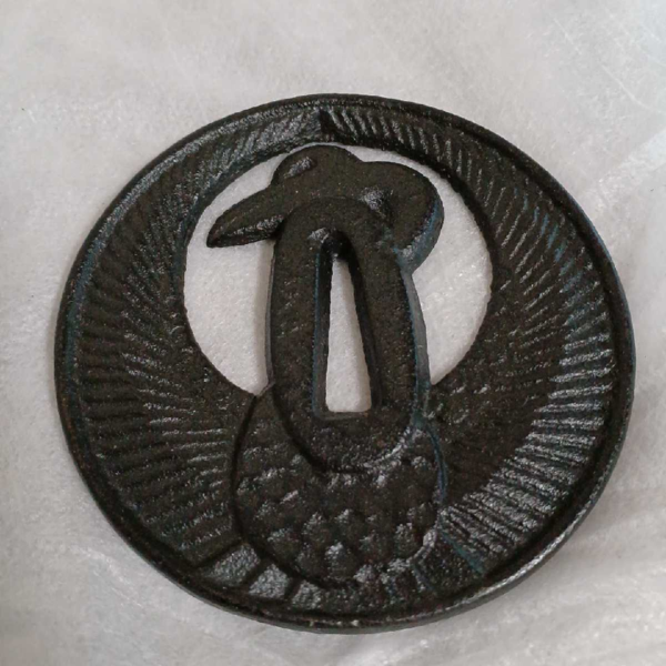

Answer is 48,600 yen  [the rusty plain one is the more expensive!]  https://www.jauce.com/auction/t1035229661  +  https://www.jauce.com/auction/w1035433253
Talk about price gouging these two designs are just the tip of the iceberg when it comes to modern fakes.
I have to give thanks to Roger Dundas who sent me an example of the gilded guard [same as that at the top] to examine.

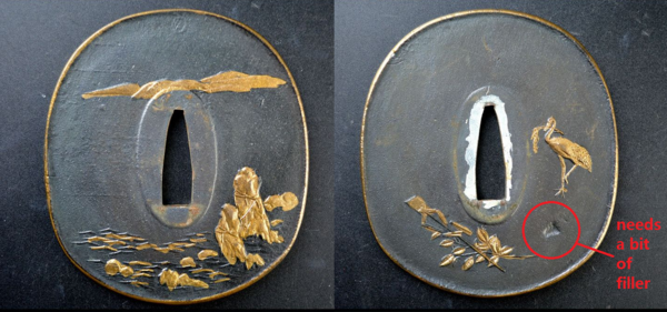

Three copies, and ugly cranes at that! Two are reputed to be by Kano Natsuo [if true he was having a really really bad day!]
During the Edo period the Japanese devised a lost-wax technique for producing superb quality castings. The description (in 'Silverwork and jewellery' by H. Wilson) related to castings of bronze, but could probably be used for iron as well. Essentially the method was to enclose the wax model with a thin layer of very fine clay into which paper fibres had been incorporated. This was then reinforced with a thicker layer of clay mixed with straw to support the paper-filled layer. When heated to melt out the wax the paper fibres and straw burnt away leaving a porous surface inside the mould that allowed gasses to escape but not the molten metal. There would inevitably be a sprue where the molten metal was poured in that needed to be cut off and the area cleaned up, but all the rest of the casting would have a smooth surface needing little or no finishing work.
