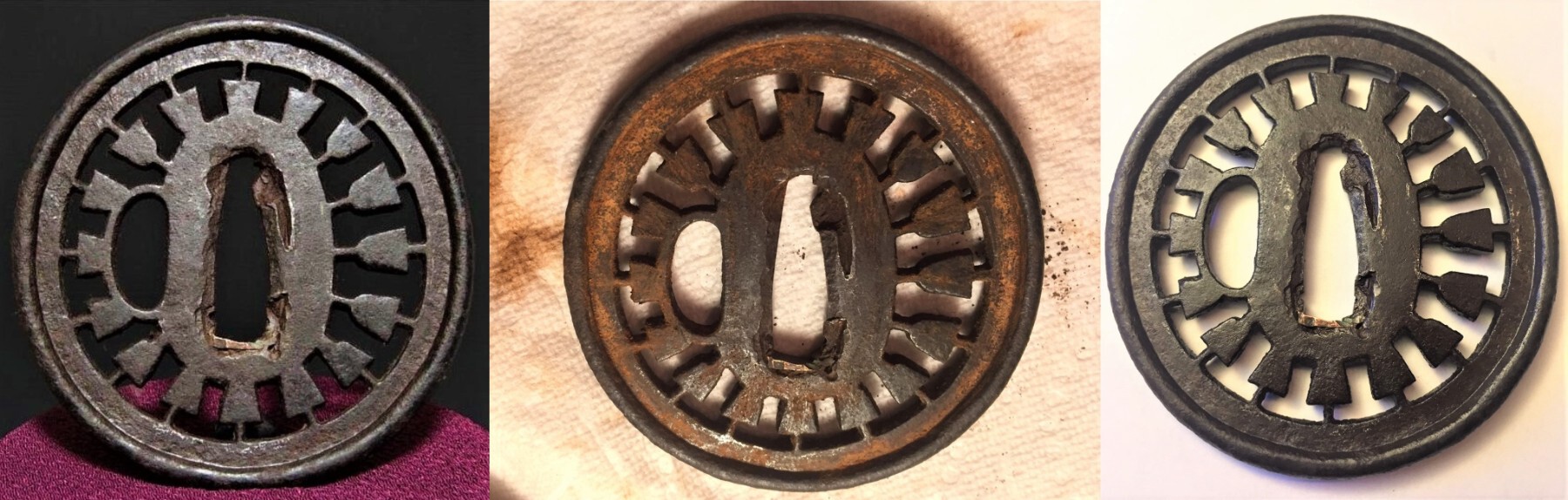

GRC Posted January 14, 2022 Report Posted January 14, 2022 For IRON tsuba, I'm having some nice success with antler. Don't go anywhere near soft metal inlays with an antler! Here's about three hours of antler work (before, during, after): Procedure I used: 1-Did 2 hours of scraping with antler *There was a lot of "bubbly" looking surface rust and crud to deal with 2-Soaked in mineral oil for about 5min 3-Scrubbed tsuba with an old toothbrush to get as much rust-dust off of it as possible *Oil "disguises" the rust, so don't fool yourself after the oil & scrub steps, by thinking everything is perfect 4-Wiped/dabbed as much oil away with paper towel so I could see if it needed more work... and yes it did. 5-REPEATED STEPS 1-4 [One more hour with the antler tip to hit target areas, followed by oil soak, toothbrush scrub, wipe with paper towel] Pretty happy with the results so far... Now one of my other tsuba has a "big brother". 3 Quote

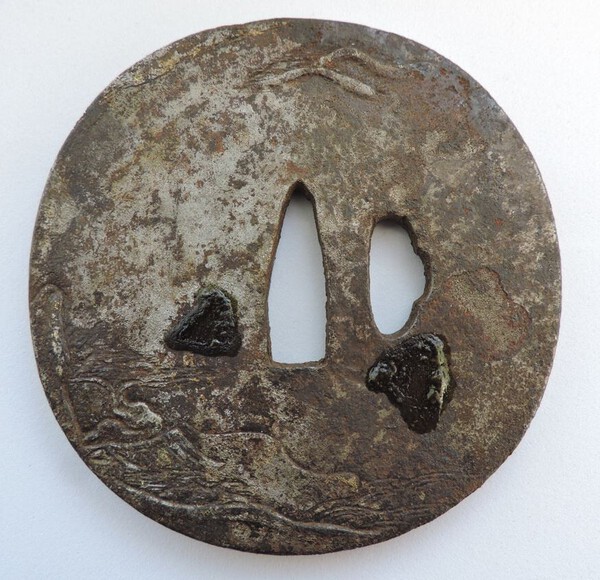

JohnTo Posted January 20, 2022 Report Posted January 20, 2022 Like most tsuba collectors I have acquired some rusty junk examples. One that I have been experimenting with is a circular plate tsuba, covered with rust when I bought it as ‘the freebie’ in a mixed lot. It is round (8.3 x 8.2 x 0.45 cm) depicting a Chinese landscape with figures next to huts and a boat on a lake. Probably not commercially worth having it professionally restored. My first stage was to clean the surface with cotton buds soaked in WD-40 to remove most of the red surface rust. I like WD-40 (the name stands for Water Displacement formula #40) as it was designed for the aerospace industry and seems to be able to seep in between the rust particles and the iron and loosens them enough to be wiped off with a cotton bud. At this stage the reverse side in particular seemed to have a grey-green colour and this led me to believe that a previous owner had removed the rust and patina with acid, or Cocoa-cola, but the exposed iron had rusted again. The little copper and silver tagazogan figures did come up nicely. After this and all liquid treatments I dry the tsuba with tissue (kitchen roll) and leave overnight on a hot radiator. My next stage was to use WD-40 and penetrating oil, separately, and an old electric toothbrush and this removed more light surface rust (you can see the rusty oils soaking into the kitchen roll) but did not seem to touch the heavy patches. My last stage was to try Renaissance Metal De-corroder, an amine complex of hydro-oxycarboxilic acid in aqueous solution at a pH of approximately 4.0 (i.e. slightly acidic), applied with a cotton bud. It is claimed that this material ruptures the bond between the base metal and corrosion layer, reducing iron oxide to sludge, which can be wiped away. Rust was certainly evident on the cotton bud, but a more liberal covering on the more corroded areas together with use of a piece of bone did not get down to base metal. As the tsuba was effectively junk I decided to try something more drastic. There were several heavily corroded areas and I dripped some De-corroder on these patches. I then placed the tsuba in a plastic box (CD case) to prevent the De-corroder drying out and left it overnight. The areas covered with De-corroder had swelled into a black jelly and wiping this off with cotton buds soaked in water revealed that the rust had been largely removed exposing the bare iron (see pics). I have not carried out this process any further, but I expect that I could end up with a rust free piece of shiny iron, which I would either protect using Renaissance wax polish, or try to repatinate. Please note that I am not recommending the use of De-corroder on areas of tsuba that still have some of the original patina. I have not tried it, but I would expect that long exposure would result in the patina being removed as well as the rust. Remember, rust and patina are both iron oxides. However, this product does appear to remove rust from iron while leaving the underlying metal untouched, which is more that can be said for use of hard abrasives or steel picks. Best regards, John Pic 1 and 2 Before cleaning Pic 3 and 4 After WD-40, penetrating oil with electric toothbrush Pic 4 and 5 before and after De-corroder 1 Quote
