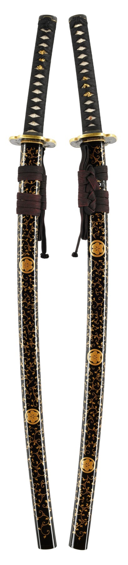

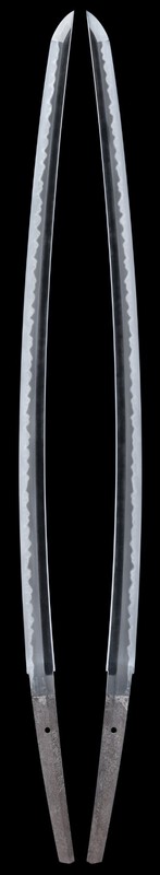

A friend of mine showed me a specific katana from an online seller:
Paper(Certificate):[N.B.T.H.K] Tokubetsu Hozon Token
Country・Era:Musashi (Tokyo)・Late Edo period 1857
Blade length(Cutting edge): 73.2cm
Curve(SORI): 2.1cm
Width at the hamachi(Moto-Haba): 3.16cm
Thickness at the Moto-Kasane: 0.81cm
Wide at the Kissaki(Saki-Haba): 2.60cm
Thickness at the Saki-Kasane: 0.55cm
Length of Koshirae : about 102cm
Habaki: One parts, gold foil Habaki
Sword tang(Nakago): Unaltered,Sujikaiyasuri with Keshoyasuri file pattern
Rivet Holes(Mekugiana): 1
Price is around: 40'000$
(its less about budget but more about trust)
Do you guys think that this is way overpriced just by looking at those pics and description or is it kinda in range that you can expect for such graded sword (Tokubetsu Hozon Token)?

Marki, I just skimmed this thread, but will comment that the sword you posted appears to be a very stout sword, long, thick and heavy, as is typical of Koyama Munetsugu.  Some collectors find the Hamon of Munetsugu, and his student/son Sokan to be slightly repetitive.  I own both a Koyama Munetsugu and a Sokan (tanto and katana respectively) and find them to be very pleasing blades.  At the price that is being asked for the one you are asking about however, I would say that the mounts must be of outstanding quality.  I think that a TH Munetsugu in just Shirasaya, even one of this size, would be half of that price, so if you are seriously interested in this blade, you should be sure that the mounts have great value.  I didn't see photos or descriptions of the mounts enough to tell whether they are highly important.
