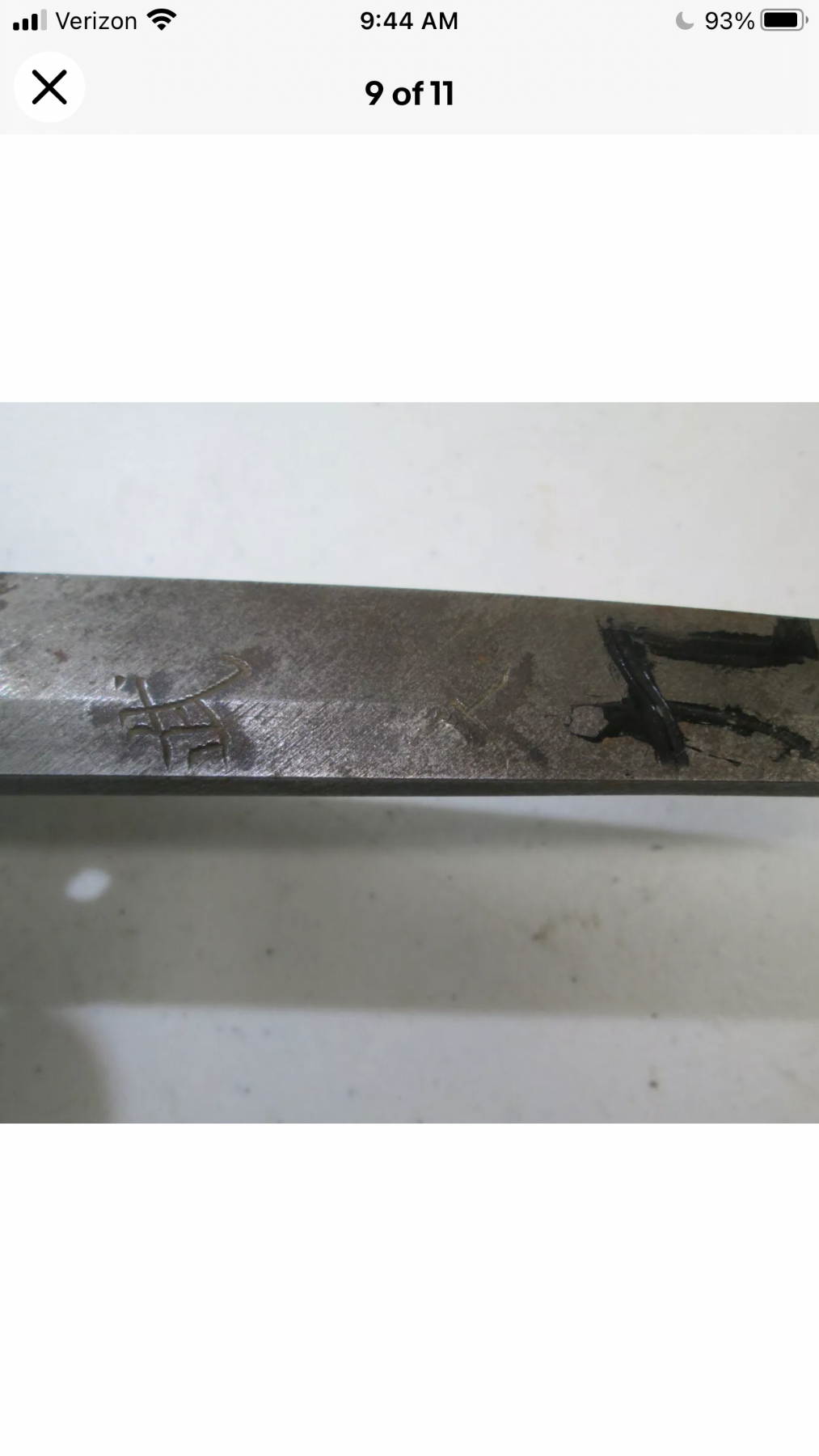

Swords Posted November 16, 2021 Report Posted November 16, 2021 Hi I have this sword blade probably needs a polish dose anyone know what the w on the tang stands for and any info about this smith and date Quote
Bruce Pennington Posted November 16, 2021 Report Posted November 16, 2021 You can read all about the "Mysterious 'w' stamp" HERE. The short version is it's most likely an intermediate/half-way inspection stamp. An army reg found by @Kiipu says as much. The smith is Takehisa, who is one of 8 recorded smiths with the stamp, not counting all the Mantetsu blades with it. Your date is Autumn 1943. Quote

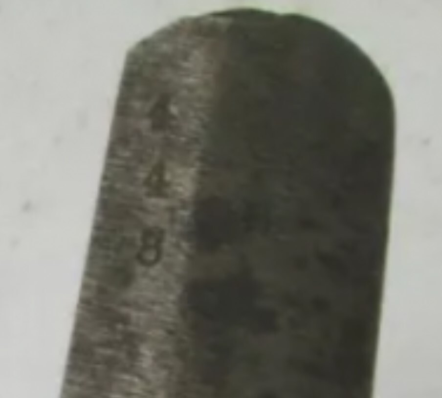

Bruce Pennington Posted November 16, 2021 Report Posted November 16, 2021 Also, Steve, you HAVE to get me a clear shot of that number at the end of the nakago!!! Is that "811"? Can you contact the owner for a better photo? If not, can you give me a link? I hope I don't sound desperate ....... I HAVE TO HAVE THAT NUMBER!!!! Ok, calming down..... Ha! But I would appreciate it. Quote
Swords Posted November 16, 2021 Author Report Posted November 16, 2021 10 hours ago, Bruce Pennington said: Also, Steve, you HAVE to get me a clear shot of that number at the end of the nakago!!! Is that "811"? Can you contact the owner for a better photo? If not, can you give me a link? I hope I don't sound desperate ....... I HAVE TO HAVE THAT NUMBER!!!! Ok, calming down..... Ha! But I would appreciate it. No numbers is this sword worthy with the w and smith Quote

Ooitame Posted November 16, 2021 Report Posted November 16, 2021 @Bruce Pennington in the first picture the number is 448. 1 Quote

ChrisW Posted November 16, 2021 Report Posted November 16, 2021 He's a known showato smith. It isn't known if he made gendaito or not. The W-stamp is not exclusively linked to just Mantetsu blades; there is a small list of smiths who have this W stamp. The prevailing theory that Bruce has produced is that it is a midway inspection mark of some kind. Here is Bruce's thread on the W-stamp: To see if it is gendaito or not, you'll have to show that there are no characteristic dark peaks that are a result of the oil-quenching process while finding evidence of hada. These are questions best left for a togishi or someone with a lot of experience in these wartime blades to answer. However, the odds are not in favor of it being gendaito simply by the fact that he is a known showato smith and no known gendaito are documented to his name. Incidentally it seems all known blades to his name are marked 1943 and none were shown to be gendaito. If you are thinking of purchasing this blade and the decision hinges on gendaito or not, my gut says it is likely not. But again, a decision that is best left to a togishi or someone specialized in these wartime blades. You could perhaps get more pictures of the nagasa and see if you can show details of the hamon? Capturing some evidence of hada would also help with showing it is more likely to be gendaito. Try under the habaki where there may be a higher chance of less surface corrosion/buildup. Quote

Bruno Posted November 16, 2021 Report Posted November 16, 2021 Smith seems to be TAKEHISA, average showa-to/gendai-to maker. http://www.japaneseswordindex.com/oshigata/takehisa.jpg The W stamp is often found on his blades. Quote

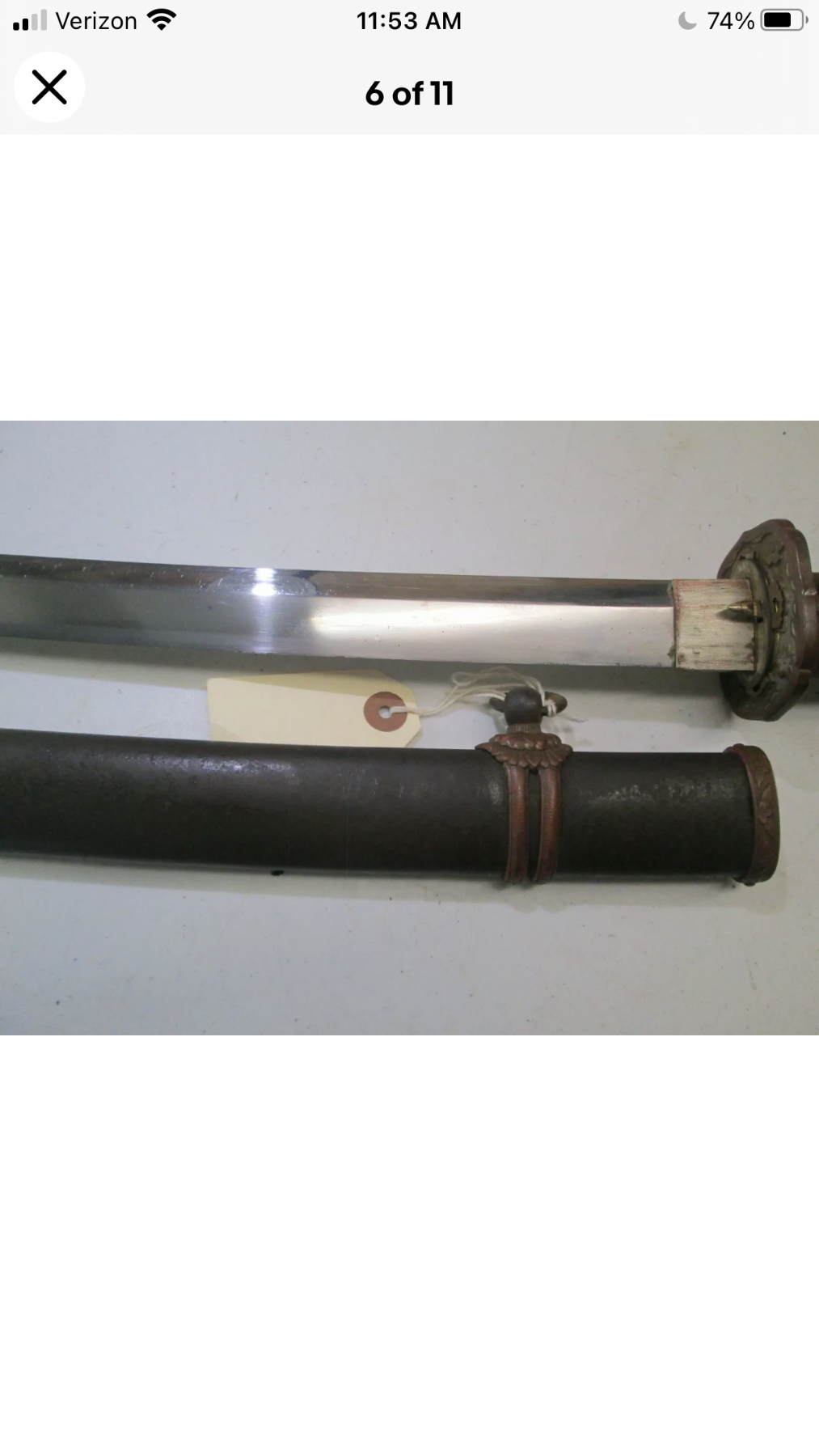

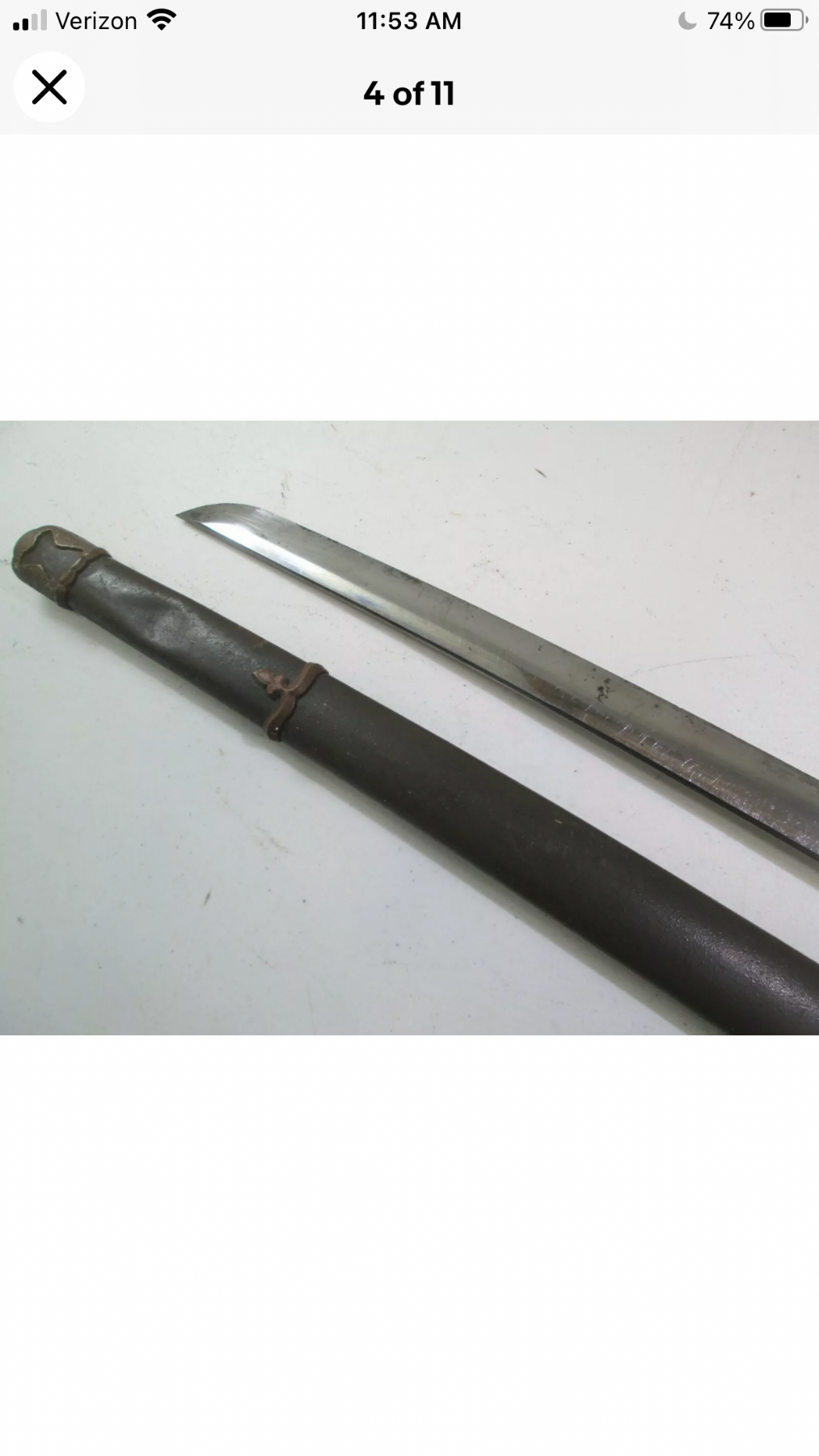

ChrisW Posted November 16, 2021 Report Posted November 16, 2021 Without more photos showing clear activity in the steel (hada and hamon) and a lack of dark peaks in the hamon, it cannot be called a gendaito. You would be best to error on the side of caution and believe that this is a showato. If you want a more ironclad judgement, you could always speak to a togishi or visit a swordshow. If you want more opinions from the folk here, you need more photos showing the steel up close. Quote
Swords Posted November 16, 2021 Author Report Posted November 16, 2021 Thanks everyone As I see these pictures I don’t see an active hamon for a Gentai Also dark areas ! this and others opinions point to a Showa Oil quench blade steve Quote

Bruce Pennington Posted November 17, 2021 Report Posted November 17, 2021 10 hours ago, Ooitame said: @Bruce Pennington in the first picture the number is 448. Thanks Eric, you're right. @Kiipu - notice the orientation!!! Ha! First one I've seen stamped vertically with blade tip down! 1 Quote

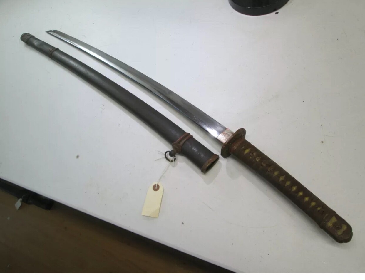

PNSSHOGUN Posted November 17, 2021 Report Posted November 17, 2021 The first picture is a completely different sword, it's a Zohei-To. 1 Quote
Bruce Pennington Posted November 17, 2021 Report Posted November 17, 2021 1 hour ago, PNSSHOGUN said: The first picture Good catch John! 2 different nakago! Quote
ChrisW Posted November 17, 2021 Report Posted November 17, 2021 6 hours ago, PNSSHOGUN said: The first picture is a completely different sword, it's a Zohei-To. Something is rotten here! Good catch! Quote
