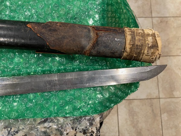

Thanks for letting me join. Looking for a little help to identify a Japanese katana.
The limited info that I have is that this was obtained by a US Army Lieutenant who served as an artillery officer in the Pacific Theatre from 12/41 through 8/45.
I am working on obtaining additional info but this is all I have at the time. Would appreciate any information
Thank You.

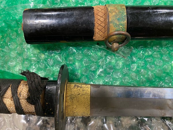

As Chris says, the fact it has three mekugi-ana most likely means it's been refitted at least once into new fititngs so is most likely an older blade.
I like the sword in general, it's one I'd pick up myself.
The Tsuka (handle) looks long as does the blade.
Nice Sword

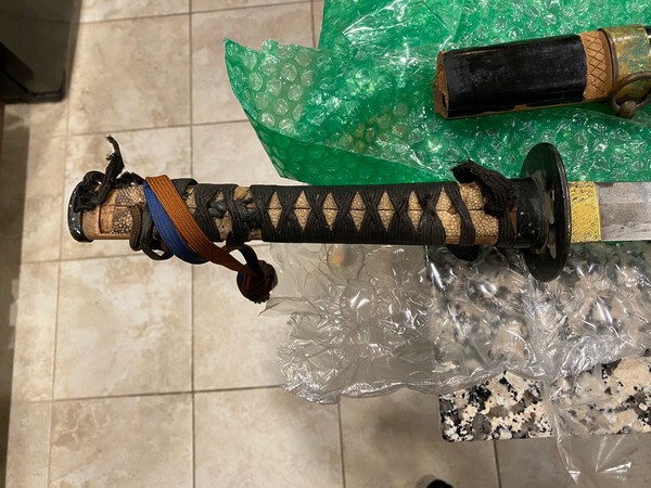

Personal take on this, an older blade remounted in Showa era civil mounts (Saya has cross hatching in the Kurikata slot which I have not seen on older damaged saya) then taken to war.
 The tosogu could be any age from late Edo to Showa. Replacing the organic parts is fairly common especially on a sword intended for use either for cutting or Iaido.
