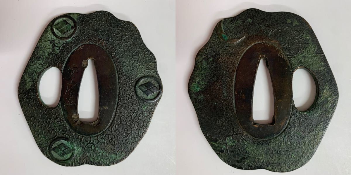

GRC Posted November 5, 2021 Report Posted November 5, 2021 Sorry to double dip in topic heading because it's two totally different topics, but I need help with both. I tried to figure out the mei on this kinko piece, but had no luck at all. Here's it is: a kawari fist shaped tsuba, entirely soft metal, copper base with a bronzy-black finish (shakudo maybe?), it has a karakusa design on the front with the Takeda family mon, while the back has general texturing along with a moon, boat, waves and wind incorporated in the design: These two images are really oversaturated with light just to make the mei as clear as possible. It originally had more green corrosion on it (see below), but I gently rubbed a lot of it away with mild soap and water. Does anyone have any suggestions, other than to keep at it with the gentle soap treatment? Thanks! Quote

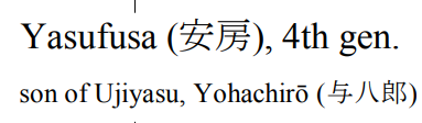

kyushukairu Posted November 5, 2021 Report Posted November 5, 2021 The mei looks like ‘Yasufusa’ (安房). I had a quick look in the meikan and it seems there was a smith by that name who was a student of Yasuchika. However, as can be seen in the attached image, the style of the kanji is slightly different and there is no kao to compare. With regards to the oxidisation, I have had a low-grade shakudo tsuba with some light patina issues like that in the past and the application of choji oil cleared it away. However, you may want to seek the advice of those with a background in metalwork before using choji, just in case it has any detrimental effects upon the integrity of the metal. Quote
GRC Posted November 5, 2021 Author Report Posted November 5, 2021 Thanks Kyle!!! That reading of Yasufusa helps a lot. I just checked Sesko's Genealogies of Japanese Tsuba Artists, and there's a Yasufusa listed as 4th gen of the Awa Shoami (aka Hirata school). If I extrapolate from the dates that are there, I'm guessing late 1600s, early 1700s, because the 6th gen is listed as 1721-1762. The seller also referenced "Awa" province, but I didn't make the connection until now. And apparently the 1st-4th generations worked primarily in soft metals like "shinchu plate" (copper with zinc = brass I think), whereas 5th gen and onwards used mostly iron plate. Actually, here's a whole past post about Awa Shoami on NMB from 2014: Quote
Ford Hallam Posted November 5, 2021 Report Posted November 5, 2021 To be blunt, this tsuba bothers me. I would suggest disregarding the mei for starters as it really bear no similarity to the meikan examples and doesn't really even look all that confident on its own terms. The kara-kusa pattern appears to be etched as does the reverse and while we do see etched designs in some work, Jakushi and a few Higo pieces...it's not really that common. My general impression is that this is a work by an amateur, quite possibly modern. As to oil on verdigris, well it wont remove or eliminate it at all. It may conceal it by making the green less visible as it is soaked by the oil but the corrosion continues. In fact as oil is essentially a fatty acid this in combination with the copper present acting as a catalyst the corrosive effect is accelerated, resulting in a product conservators call copper soaps. Incidentally, Ibota wax, when it inevitably breaks down, causes the same problems. So I'd suggest not oiling soft metal, or even iron for that matter. 2 1 Quote
GRC Posted November 6, 2021 Author Report Posted November 6, 2021 Thanks for the information about not using oil with soft metal. If that is to be avoided, can you suggest an alternate remedy for the verdigris, or at least something to stop its progression? I can definitely see the etching method being used for the pattern on the front and back. The moon is definitely inlayed because it is made of a different metal. It looks like silver, now that I have cleaned it some more. I would also guess that the three mon were either carved or inlayed because of their sharper outlines and height above the rest of the design. I quite like many of the etched tsuba designs that I have seen, although all the examples I have seen were in iron, not soft metal. An etched design definitely gives off a more "painterly" effect to the design, given that whatever "resist" had to be applied (by brush I assume?) onto the plate before etching. It's precisely the "unusualness" and "painterly quality" of this piece that caught my attention to begin with. As artisans, wouldn't many tsubako have experimented with etching at some point in their careers? Exploring different methods and techniques to see what they could produce with it. Amateur or not, there's still a hell of a lot of work that went into this piece, and I'm happy to have it. 1 Quote

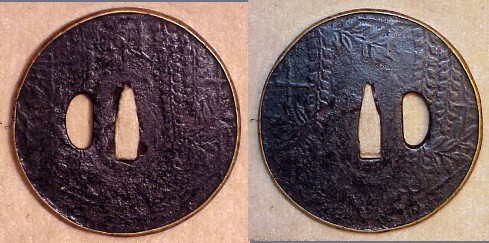

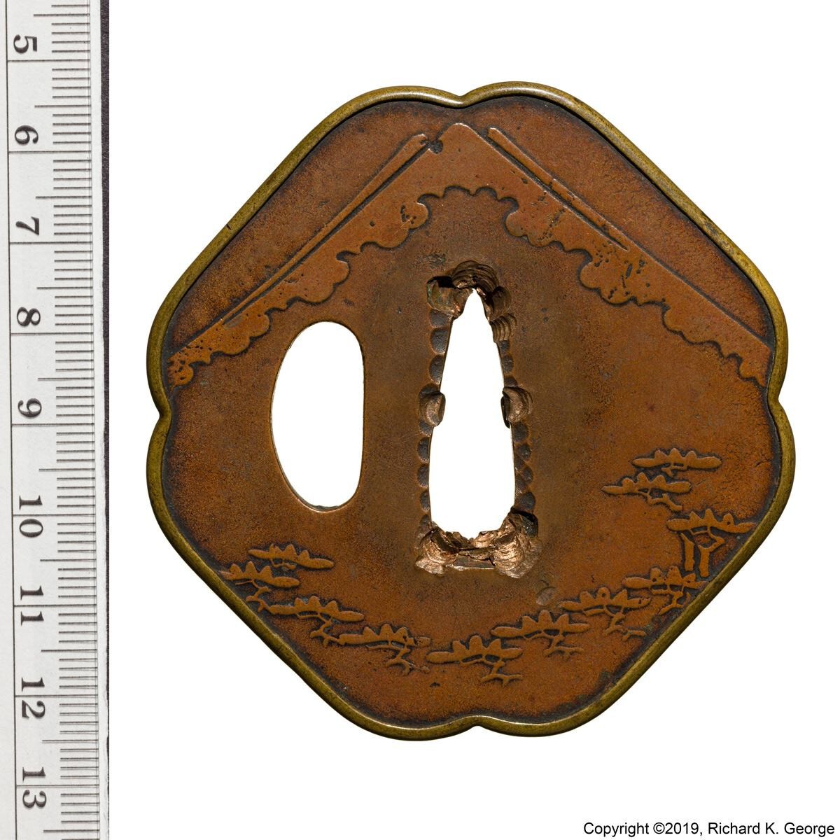

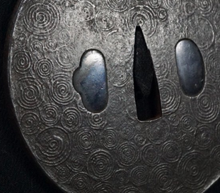

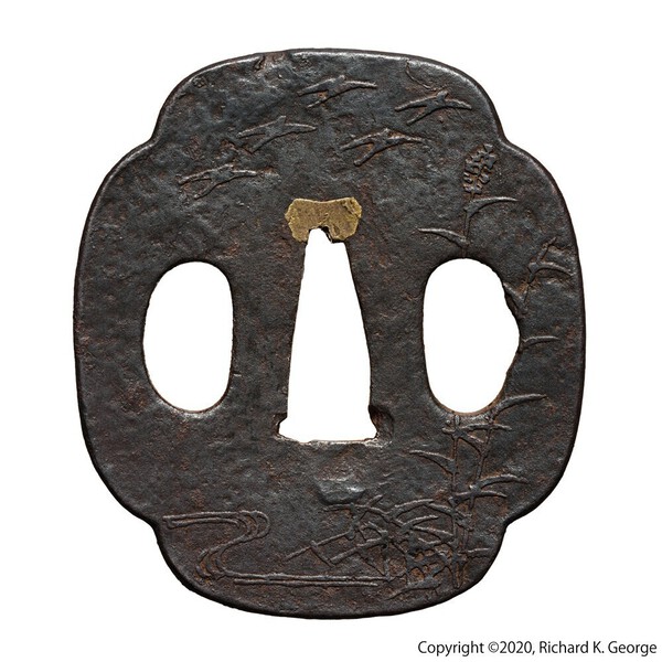

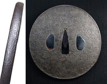

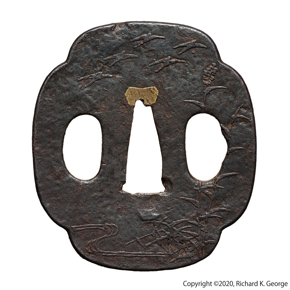

GRC Posted November 8, 2021 Author Report Posted November 8, 2021 On the topic of etching, here's a few images for some eye candy: The first two are etched for sure, but I'm not certain about the last two. Here's a nice etched kinko piece from Richard George's (RKG) collection. Accidentally stumbled across it in the ancient "udenuki-ana" thread (which is an interesting read). And here's a mumei iron one that was on YahooJ not long ago: And here's two other ones that I suspect might be etched, possibly etched then chiseled, but not 100% certain... 1st is mumei, 2nd is a Jakushi (ura side). 1 Quote

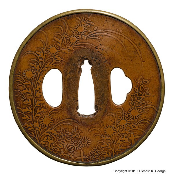

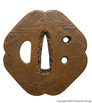

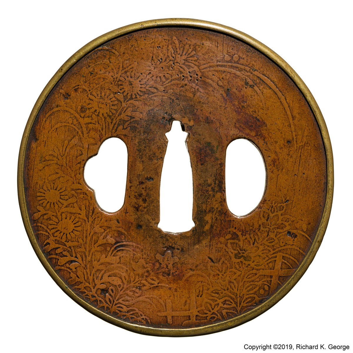

GRC Posted November 8, 2021 Author Report Posted November 8, 2021 Here's some more etched tsuba rom Richard's (RKG) collection: Thanks for sharing! If anyone else has some etched examples, feel free to post em Quote

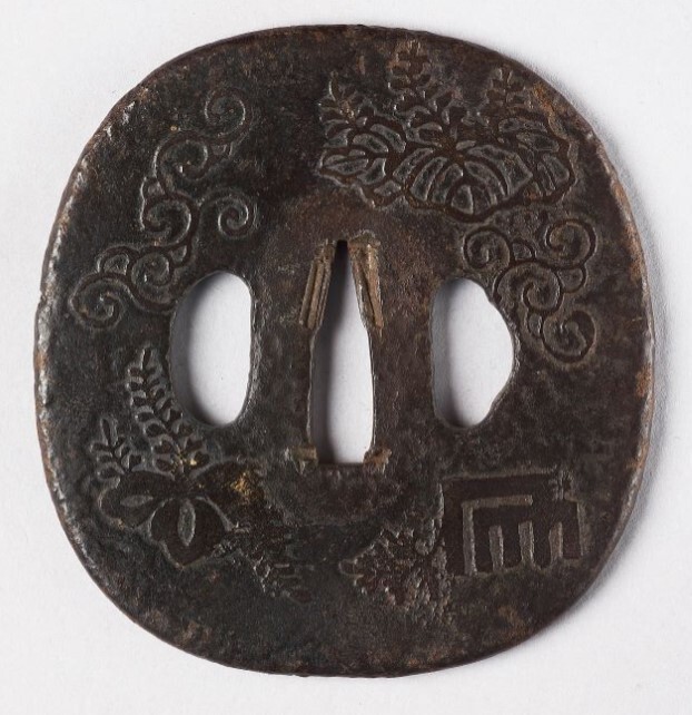

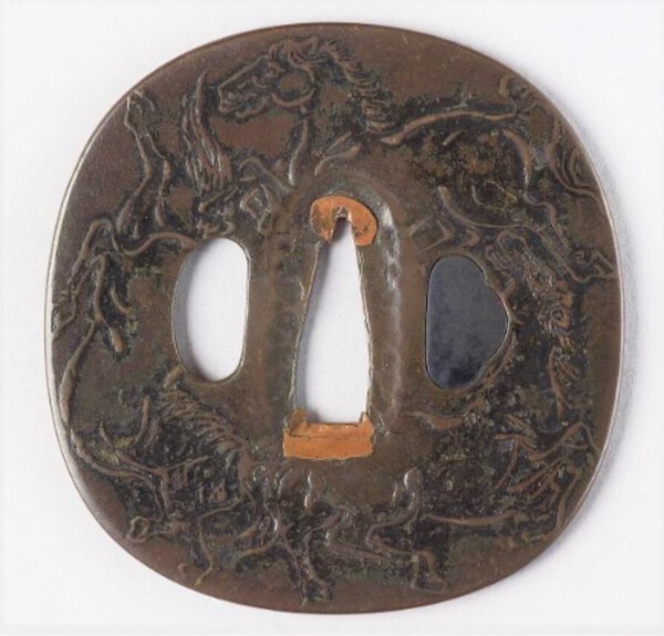

GRC Posted November 10, 2021 Author Report Posted November 10, 2021 and found some more etched tsuba in the Met gallery... This one also has some inlays on the omote and is 16th century according to the Met: looks like some kind of water wheel and stream on the back... hard to make out the details. And another one... horses and a willow tree and one more... this one has very cleanly executed etching Quote
Iekatsu Posted November 10, 2021 Report Posted November 10, 2021 Glen, The first example in your last post is actually a Kagamishi Tsuba, its cast bronze, not etched. 1 Quote
