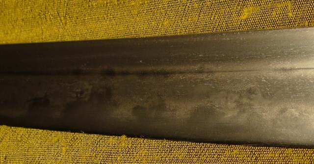

oristt Posted February 16, 2009 Report Posted February 16, 2009 Hello all, Can anyone tell if this mark/stain could be removed with out the need of a polish? Thanks for your time kind regards Kyle Quote
pcfarrar Posted February 17, 2009 Report Posted February 17, 2009 Do you mean the black patches? Looks a bit like core steel. Need a better picture really to see what you mean. Quote
Bugyotsuji Posted February 17, 2009 Report Posted February 17, 2009 When you do take the new piccies, place an indicator pointing to the particular feature you are concerned about! Quote
oristt Posted March 1, 2009 Author Report Posted March 1, 2009 Hello everyone, I have some more photos of the mark/stain in question. As you all know its so very difficult to photograph the blade but practice makes perfect :lol: The mark i am talking about is the dark stain in the middle of the blade on the first photo, and the light stain on the 2nd 3th photos is very difficult to see on the last two photos. Thanks for looking please feel free to comment DSC02444.pdf DSC02443.pdf Quote
Grey Doffin Posted March 1, 2009 Report Posted March 1, 2009 Hi Kyle, The dark mark in the 1st photo and in the other photo I looked at is shin-tetsu, core steel showing through. Surprising that it shows black in one photo and white in the others. Black is what I'd expect for shin-tetsu. Considering the bad kizu nearby in the picture it isn't surprising that the blade is tired. No cleaning or polish can help, and it doesn't really make sense to spend money on a blade in this condition anyway. Sorry for bad news. Grey Quote
Ronin 47 Posted March 2, 2009 Report Posted March 2, 2009 I don't think that's shin-tetsu but rather Tobiyaki or Yubashiri. I would get a magnifying glass and see if its made up of nie. Austin Quote
Mark Green Posted March 2, 2009 Report Posted March 2, 2009 I agree with Austin, I don't think it is core steel. What age is the sword? Very likely Tobiyaki. Mark G Quote
nagamaki - Franco Posted March 2, 2009 Report Posted March 2, 2009 tobiyaki, yubashiri , hmm , Grey, has it correct, shin tetsu, a tired sword. Quote
Guido Posted March 2, 2009 Report Posted March 2, 2009 Yup, Yubashiri for sure. Probably mixed with meteorite iron, and I'm convinced it glows in the dark. And if you close your eyes and concentrate real hard, you can hear the Yubashiri singing .... Quote
Ted Tenold Posted March 2, 2009 Report Posted March 2, 2009 I don't think that's shin-tetsu but rather Tobiyaki or Yubashiri. I would get a magnifying glass and see if its made up of nie.Austin Austin, nie of even the finest type can be seen with the naked eye. Now *glasses* may be needed, but a magnifying glass on shintetsu will only magnify the shintetsu. Kyle, sorry buddy, but this is clearly shintetsu. The first clue is the lack of any real "life" to the steel. But a larger clue is the fact that in the ji, and shinogi there is a profuse amount of ware and course grain coming through. Quote

Ronin 47 Posted March 2, 2009 Report Posted March 2, 2009 Well I maybe wrong but in the first picture to the left of the so called shin-tetsu, I think I can see a profuse amount of ji-nie, and in my experience nie looks white and shiny in direct light and like black diamonds in indirect light so that's why I thought it could be Tobiyaki or Yubashiri (Yubashiri is a rare occurrence to say the least so in that regard I probably misspoke and should have just stated Tobiyaki). Also I know nie can be seen with the naked eye but it might be hard for a beginner to see the individual crystals and that's why I recommended the magnifying glass. Also in the other two pictures the so called shin-tetsu has a very white and shiny look to it like nie, which led me to that conclusion.Once again I could be wrong but I would like better pictures before jumping to any final conclusion either way. Austin Quote

Mark Green Posted March 3, 2009 Report Posted March 3, 2009 Hi gang, In this picture is a sword with a similal looking 'mark'. dark colored area, that in another light/angle looks shiny. This I'm pretty sure is Tobiyaki. You can also follow the nice fat patch of Nie moving into the area of Tobiyaki, common for this fault. In the first pic that started this question, it looked very much like the sword seen here.(imho) The area on the subject blade may indeed be core steel, I for one would need better pics to say for sure, again, mho. Just a thought. Mark G Quote
reinhard Posted March 4, 2009 Report Posted March 4, 2009 Mark, I see your point, but the pic starting this thread is quite different from your example. Yubashiri and tobiyaki are no flaws per se and can be part of the ToKo's style, but the blade in question shows isolated patches of core-steel. Together with open grain they indicate an worn, over-polished blade. What really worries me, is the question at the beginning: "How to remove this kind of "stain" without (having to pay for) polishing. This does not only show a fundamental lack of knowledge (which could be excused) but a strange attitude towards Nihon-To in general. What makes NMB a difficult place at times is the "trinity" of dusty armchair-experts, who never left their homes, citing from their limited (and sometimes outdated) stock of books as if it were the holy bible, semi-educated dealers with intent to keep their clients as ignorant as they are themselves, using this board as a freeware pit-stop for translation and information and trying to define terms newly, if necessary, and finally, newbies, who can't cope with the idea of Nihon-To being a more complex subject than just a romantic Samurai myth. I can well understand Guido, Ted and others, who dedicated many years or decades of their lives in order to come close of understanding Nihon-To, loosing their temper every now and then when confronted with one of the specimens mentioned above and, even worse, when members of the "trinity" try to build an unholy alliance against competence. Since ignorants are not allowed to be shot in the forehead anymore, sarcasm is is the only way left to face them. Anway, this talk will go on forever and I really wish, the knowledgeable heads on this board won't lose patience, for NMB still has a chance of being a good thing. reinhard (prepared for eternity>attachment) Quote
