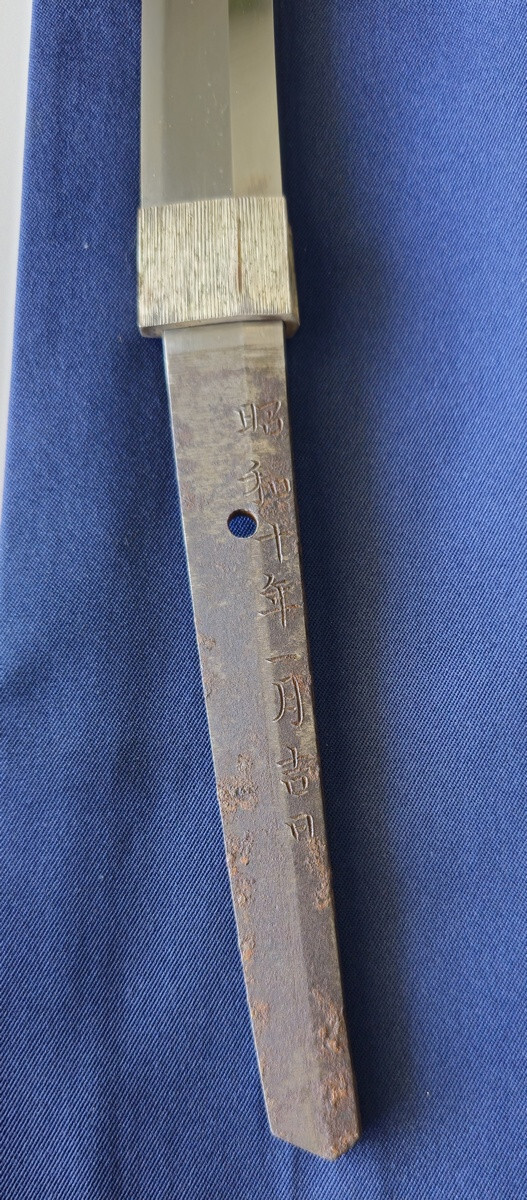

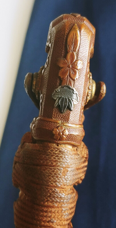

Ed Posted November 28, 2021 Report Posted November 28, 2021 Kajiyama Yasunori. Custom ordered for Colonel Matsuda, 7th Airfield Engineers. Original linen bad and surrender tag. His name scratched onto the saya. 4 4 Quote

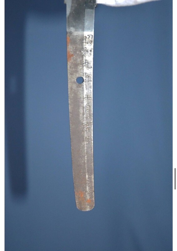

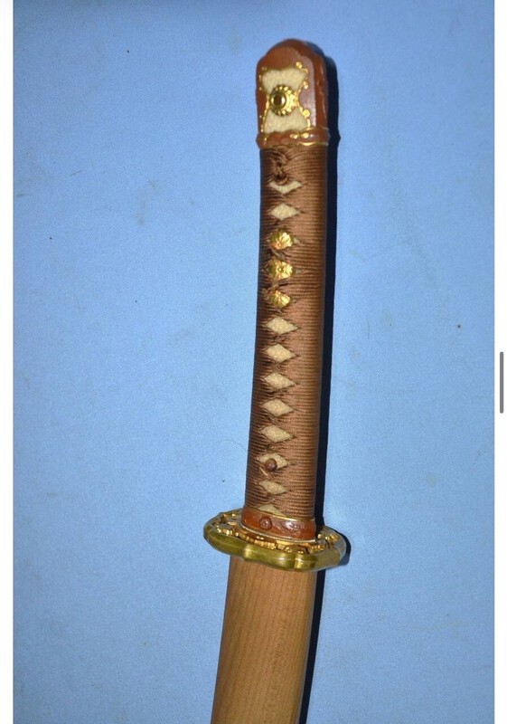

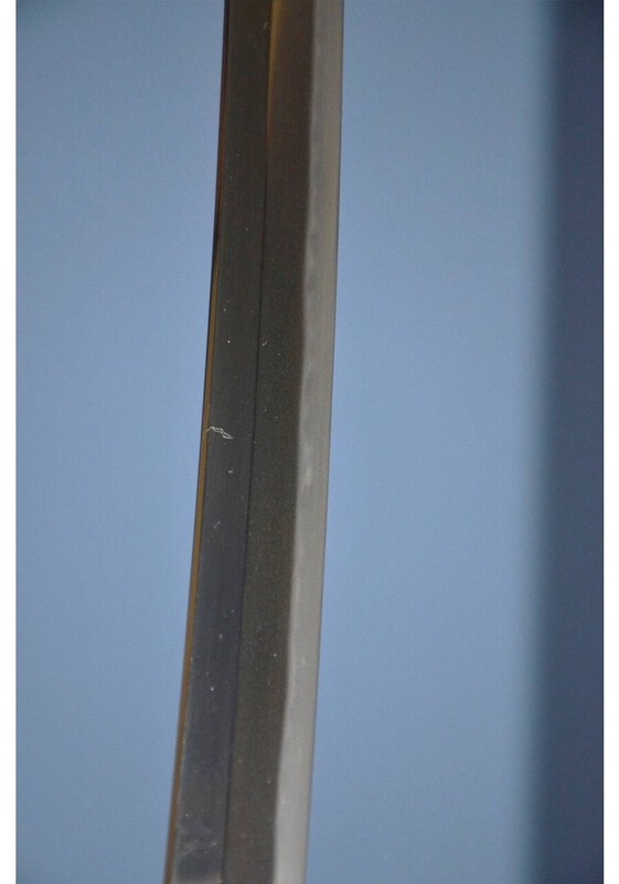

Karu Posted December 23, 2023 Report Posted December 23, 2023 Received this beauty from aoiart yesterday, had to share. Photos here : https://imgur.com/a/7Cuq5YM Kotani Yasunori 靖憲 Showa 11 Nen 10 Gatsu Kichijitsu 昭和十一年十月吉日 (October 1936) Desc from aoiart : Blade length: 69.2cm (27.2in) Sori:1.8 cm or 0.7in 780g Shape: This work is longer than normal Yasukuni sword and looks very powerful. Jigane: Koitamehada is grained well. Hamon: Niedeki Gunome midare with Choji, you can see Sunagashi and Kinsuji in the blade. With gunto koshirae 3 2 1 Quote
Volker62 Posted December 23, 2023 Report Posted December 23, 2023 congrat's Carl what a beauty, thank you for sharing! Quote

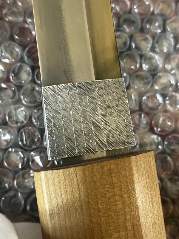

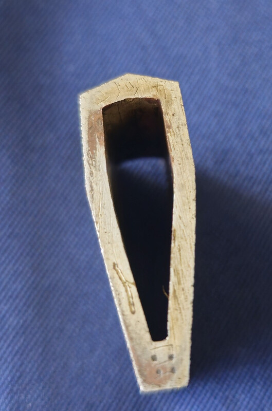

Bruce Pennington Posted December 23, 2023 Author Report Posted December 23, 2023 Yes, gorgeous! @Karu - Carl would you mind posting a nice photo of that habaki? Looks like an interesting design. Quote
Karu Posted December 29, 2023 Report Posted December 29, 2023 On 12/23/2023 at 2:58 PM, Bruce Pennington said: Yes, gorgeous! @Karu - Carl would you mind posting a nice photo of that habaki? Looks like an interesting design. Thank you very much, Here you go + here : https://imgur.com/a/qFmrOSC 1 Quote

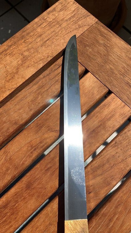

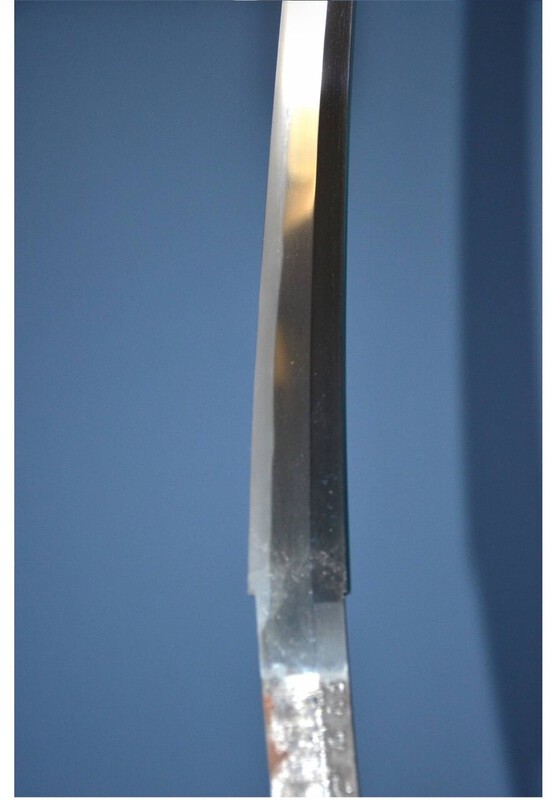

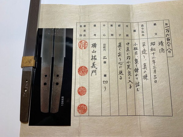

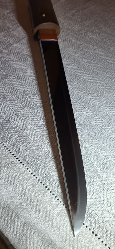

Volker62 Posted December 29, 2023 Report Posted December 29, 2023 Rare early Tanto by Kajiyama Yasunori/ Yasutoku one of the leading smith at Yasukuni papered in original war time polish "there are also few rare pieces in German collections, that we can be proud of 3 3 1 Quote
Bruce Pennington Posted December 29, 2023 Author Report Posted December 29, 2023 Thanks Carl! A combination of the angled file marks plus straight lines. Nice silver work, too. 1 Quote
Guest Simon R Posted December 30, 2023 Report Posted December 30, 2023 12 hours ago, Volker62 said: Rare early Tanto by Kajiyama Yasunori/ Yasutoku one of the leading smith at Yasukuni papered in original war time polish "there are also few rare pieces in German collections, that we can be proud of Absolutely exquisite, sir! If I was to have one last blade in my lifetime, that would be the one I'd choose. Quote

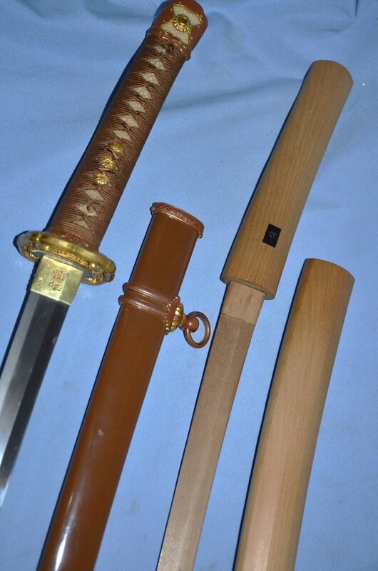

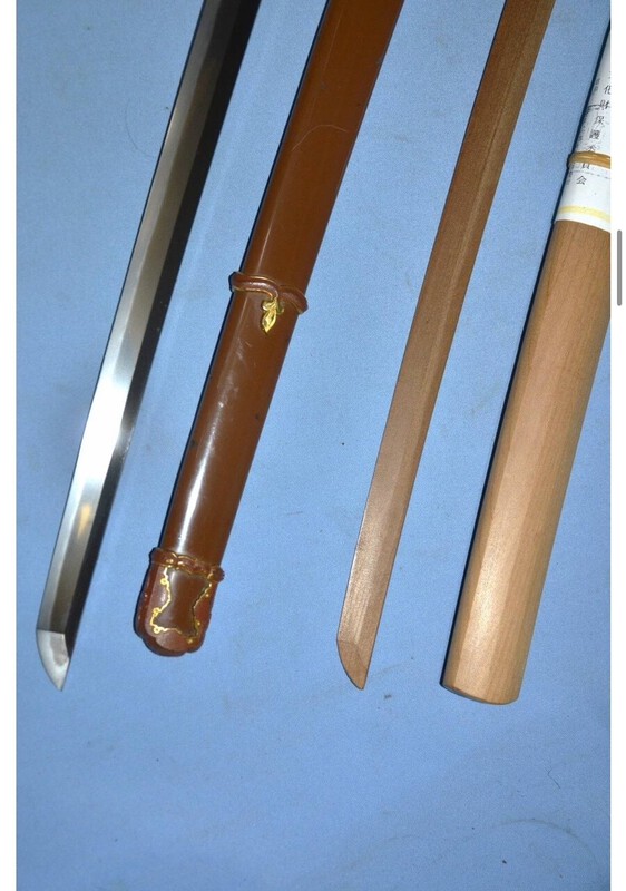

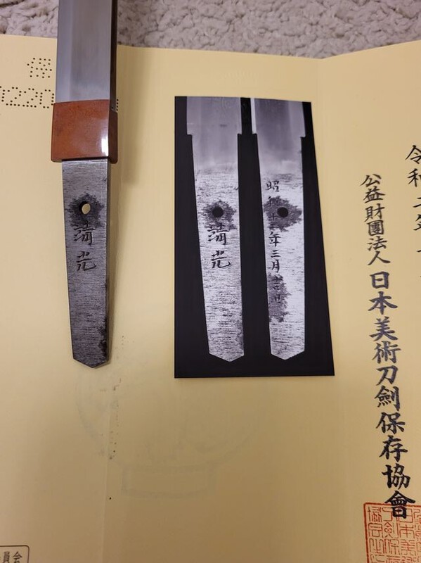

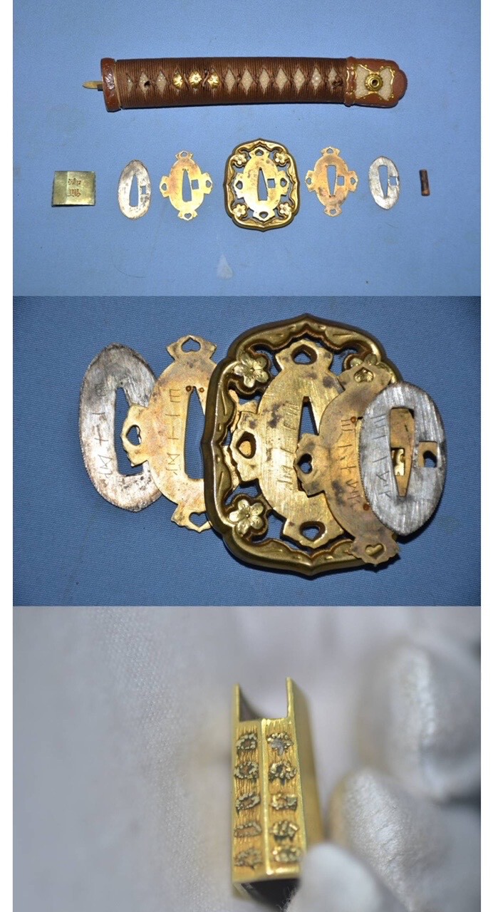

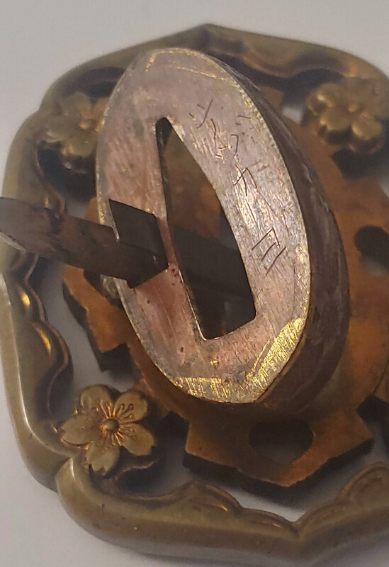

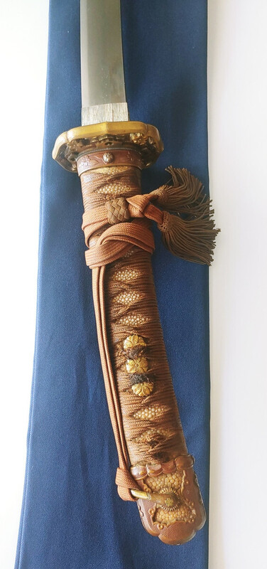

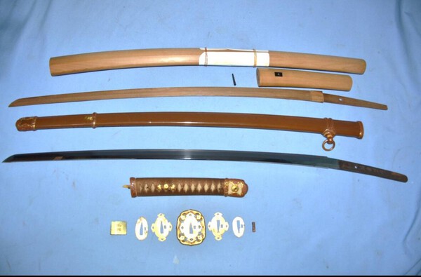

PNSSHOGUN Posted December 30, 2023 Report Posted December 30, 2023 Ikeda Yasumitsu January 1935 Original mounts and brown tassel, all fittings are marked with "Shinozuka" and made by the Suya Shoten company. This includes the solid silver Habaki, which is odd to see marked. 3 2 Quote
Guest Simon R Posted December 30, 2023 Report Posted December 30, 2023 1 hour ago, PNSSHOGUN said: Ikeda Yasumitsu January 1935 Original mounts and brown tassel, all fittings are marked with "Shinozuka" and made by the Suya Shoten company. This includes the solid silver Habaki, which is odd to see marked. Where do you find these wonderful treasures, John?! (Why do you think the brown tassle, may I ask?) Quote

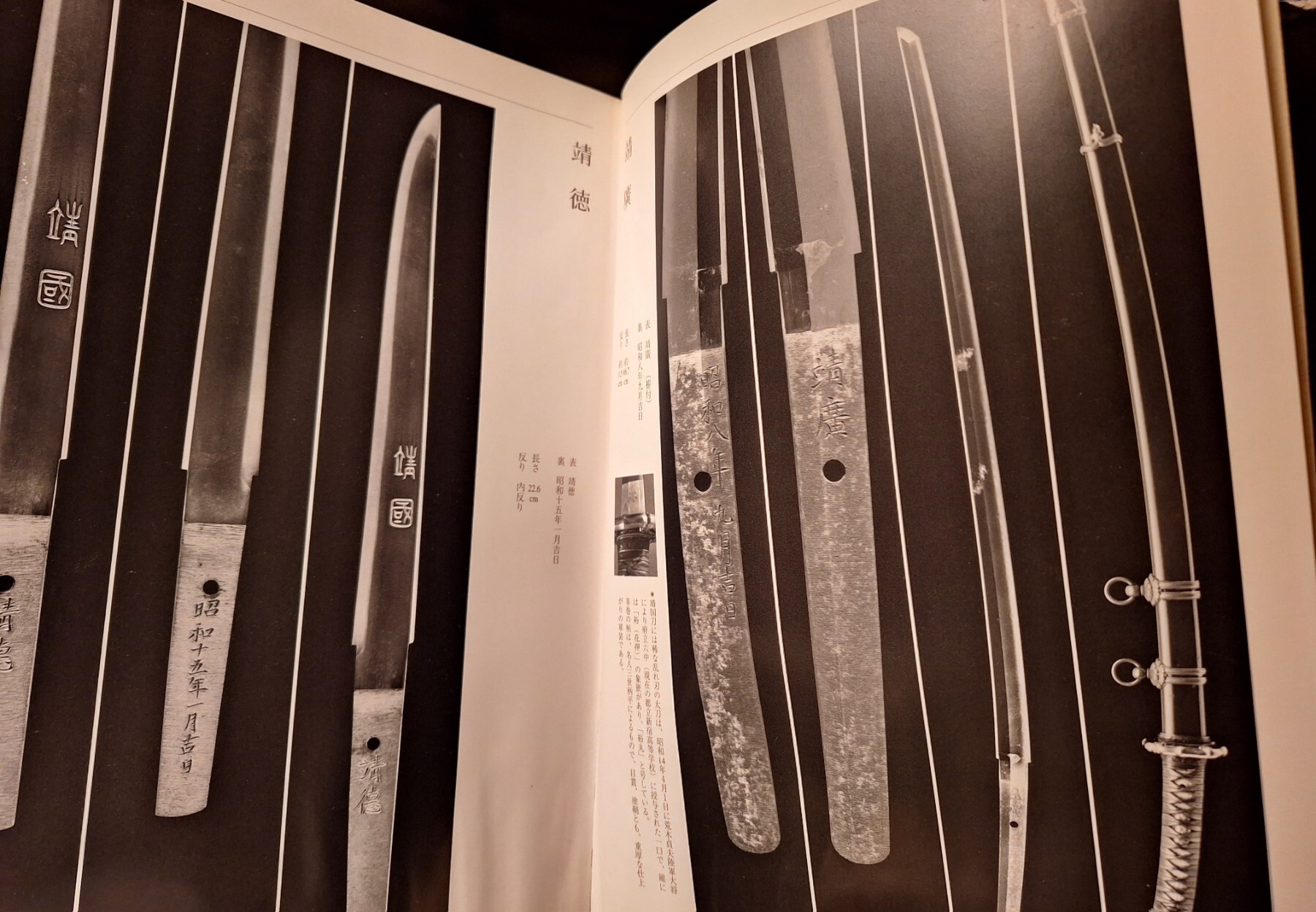

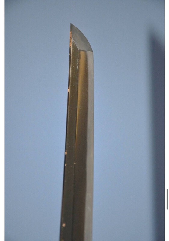

Volker62 Posted December 30, 2023 Report Posted December 30, 2023 to make this Topic more complete rare early (before the start of war) papered Tanto by Ikeda Yasumitsu in mint condition 1 1 Quote

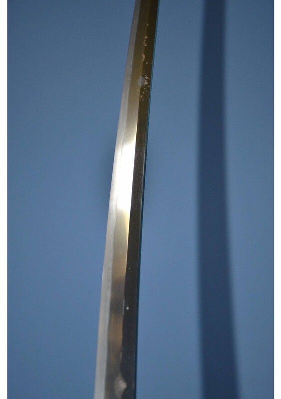

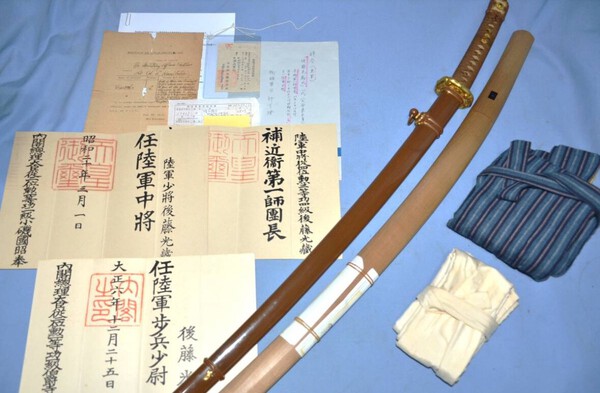

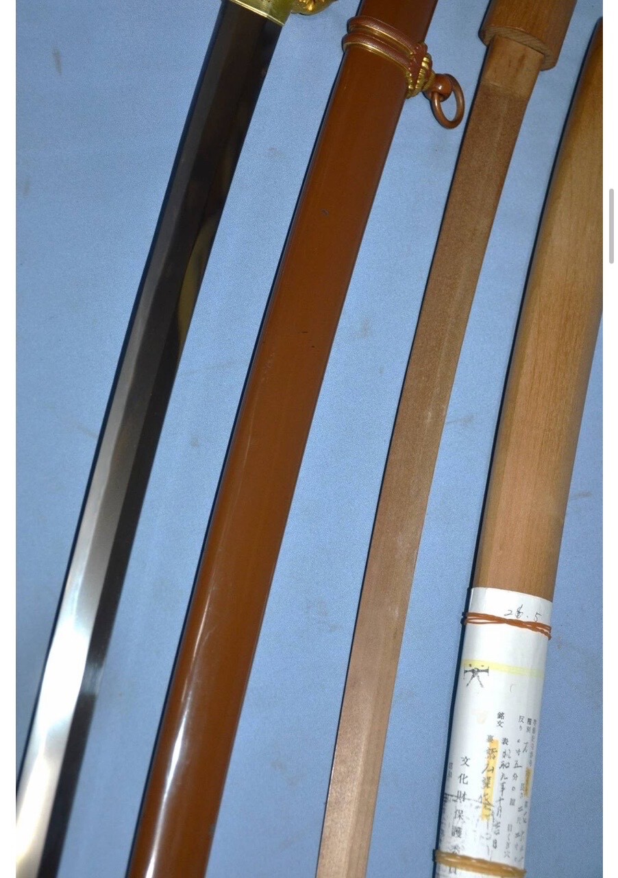

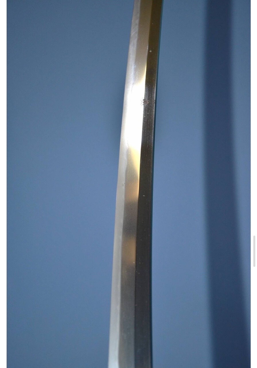

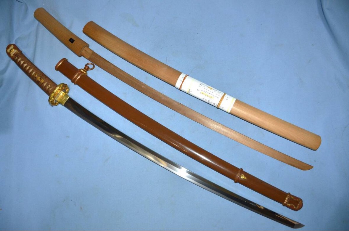

Guest Simon R Posted January 1, 2024 Report Posted January 1, 2024 This current auction appears to be for an imperial gift Yasukunito made by Yasuhiro for Lieutenant General Kozo Goto of the 1st Division of the Imperial Guard. Very interestingly, it also comes with a lot of paperwork - including a "Certificate for Private Keeping of Arms" issued in November 1945 (Although the keeper is named as a Lt Col. Kunitake). https://page.auction.../auction/n1119395672 The blade almost seems to have a Heian Sugata and, despite having some rust and definitely needing a re-polish, is a beautiful blade as you would expect. I'd be interested to hear what other members think and Brian @Brian please feel free to move this to the general military sword section as a separate topic if you feel it better presented that way. Quote
Guest Simon R Posted January 1, 2024 Report Posted January 1, 2024 More pictures from the auction. (Sorry if I've repeated any.) Quote
oli Posted January 1, 2024 Report Posted January 1, 2024 there i also a Yasunori Tanto as imperial gift: https://www.nipponto...swords9/TT329049.htm Regards Oli 2 Quote
Volker62 Posted January 1, 2024 Report Posted January 1, 2024 Hello Oli Happy new year to you and those you hold dear...! I don't think that the Tanto from "Nipponto" the link you depicted here is an imperial Gift. The yasukuni toshu made after Tom Kishida's book (page 71) those Tanto, (Onkashi To) for the Navy staff collage from 1941 on, this was Hori Toshihide who was an appointed smith to the collage, had to become ill. The Tanto which was made from 1941 by the Yasukuni smith were also signed with (kin saku) beneath its Mekugi ana. The Tanto offered by nipponoto has a very early date and has a longer nagasa than the others made at 1941 as Onkashi to.! Please refer Tom's book page 71.! The earlier Tanto, (before 1941) which are very very rare, are mostly ordered by high ranking Officers, also according to the reasearch of the honorable Mr. Han Bing Siong. 1 Quote
oli Posted January 1, 2024 Report Posted January 1, 2024 Hi Volker, happy new year! And thanks for your information. Sadly i dont have the Yasukuni-to book, its soled out. thank you Oli Quote
