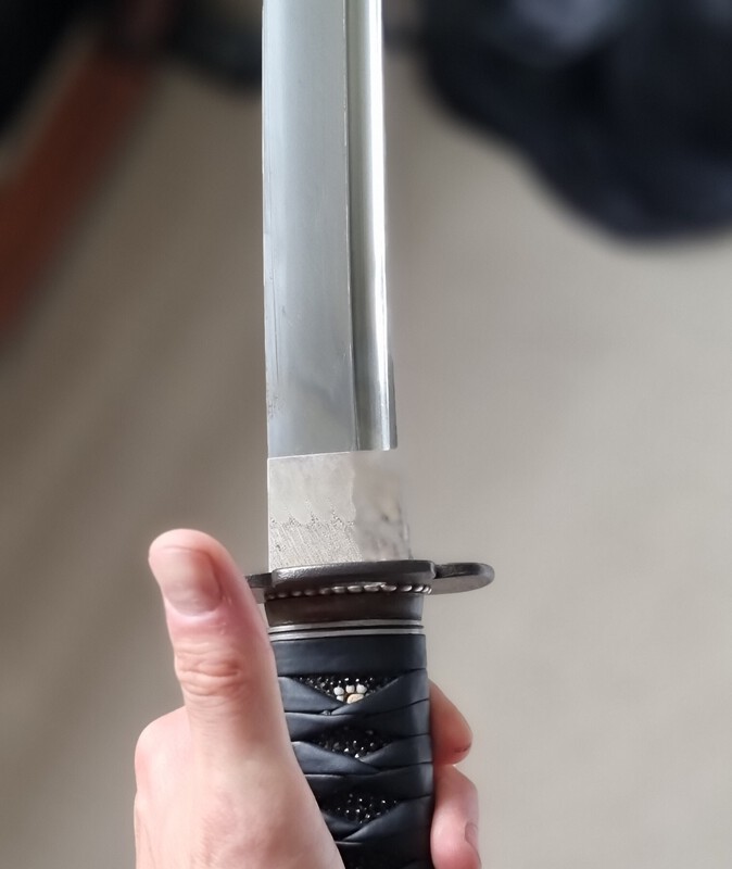

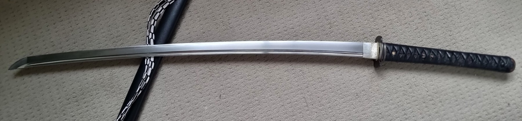

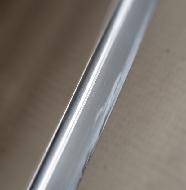

jeremy Posted October 28, 2021 Author Report Posted October 28, 2021 On 10/28/2021 at 3:45 AM, Bruce Pennington said: We thrive on pictures, Jeremy. None of us really like reading, it's just a path that gets us to the pictures! Expand Sure. It's only a training blade , so it's not in an art polish. But I'll post some pics nonetheless 1 Quote
jeremy Posted October 28, 2021 Author Report Posted October 28, 2021 Nothing much to see. It's in user polish but I bet this blade would be absolutely stunning if ever polished , nice itame hada and suguha hamon. But the bohi is very well done. The whole sword weighed 1345 grams with koshirae without saya , now it weighs 1174 grams. 2-6-5 length. Alot easier to use with my aging sore arms! 2 Quote
