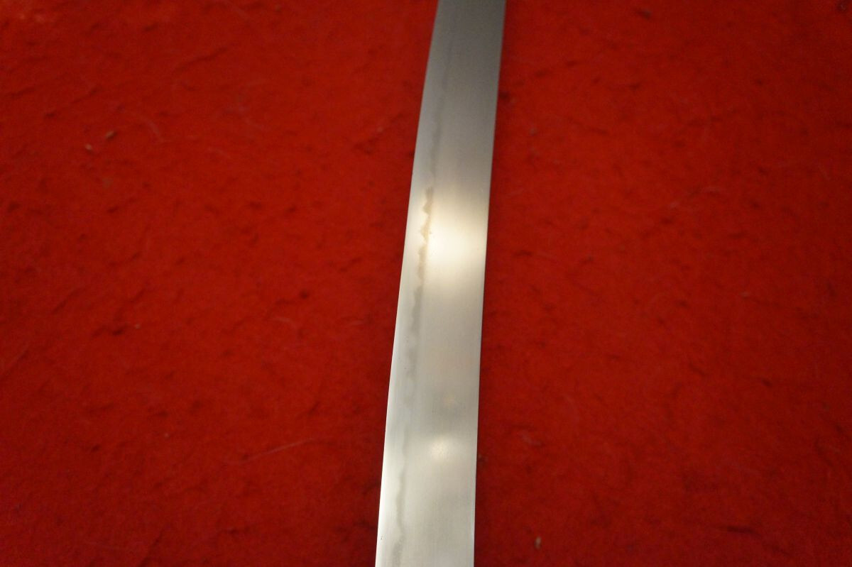

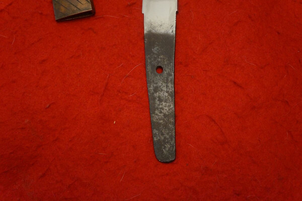

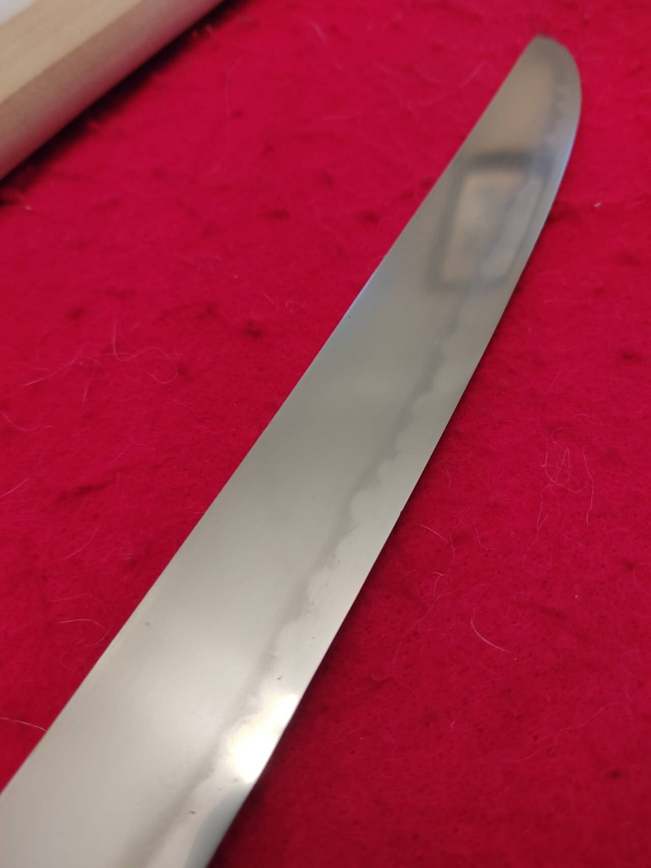

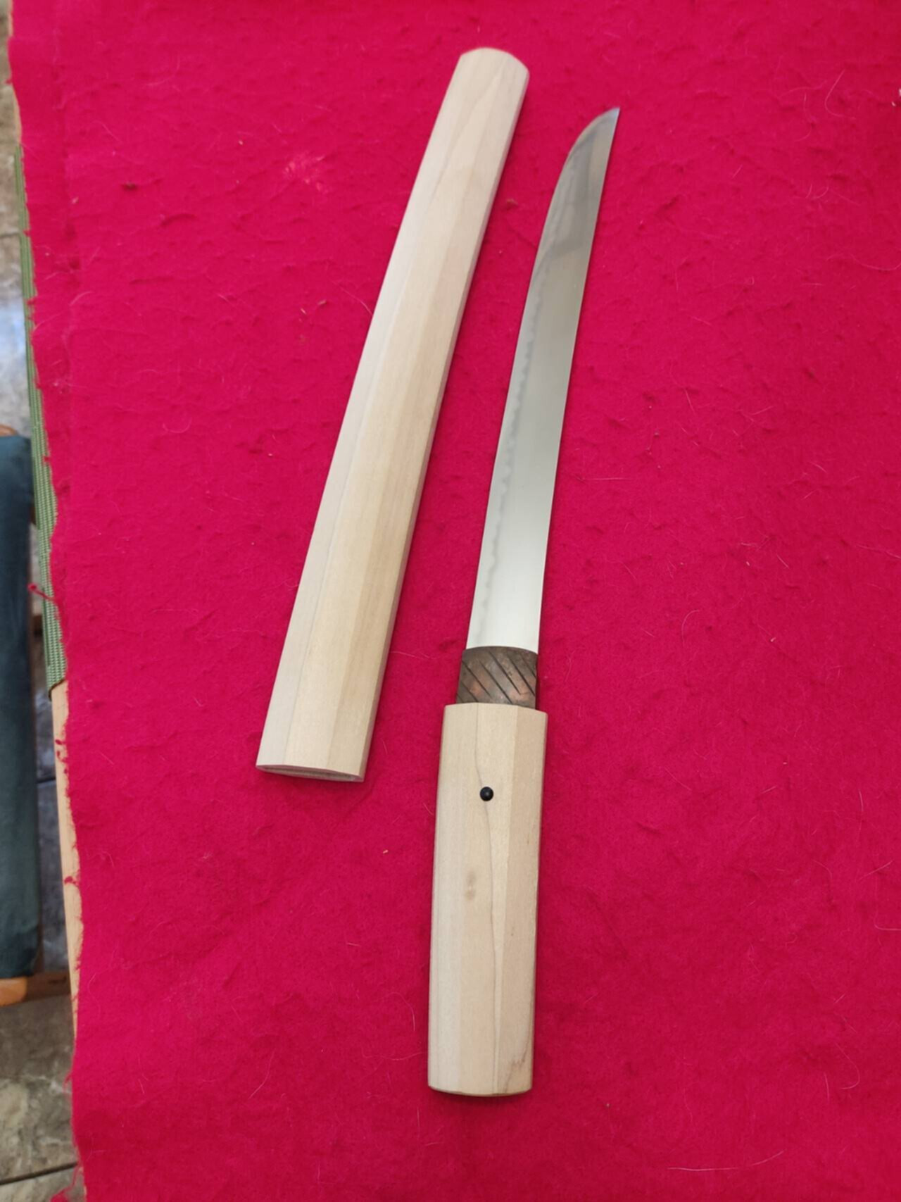

GrozaB Posted October 23, 2021 Report Posted October 23, 2021 Picked up this waki on gun show. Nowadays I almost don't see any nihonto on shows any more, just some WWII stuff...This one is puzzling me. Nagasa is 308mm, just a bit longer, then tanto. Motogasane 5.8mm, motohaba 29.7mm, sori 3.8mm, nakago 120.6mm Hada is very tight itame with some large itame elements, very hard to see. Hamon is mostly formed by nioi with very few nei. It is mumei, so no hints... So, what do you think about it? Shinto Bizen? Shinshinto? 1 Quote

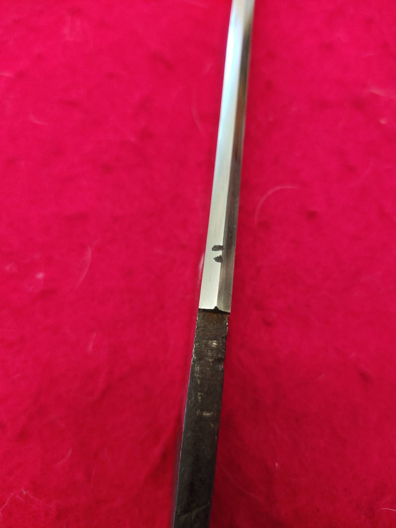

Alex A Posted October 25, 2021 Report Posted October 25, 2021 Hi Oleg, Not many replies so far, probably because its a difficult one. Does not land in Sue-Bizen for me. The blade itself looks well made and later, the nakago appears later. Without spending a lot of time looking at the clues its hard give an opinion. Was thinking one of the "country smith" schools that worked in other styles such as Bizen, maybe, forget the name as brain hasnt fired up yet. (so still considering late Koto) Got some clues there, file marks, shape of nakago, boshi (looks distinct) and clear blade showing details. If get time over next few days will take another look. Cheers Quote
PNSSHOGUN Posted October 25, 2021 Report Posted October 25, 2021 Hamon reminds me abit of the 2nd Gen Kanemoto's early relaxed Sanbonsugi. Quote

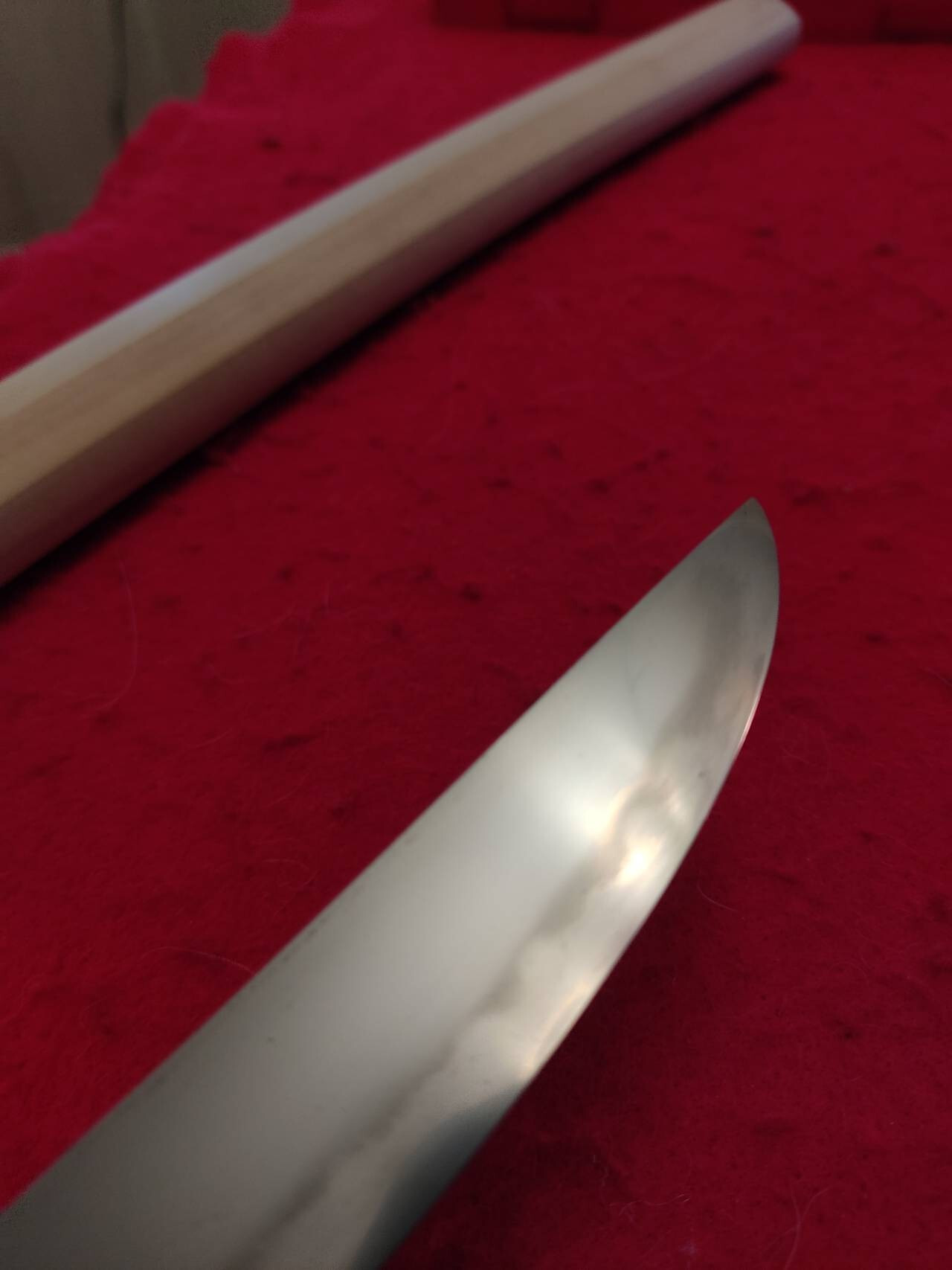

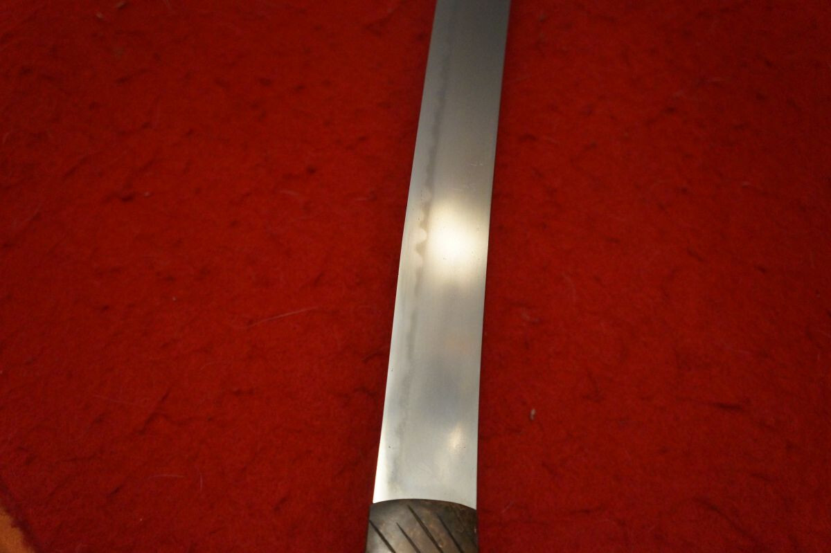

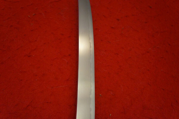

GrozaB Posted October 25, 2021 Author Report Posted October 25, 2021 I will try to make better photos today, but this one is hard one photo Quote
SteveM Posted October 25, 2021 Report Posted October 25, 2021 I think this might better be called a sunnobi tantō rather than a wakizashi. It's right on the borderline of classification, but I think at this size and with this construction (hirazukuri) it's more appropriate to call it a tantō. Your mileage may vary. 3 Quote
GrozaB Posted October 25, 2021 Author Report Posted October 25, 2021 On 10/25/2021 at 3:34 PM, SteveM said: I think this might better be called a sunnobi tantō rather than a wakizashi. It's right on the borderline of classification, but I think at this size and with this construction (hirazukuri) it's more appropriate to call it a tantō. Your mileage may vary. Expand You right, it is right on the border. But in this particular case considering size and form of nakago and sori I think ko-wakidzasi will be more appropriate term. But, I can be wrong. Quote
ROKUJURO Posted October 25, 2021 Report Posted October 25, 2021 Regardless of its former use (probably as a TANTO), the NBTHK will call it a WAKIZASHI. For me too it has a MINO look. The pictures are not good, so I am not sure about what I see, but the polish looks a bit strange to me. 1 Quote

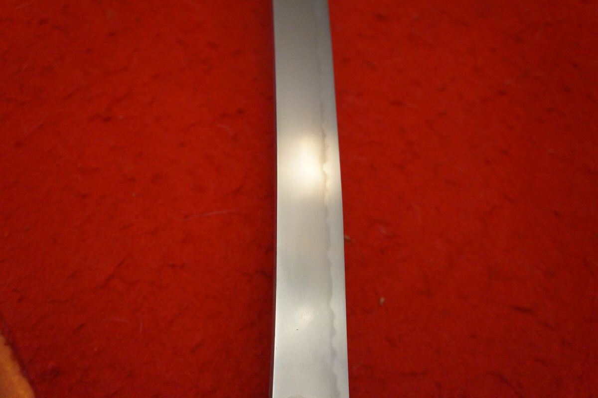

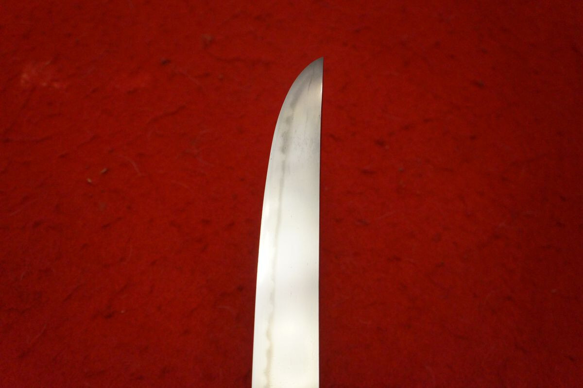

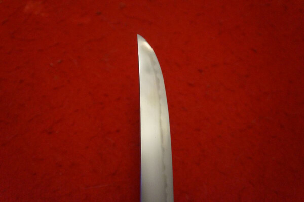

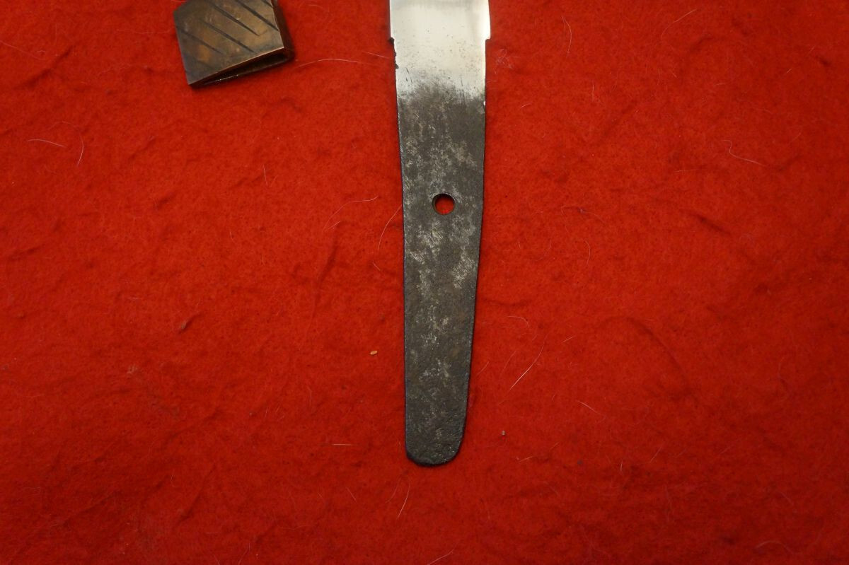

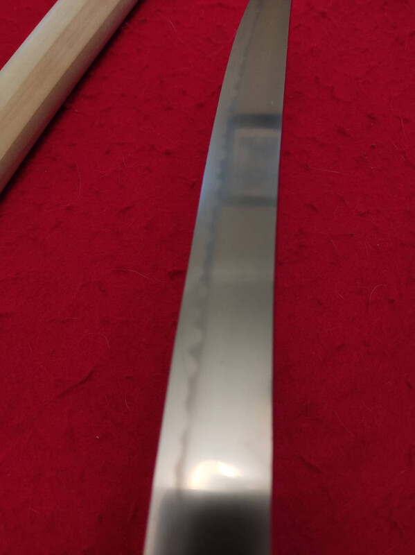

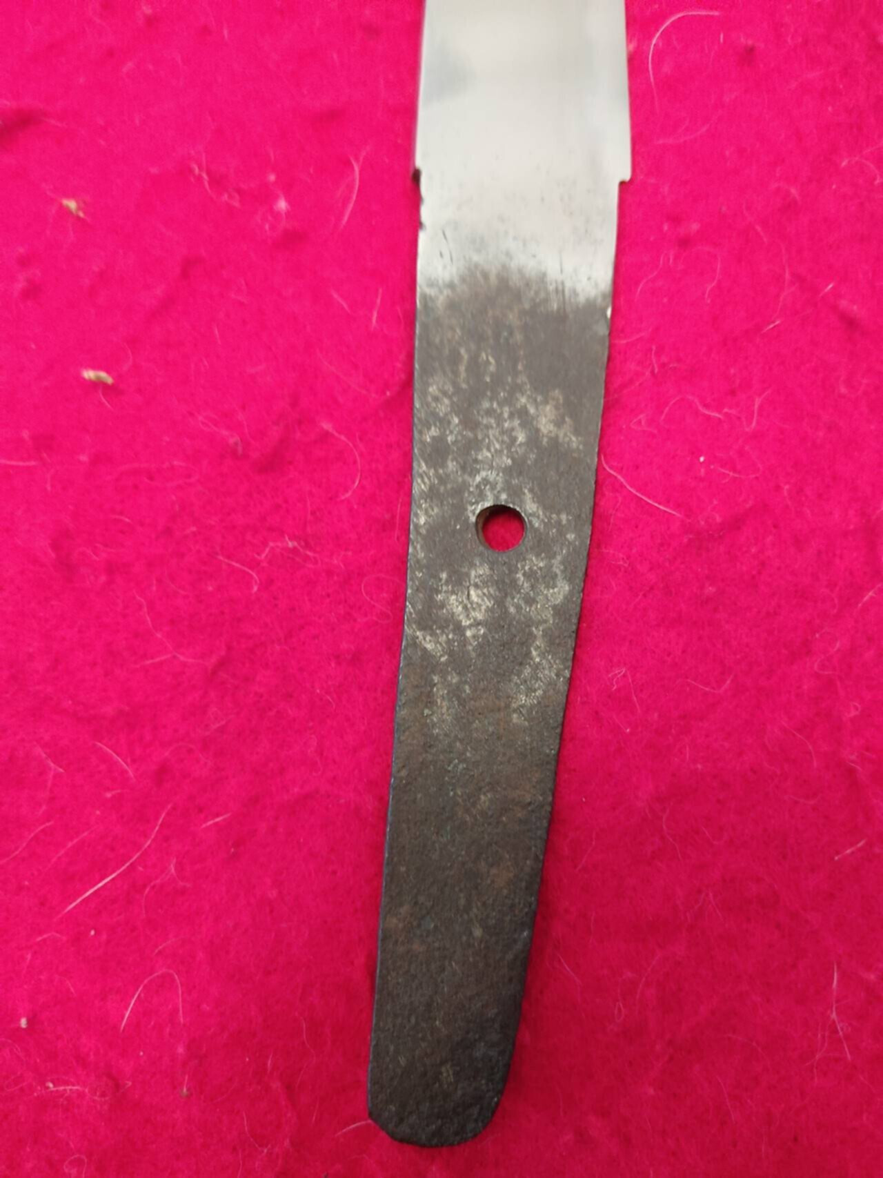

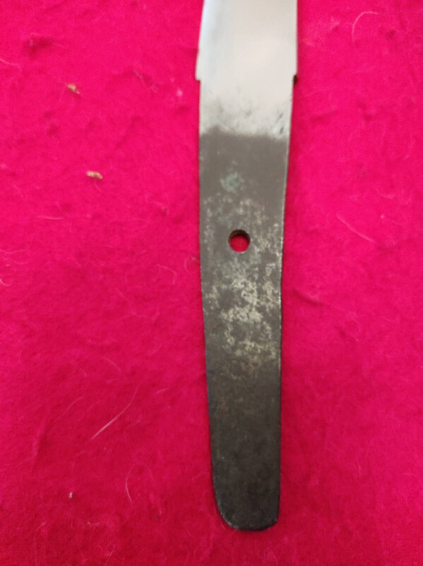

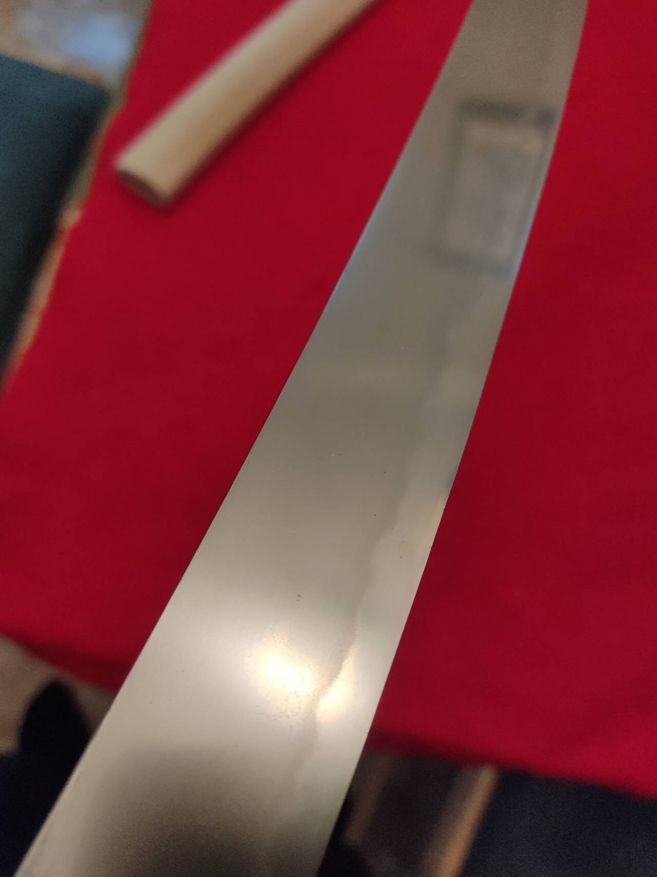

GrozaB Posted October 25, 2021 Author Report Posted October 25, 2021 Here some more photos, hope they are better... Quote
Rivkin Posted October 26, 2021 Report Posted October 26, 2021 The hada is very dense and without o-hada or ware or anything else common in late Muromachi. The nakago is also a bit light for that. Hamon does not show any sub-structure, a single mass. It appears to be late. I think its owari 1700 or even somewhat later, related to: http://sanmei.com/contents/media/A42776_T3546_PUP_E.htm 1 Quote
GrozaB Posted October 26, 2021 Author Report Posted October 26, 2021 On 10/26/2021 at 2:01 AM, Rivkin said: The hada is very dense and without o-hada or ware or anything else common in late Muromachi. The nakago is also a bit light for that. Hamon does not show any sub-structure, a single mass. It appears to be late. I think its owari 1700 or even somewhat later, related to: http://sanmei.com/contents/media/A42776_T3546_PUP_E.htm Expand Maybe you right, but all Owari tanto I saw was bit on the heavy end, with thick blades. Also all of them had no sori. But again - my experience is very limited. Quote

Alex A Posted October 30, 2021 Report Posted October 30, 2021 On 10/25/2021 at 10:50 AM, GrozaB said: I will try to make better photos today, but this one is hard one photo Expand For what its worth, think Kirill may be on the right track. Very difficult from these images. Sue Mino Jihada is said to be blackish, i can only speak of the typical Sue Mino i have seen and when put next to later blades then it becomes more obvious. The blade above, steel seems more refined than Sue Mino. Im looking at pictures though so a lot easier for you to judge. I also think Mino when i look at the blade, but not the end of the Muromachi, more Edo. Perhaps wrong and is Sue Mino, or later Owari, but wouldnt be surprised if it turned out to be something like Jumyo or obscure smith. Unless its textbook then attribution is difficult, be good to see what a Shinsa team calls it. Ps, pc only lets me reply if i quote someone, not sure what the hell is going on. Quote
GrozaB Posted October 30, 2021 Author Report Posted October 30, 2021 On 10/30/2021 at 8:32 AM, Alex A said: Perhaps wrong and is Sue Mino, or later Owari, but wouldnt be surprised if it turned out to be something like Jumyo or obscure smith Expand On another forum (https://forum.guns.ru/forummessage/188/2736762.html) BurN attributed this sword to Jumyo Mino-Owari, late Edo. His attribution usually very good even in case of bad photos. +/-200 years I spend last few days looking on Jumyo blades from koto to late edo. More or less this one matches Jumyo style. But few things still don't really fit - hada is close match to Sue Koto sword, hamon is more shinto, nakago conditions screams shinshinto... Also almost all late Jumyo I saw had may, with very few been mumei. As I understand Jumyo swords was very popular as gifts and mei played important role in it. Submitting this one to shinsa... I'm not sure it worth it. I defiantly not high end sword, and papers will change very little of that. Quote
Alex A Posted October 30, 2021 Report Posted October 30, 2021 On 10/30/2021 at 3:24 PM, GrozaB said: On another forum (https://forum.guns.ru/forummessage/188/2736762.html) BurN attributed this sword to Jumyo Mino-Owari, late Edo. His attribution usually very good even in case of bad photos. +/-200 years I spend last few days looking on Jumyo blades from koto to late edo. More or less this one matches Jumyo style. But few things still don't really fit - hada is close match to Sue Koto sword, hamon is more shinto, nakago conditions screams shinshinto... Also almost all late Jumyo I saw had may, with very few been mumei. As I understand Jumyo swords was very popular as gifts and mei played important role in it. Submitting this one to shinsa... I'm not sure it worth it. I defiantly not high end sword, and papers will change very little of that. Expand I dont think its Shinshinto, more early Edo for me Thing about nakago, sometimes they are in good preservation and the other side of the coin is who is to say it wasn't messed with at a later date Along these lines maybe Early Edo period Katana Unsigned by Jumyo for sale | Samurai Museum Shop Quote
