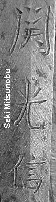

I am looking for an "approved" jishin mei by RJT smith SEKI MITSUNOBU.
On Dr STEIN's oshigata page, there are 3 different mei  (attached pics) wich leads me to think some are nakirishi mei, or maybe he just changed his mei style?
I would guess jishin mei are more likely found on his earlier blades. I only saw blades dated 1944 so maybe he just worked one year?
If you have oshigata or own a gendaito by this smith, it would be great to share a close up of the mei and indicate the year too.

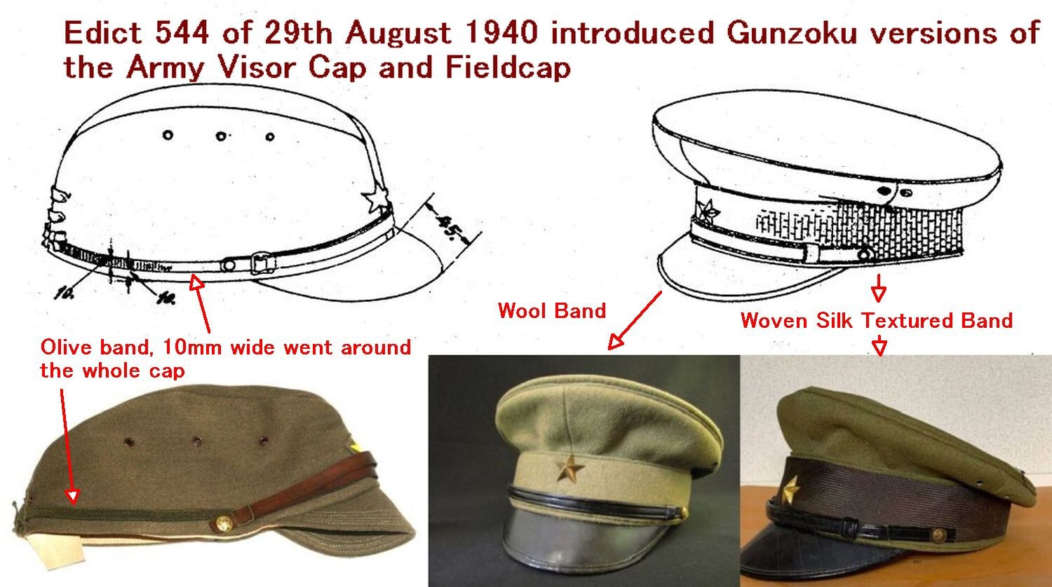

I think the hat that guy wearing is not an official army cap. Just the Army-style 軍屬/civilian cap. Note the hats the two girls on the left are wearing, the photo was taken in 1943 at 福岡。

Maybe you are correct regarding the caps, to me Mitsunobu sure has a different cap from the other guys.
