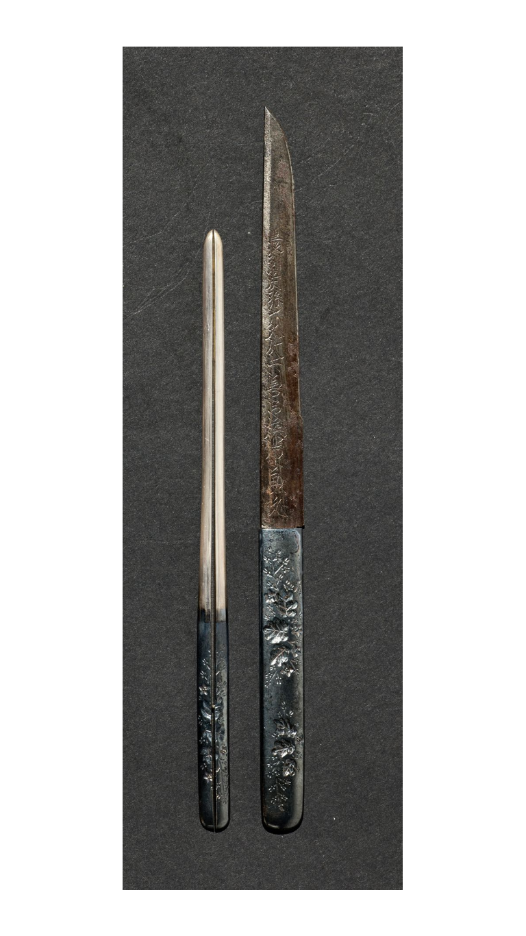

Kurikata Posted October 12, 2021 Report Posted October 12, 2021 Hi, I am unable to decypher so many kanji and assistance is strongly needeed. Thank you for your help Quote

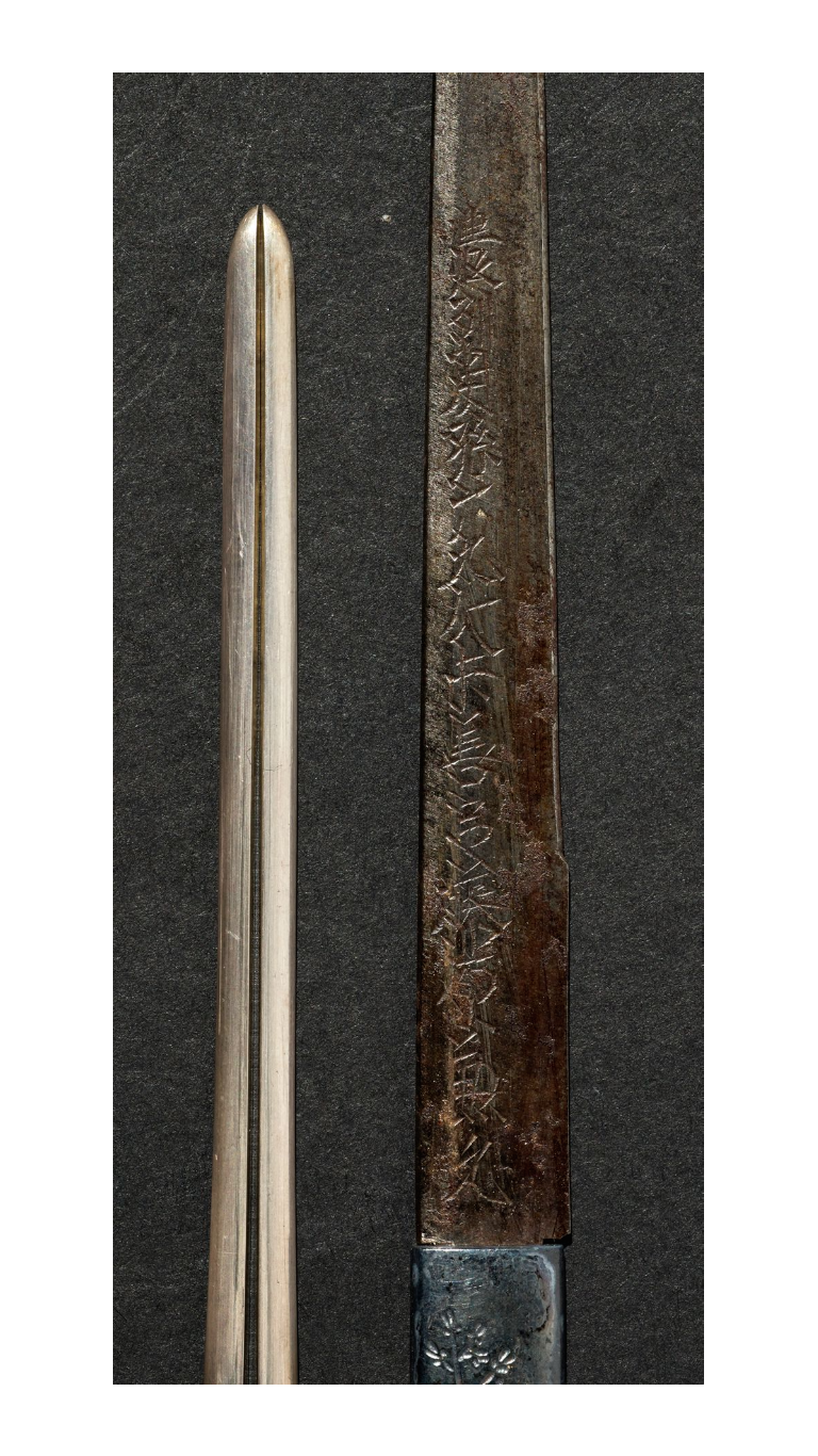

Kurikata Posted October 12, 2021 Author Report Posted October 12, 2021 Thank you Ray, I have focused the signature if any help.... Quote
Ray Singer Posted October 12, 2021 Report Posted October 12, 2021 Perhaps Noshu Mino [_?_] Zenjo Fujiwara Kanechika 1 Quote
k morita Posted October 12, 2021 Report Posted October 12, 2021 A descendant of the 9th generation of Zenjo Fjiwara Kanemoto from Noshu Skeki no Magoroku . 6 Quote
Ray Singer Posted October 12, 2021 Report Posted October 12, 2021 Thanks so much Morita-san, I didn't see moto at all. Kind regards, Ray 2 Quote
Kurikata Posted October 13, 2021 Author Report Posted October 13, 2021 once again a great thank you to you Morita San. Quote
