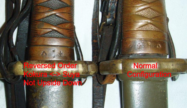

Kiipu Posted October 9, 2021 Report Posted October 9, 2021 (edited) On 10/9/2021 at 10:53 AM, robinalexander said: The first stamp is Kokura arsenal and what's unusual (or wrong?) about that is I have never seen it come first, in the line of three stamps. Expand Sharp eyes you have there! copper-handle NCO sword questions Edited October 9, 2021 by Kiipu 1 2 Quote

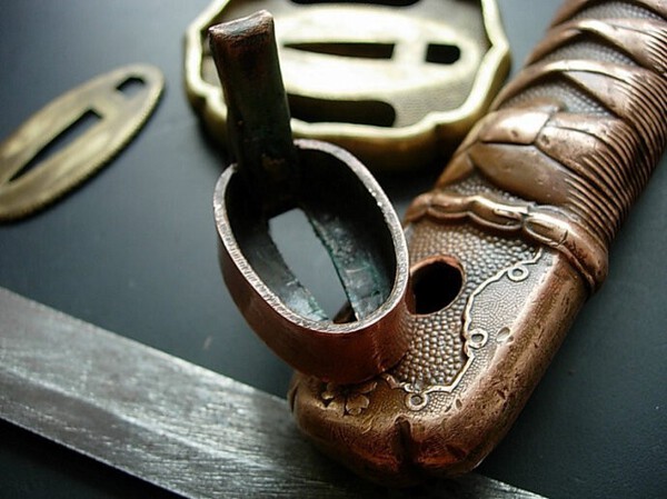

BANGBANGSAN Posted October 10, 2021 Report Posted October 10, 2021 On 10/9/2021 at 11:49 AM, robinalexander said: Is if possible someone has simply dissasemmbled the tsuka and put the fuchi back on upside down? Rob Expand With way lock set up,it can't be put upside down. 3 2 1 Quote

BANGBANGSAN Posted October 10, 2021 Report Posted October 10, 2021 On 10/10/2021 at 5:31 PM, Mario said: Ich habe noch eins im Netz gefunden das falsch gestempelt ist. Soll original sein. Expand This one is correctly stamped. 1 Quote
Bruce Pennington Posted October 11, 2021 Report Posted October 11, 2021 The stamps are correct, the order is reversed from the norm. 1 Quote

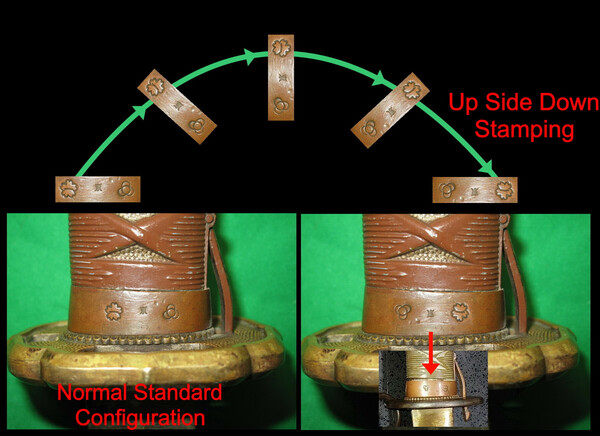

Stegel Posted October 11, 2021 Report Posted October 11, 2021 The stamps are correct and also in the correct order. Rob nearly got it right, but as BangBang has shown, the fuchi cannot be reassembled upside down. If you look carefully, the whole 'SET' of stamps is upside down. Bruce is right, it looks like human error to me too. A picture is worth a thousand words so i got a chance to play with some software and made this up. 4 1 Quote
Bruce Pennington Posted October 11, 2021 Report Posted October 11, 2021 You've got some fun software there @Stegel! So the stamping guy had the whole gunto upside down when he did the stamps, like you said in the right order, but when righted, upside down and flipped from normal. 1 Quote

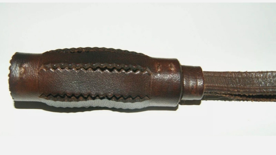

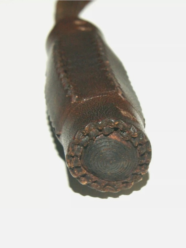

Mario Posted October 13, 2021 Author Report Posted October 13, 2021 Hello Maybe someone can help me or even sell me looking for a suitable tassel. greeting Quote
Bruce Pennington Posted October 14, 2021 Report Posted October 14, 2021 Mario, I don't see any real ones for sale on ebay right now. This dealer is good and has one for sale for $300 AUS, which is a really good price! I've paid $400 USD for mine in the past. https://guntoartswords.com/010957.html 1 Quote
Smee78 Posted October 14, 2021 Report Posted October 14, 2021 Looks like a nice clean example, congrats on the new addition. As for the tassel, good luck. They seem to be getting harder to find a good example. 1 Quote

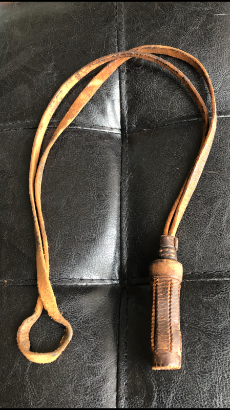

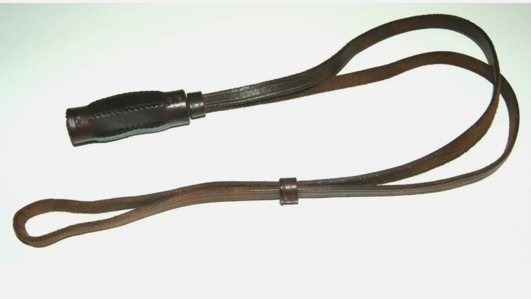

Mario Posted October 21, 2021 Author Report Posted October 21, 2021 On 10/21/2021 at 5:42 PM, Mario said: Hello I found a nice tassel. Is it original? Greetings to all Expand Quote
Bruce Pennington Posted October 21, 2021 Report Posted October 21, 2021 Maybe @Stegel or @PNSSHOGUN can say for sure. To me it looks like a good reproduction. Here’s a picture of one of mine. You’ll see some differences. 1 Quote
Kolekt-To Posted October 22, 2021 Report Posted October 22, 2021 Bruce's tassel: Gut! Mario's potential tassel: Nicht gut. 1 Quote
Mario Posted October 22, 2021 Author Report Posted October 22, 2021 On 10/22/2021 at 5:43 AM, Kolekt-To said: Bruces Quaste: Gut! Marios potenzielle Quaste: Nicht gut. Expand I found this. Look the same 1 Quote
Bruce Pennington Posted October 22, 2021 Report Posted October 22, 2021 That one looks more correct. Accurately aged and stitching looks right. 1 Quote
