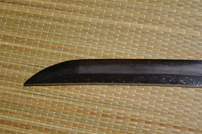

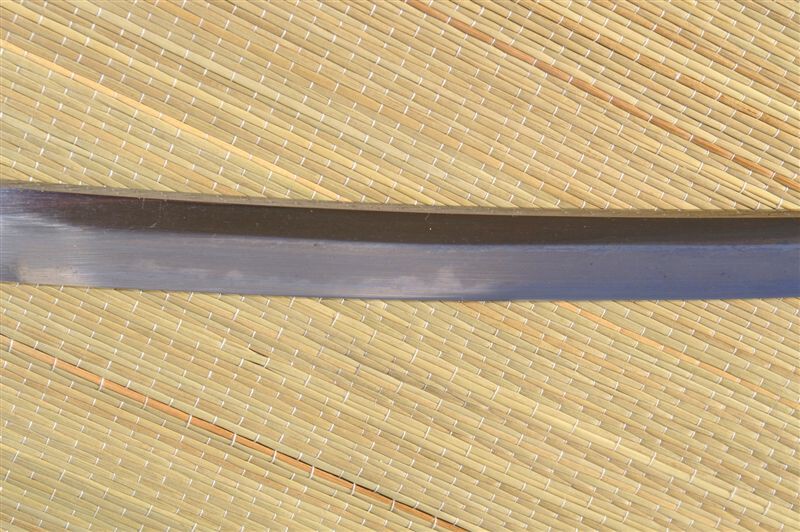

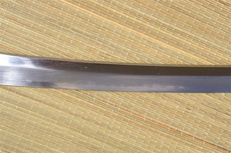

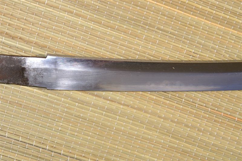

Hi All,
Got this wakizashi today, tell me what you think.
Any guestimations on age (the seller guesses Edo, which is pretty broad), and any recommendations on a polisher?
By the way, taking pics of the hamon is a MAJOR pain; it is like trying to photograph a ghost.
Thanks!
Mark

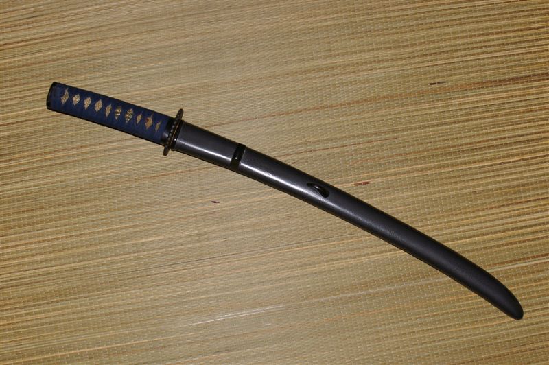

A nice tight rig. The fittings are attractive on this wak. I can't tell much about the blade. I can understand why you want a polish. Did someone remove rust with steel wool? To which smithor school was this attributed when you bought it? John
I really like the look as well, it is MUCH nicer in person than on the pics!
Not sure on the steel wool, but there's no rust... I REALLY hope they didn't use steel wool, but ????
The seller didn't quote a school or smith, only that they thought it was an "edo" blade, well that narrows it down to a few hundred years of possibility.
Hence my request for help, pathetic newbie that I am :bowdown:

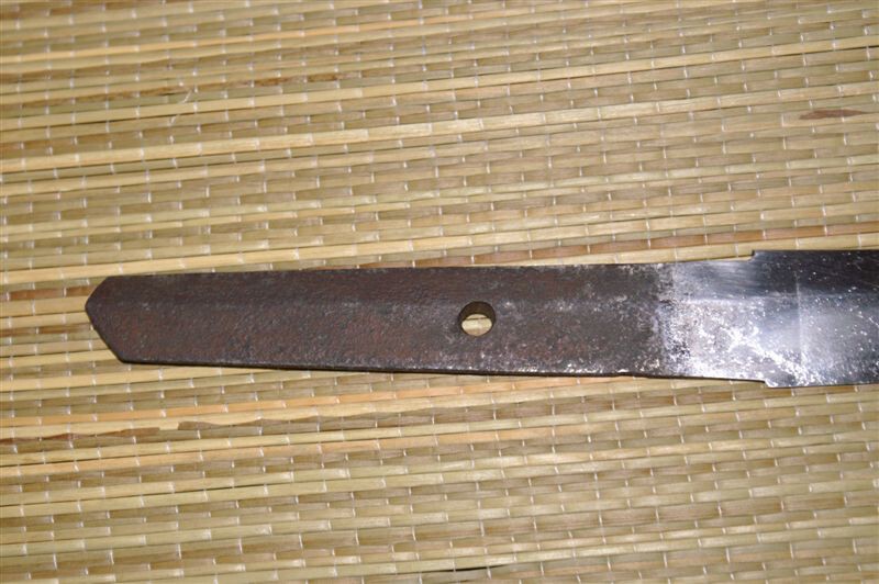

Mark,
Yo're gonna be disappointed, it looks like a Shinto nakago with some togari which could lead to some Mino influences (as more than 80% of Shinto blades). If anybody else can add any comment he is welcome. That's all one can say (I am talking of myself).
Unless very characteristic (Sudareba, ...) determining the smith, the school, from bad polish blades with poor pictures is impossible.
Don't be taken aback about my comments about bad pictures, I have never been able to take decent pictures of a blade. The best is to scan it, but here again you have to choose very carefully the scanner.

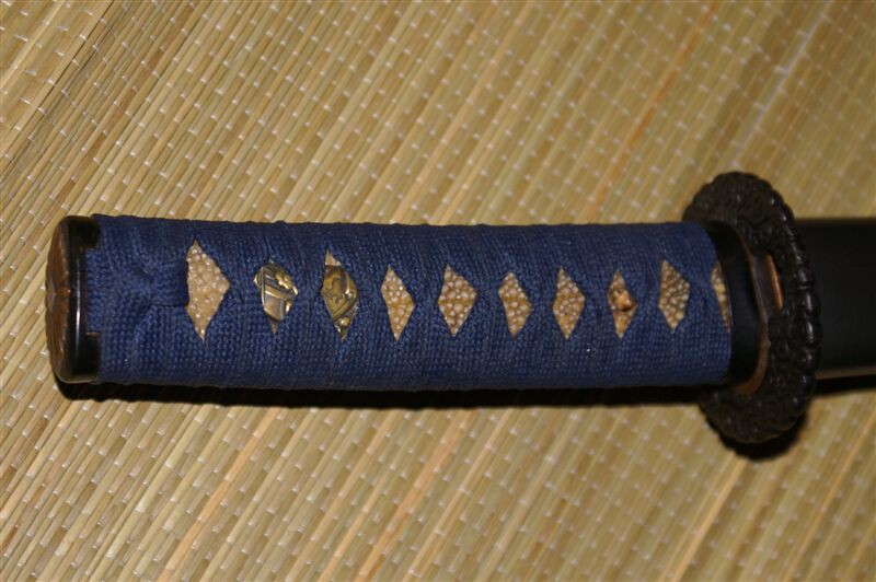

Not bad. From what I can see on your pics, the tsuba might be cast iron, though. I might be wrong as I am over-cautious and usually completely wrong when it comes to a tsuba :oops: . Could you post some pics, please?
Okay guys you're freaking me out here... you've seen worse... My pictures really do suck, because it is way better than what it looks.
Let me get on that scan, so I can show you what I see.
I'm just happy that as far as I can tell, there are no major flaws or damage and even though it needs a polish it has a very active hamon.
Can't really tell the hada, simply because I am not quite there yet on education, but it definitely has a hada.
At the end of it all is it work paying over a thousand for a full polish on it?

Dear Mark!
Blade looks a bit like Bungo Takada school, late Shinto,. After polish there will be a few openings visible, so I seriously question a new polish which exceeds 500 bucks. Mounting looks entirely homemade.
Brian is right. Save your money and rather invest in a nice polished katana, maybe with papers, starting at roughly 3000,-. With what you paid for your blade you did not lose money - not yet!

I am not thrilled by the koshirae, tsuka wrapping but the blade in itself seems interesting. Problem: as it is not signed or papered, don't loose money in getting it polished.
Nobody knows what will happen during the polishing process. I had a Kaneyasu shinto katana with some rust and long ware opening on the shinogiji. It came back from polishing as brand new without any ware, fantastic.
I'll second the comment by Mariusz that the tsuba looks to be a repro, cast jobbie :( . That in conjunction with the poor tsuka-maki ( as was also pointed out by peter ) makes me wonder if the tsuka isn't a put together job.
The rust on the nakago looks odd to me also...but that may just be the photos. You've got decent, old black rust which is as it should be, but also what looks like active red rust. I wonder if the nakago wasn't over-cleaned when the blade was scrubbed and an attempt has been made to repatinate the tang.
Personally I'd move it on asap and set my sights a little higher. No point throwing good money after bad. :(
Sorry to be so blunt about it but I don't believe it helpful to sugar the pill. It doesn't really matter that it only cost $750...poor quality remains poor quality even if it's free. :dunno: The level you have suggested you're at is also greatly irrelevant....if you genuinely can't see the difference in material quality between this blade and some of the more reasonable offerings available on-line from reputable dealers then I don't think any amount of study will fix that. I think you may be kidding yourself.

As has been pointed out and I will certainly agree my pictures are not doing this blade justice at all and my scanner looks even worse as they are out of focus.
Looking at it right now, I know what steel wool does to metal and I have VERY good eye sight. There is no sign of any scrubbing off of rust with steel wool on this blade at all and the pics of the nakago are not true to life either as there is zero visual sign in good light of any active rust (I double checked).
I do feel a polish would return this blade to a more pristine state visually, but also agree that it may not necessarily be the best choice for the blade, which for right now has no significant flaws other than not being the "prettiest girl at the dance".
Interestingly enough, I don't quite agree that the tsuba may be cast as there is no seam at all and the cloud or swirling water design is very intricate.
