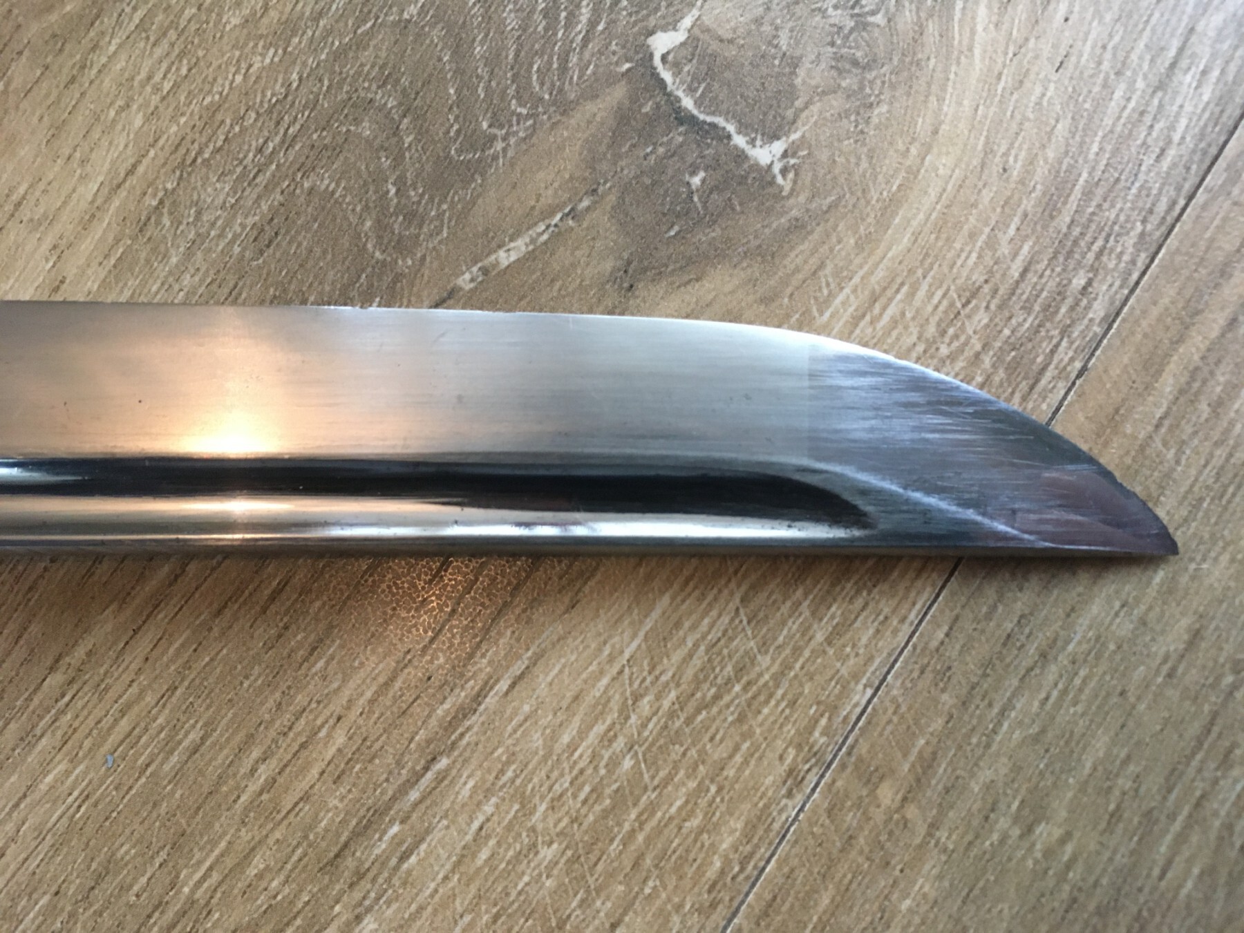

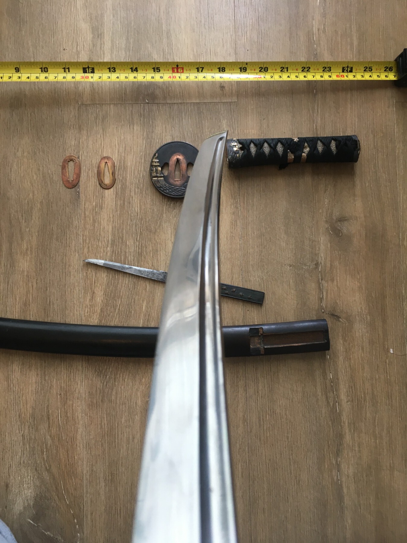

PeterGB Posted October 4, 2021 Report Posted October 4, 2021 Hi everyone, I'm hoping someone might be able to help me with identifying this sword. It was gifted to my mother around 40 years ago by a family friend who, in turn, had it in her possession for a number of years. It is now mine and I'm hoping to learn about it. I believe the friend had a contact in Japan but unfortunately she has passed on and I'm unable to find out any history on how she got it. I have been reading through some websites and am keen to learn but being new to this topic there is quite a steep learning curve and I'd appreciate any information or advice anyone can provide to get me started. I have attached some photos below and uploaded more photos to this imgur link (due to being limited on how many photos I can upload to the forum) which I hope will help. Thank you Quote
ChrisW Posted October 4, 2021 Report Posted October 4, 2021 You have what appears to be an older, traditionally made wakizashi. A wakizashi is a blade that is shorter than 24" but longer than 12". However, for more to be gleaned, we would need some close up shots of the activity in the metal. Specifically, closeups of the kissaki (pointy end), the nakago (the part that goes into the handle), and shots of the hamon/side of the blade that shows details in the metal. 1 Quote
PeterGB Posted October 4, 2021 Author Report Posted October 4, 2021 Hi Chris, Thank you for your reply, much appreciated! Here are a couple of photos of the kissaki (thank you for clarifying the terminology) I'll post some additional photos in another comment shortly. Quote
ChrisW Posted October 4, 2021 Report Posted October 4, 2021 Can you slide the metal collar (habaki) off? That should help too. Gut feeling is that the blade is an older, possibly Muromachi era blade. But I would wait to hear from more experienced members here. 1 Quote

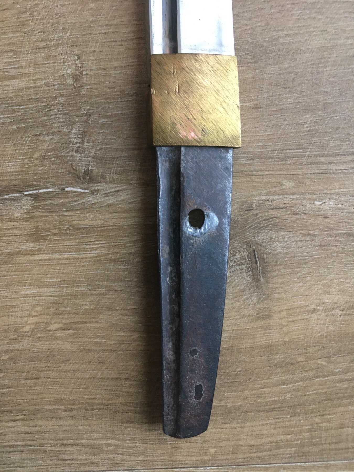

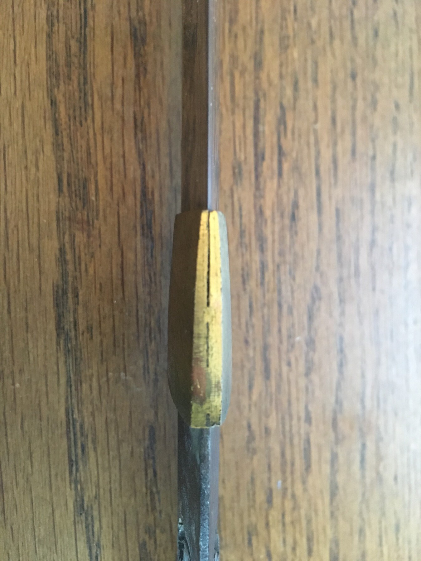

PeterGB Posted October 4, 2021 Author Report Posted October 4, 2021 Hi Chris, With regards to the habaki, I'm not sure how to remove it. It won't easily slide down as it tapers in at the top. I can try and force it but it might bend the habaki? Below are some photos which I hope explains what I mean... Quote
Shugyosha Posted October 4, 2021 Report Posted October 4, 2021 It looks slightly deformed anyway. Try something like WD40 or 3 in 1 oil under the habaki. That might help to lubricate it and will ease it if there is any corrosion underneath. Go easy with the quantity and keep it off the tang. Don’t clean the tang. 1 Quote

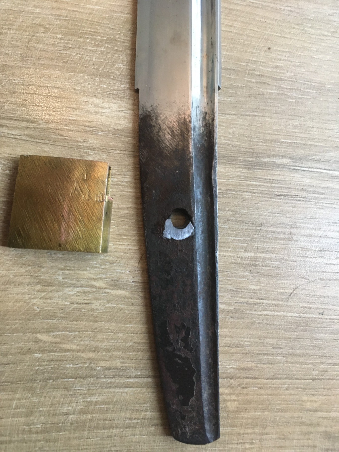

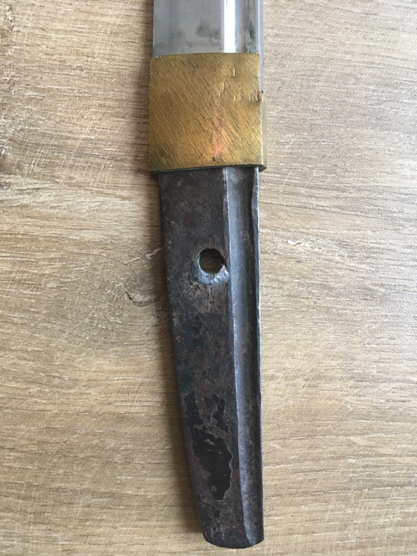

PeterGB Posted October 4, 2021 Author Report Posted October 4, 2021 Got it! Thanks for the tip Shugyosha. It came off with a bit of WD40 and knocking with some wood and a rubber mallet. Here are the pictures... 1 Quote

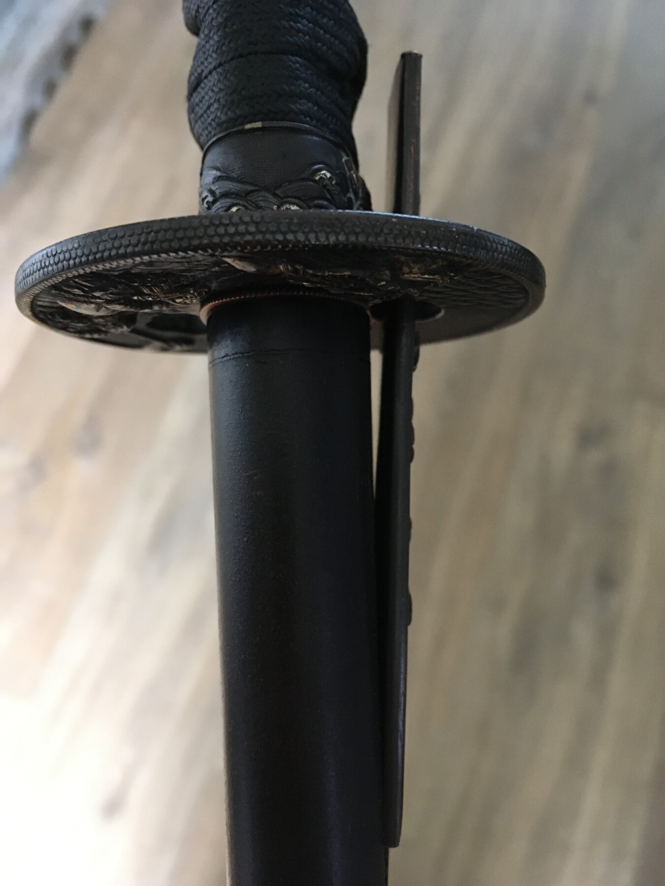

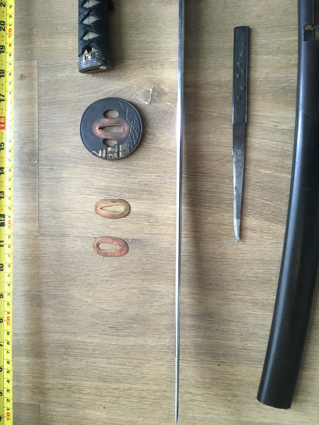

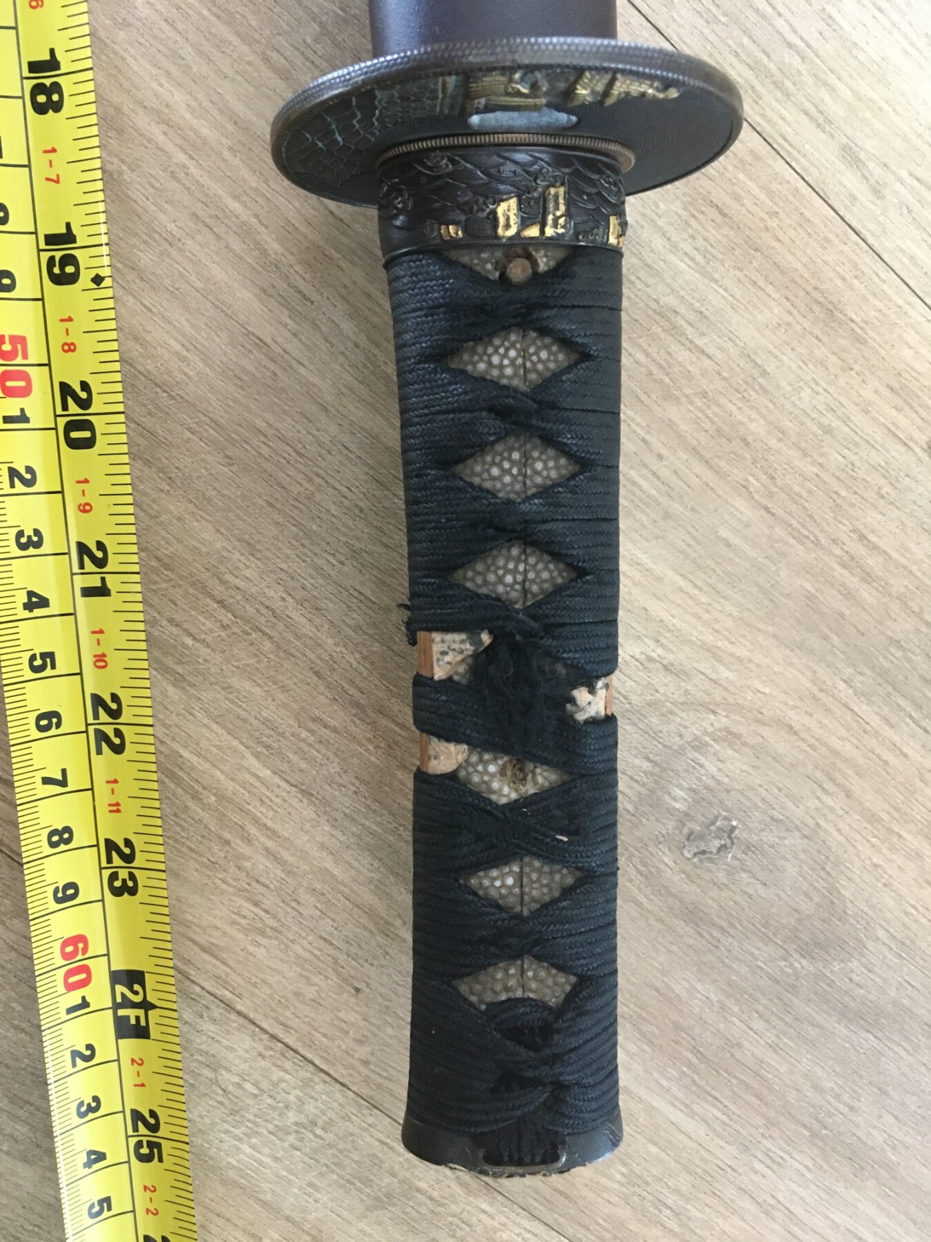

PeterGB Posted October 5, 2021 Author Report Posted October 5, 2021 If I may ask some additional beginner questions (I'll try and use the appropriate terminology, apologies if I make a mistake)... 1. Am I correct in thinking that the blade may not be the same age as the Saya (scabbard), the Tsuka (handle) and the Tsuba (guard)? If that's correct, what normally determines the change of these fixtures over time? 2. Judging from the end of the Saya (scabbard) it looks to be missing something (photo attached) is that correct? 3. The Tsuka Ito (photo attached) isn't perfect. Is this something that can or should be repaired? 4. Is there anything I should be doing with it, maintenance/care wise? 5. Is the repair around the hole in the tang common? Does it imply/suggest anything? 6. Is there a book that is generally recommended for complete beginners? 7. Looking at prices of certified Wakizashi's online, they aren't cheap but they aren't insane money considering the craftsmanship and age ($5k or so) compared to a vintage guitar etc this seems very fair. I'm presuming mine won't be near that in value, but if it's worth over $1k then I should probably add it to my home insurance, is that what most people do? Or is it too difficult to insure if it's not certified etc. Thanks in advance for any guidance with any of the above. Quote
Shugyosha Posted October 5, 2021 Report Posted October 5, 2021 Hi Peter, 1. Yes that is the case so: wear and tear, fashion if the owner is wealthy or status if a particular style of fittings was required for a particular duty. 2. Yes it’s called a kojiri. It could be replaced if you wanted to. 3. Up to you. Having the thread redone is relatively easy but there’s some damage to the ray skin underneath. There’s a guy in the UK who does good work and could perhaps do a wrap that would cover that damage. 4. Keep the blade dry and maybe lightly oiled, particularly if you’re by the sea. Lacquer can be sensitive to temperature so keep it in a room that has a fairly constant temperature. Don’t oil or clean the tang - the patina is an indicator of age and should be left alone. You can touch it with your bare hands but avoid touching the blade as oil from your hands will corrode it. 5. It’s not uncommon and isn’t something to worry about. It was probably done to adjust the fit of the peg, maybe on a different tsuka. 6. Yes, there are several: - off the top of my head: The Samurai Sword a Handbook by John Yumoto is popular and The Art of the Japanese Sword by Kapp and Yoshihara. 7. Give your insurer a call. My policy has antiques up to a certain value covered. Tell them you own an antique Japanese sword from the 16th or 17th century (finger in the air I’d guess it is pre 1600, but it’s hard to tell from here). I’d give it a value around £1,200 and see what they say. You’d probably have to pay something like that to replace an unsigned, mounted, koto wakizashi from a dealer. 3 Quote

ckaiserca Posted October 6, 2021 Report Posted October 6, 2021 Hi Peter, Your saya is also missing the Kurigata (栗形): The kurigata is a knob on the side of the saya for attaching the sageo (下緒). The sageo is the cord that is used to tie the saya to the obi (belt). 1 Quote
PeterGB Posted October 7, 2021 Author Report Posted October 7, 2021 Hi ckaiserca, Thank you for pointing that out. This raises a few further questions, if that's OK... 1. With regards to the kurigata, after reading your comment I read an article which said that the kurigata was normally stuck to the saya with a traditional glue and that you can re-stick it using wood glue (or even gorilla glue) - is that true? 2. If the above is true, does that mean I could try and acquire an Edo period kurigata and fix it to the saya myself? 3. I'm wondering if the kogatana is not the right size for the saya. It's not flush and is slighter wider than the groove. Also there is a crack on the saya which could be because the kogatana is too wide. Is that correct? If so, is the kogatana also something I could replace? I have attached some photos for reference. (If it is the wrong size, I wonder why someone would have done that) 4. Is it considered bad practice to replace parts? I guess I'm unsure as to the relationship between the all parts, are they all independent or should they be kept together as a set? On a semi-related note, I ordered The Samurai Sword a handbook by John M Yumoto; as suggested. I'm looking forward to reading it. Quote
Geraint Posted October 7, 2021 Report Posted October 7, 2021 Dear Peter. From your pictures it is clear that this wakizashi should have an implement called a kogai here, not a kozuka. You are right, this one does not fit, best keep it separate. As regards a replacement, these are not standard parts and fitting new one would be quite tricky. If you notice there are almost what looks like two spaces, the larger would be where the kurikata fits, the smaller would be a little piece that forms and protects the mouth of the kogai slot. These are often made of horn and its loss has probably contributed to the slight splitting of the saya. As to why someone would stuff an obviously oversized kozuka into the kogai slot, well, sometimes by accident; parts get mixed up and whoever puts them back together doesn't know what goes where, sometimes a collector or dealer will spot a nice kogai and sell it off and then stick something in it's place to make the whole thing look more complete. One more observation, the lower end of the nakago seems to have some fire scale on it, this is not a good sign and might men that the blade has been in a fire at some point which would remove the hardened edge. All the best. 2 Quote
