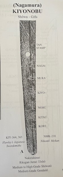

Chris Wallis Posted August 21, 2024 Report Posted August 21, 2024 On 8/21/2024 at 1:17 PM, Chris Wallis said: Expand Second tang characters only on one side . 1 Quote
xiayang Posted August 21, 2024 Report Posted August 21, 2024 The second blade is signed 長村清宣 = Nagamura Kiyonobu 1 Quote

Chris Wallis Posted August 21, 2024 Report Posted August 21, 2024 Does the inscription on the second sword tang indicate a region of manufacture or date at all ? Quote

mecox Posted August 21, 2024 Report Posted August 21, 2024 @Bruce Pennington@Chris Wallis@xiayang as Jan notes 長村清宣 = Nagamura Kiyonobu and family name is Nagamura Matsuichi 長村松市 is a Gifu tosho, born in Meiji 34 (1901) April 10. He was from Kamogun, Tahara-mura, Osugi village. Listed in Slough page 85, was Rikugun Jumei Tosho and of interest has a Tan stamp. 3 Quote
