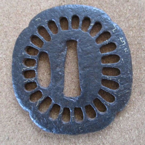

I like this piece, but the patina just seems ???.  Although it is wet looking under the right light from an angle, and under 20x magnification the patina is a very dark brown, it seems too uniform.  Would appreciate feedback.  dimensions are 8.2x8.1 cm but the thickness is very irregular;  rim varies from .354 to .175 cm and the area around the nakago hitsu .27 to .32 cm.  Will send pictures in 2 batches and try to show the interior walls of the sukashi.  All pictures taken inside but indirect exterior light.
Thanks,
john twineham
Thank you both!
    You may be quite correct.   I was suspicious, but not about waxing, more about a really good late period patinating solution; the reason why I tried to give a shot that showed some of the wall of the sukashi cuts was with that thought in mind.
    I just left a message with Michael Bell, who primarily makes swords but also tsuba, etc., and asked about the waxing.  He and his lead apprentice both have seen the item in hand, and did not mention wax, but I did not ask.  They both did say it had a wonderful patina.  I have 2 more available resources to show it to who might have some thoughts; one will be next weekend (Stephen Strauch), so will fill you in when I get Michael's response, and later when Stephen sees it in hand.
    Once again, thank you.
john twineham
Hi John,
I am a bit bothered that an iron tsuba that comes across as being of great age shows no evidence of having been mounted: no divots or copper inserts in the nakago-ana to adjust the fit or cushion the nakago from wear.
Grey
Very good point Grey, and one that I had wondered about.  As an alternative, if you look at the depression opposite the kozuka hitsu, it looks like the piece was hammered thinner, possibly to spread out and thus compress the nakago hitsu.  Since it is only .2 cm thick, perhaps the feeling was that chiselling divots in would not do very much and be risky, the same with copper inserts that might get easily dislodged.  Just a random thought.  Michael Bell says that the depression was certainly an intentional hammer stroke, not a bruise.
Thanks again!
John
I agree with Grey, I have my own suspicions about this piece.
Despite it appearing to have suffered a fair amount of corrosion it reveals to signs we'd expect of a non-homogeneous piece of tatara produced iron.  Just to clarify, pre-industrial iron in Japan that was forged etc. ( cast iron is a very different beast with it's own characteristics) was at no point a molten uniform mass, so it all looks a bit like filo pastry in terms of internal structure, of varying degrees of refinement, naturally. Here there are no signs of layering, inclusions and the like. In fact the basic material seems remarkably uniform....modern!, one might suggest.
Thanks Ford:

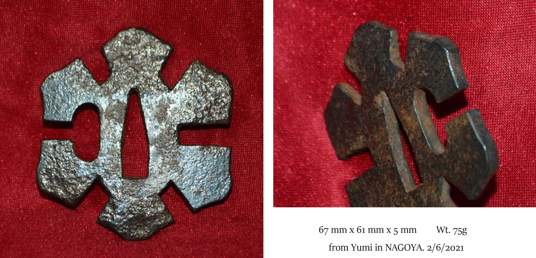

      I agree; something with real age and made with uniformity of metal, consistent patina, and little or no corrosion would seem impossible; modern metal with an interesting patination process could easily be the case, so Occam's Razor rules.  Would appreciate your opinion on the following if you would; Edo?  pictures taken outdoors in sunlight.
Yours,
John
I am not so fast thinking it is modern or waxed, I recently bough a small sized guard that at first sight looked too glossy [overexposed lighting in the photo] the secondary image was 'normal'. After I received it, under heaps of grime and flaked rust I discovered it was in fact 'glossy' and not waxed. I believe it is a yakite finish. It has been mounted at least once [see top of nakago-ana second image] I have seen many modern fakes and I don't think this is one.
If you believe your example is waxed - boil in water for a few minutes, won't hurt the piece as long as you dry it properly. Testing is always better than guessing.
Hi John
Your second piece is quite different. I can discern traces of irregular dendritic structure (modern material would be pretty uniform) in the breakdown of the surface due to corrosion. The surface corrosion is reasonably varied, I see one or two fissure like folds just visible, again due to corrosion. One such fold is to be seen trailing off the bottom outer edge of the kogai hitsi in the top image. Another at 10:30 on the same image near the mimi.
And the wear around the kogai hitsu and nakago-ana is a bit like broken off stone, again exactly what I'd expect from corroding and friable old metal. Compared to modern iron/steel, which is quite pliable when in an unhardened state, old forge weld consolidated sponge iron (tatara material etc.) is somewhat crumbly. I use, almost exclusively now, old mid 19th century finely wrought iron in my own work, and even the best material, which looks flawless to the naked eye, has a grainy structure under the chisel and can tear and break in ways that are simply not the same as homogeneous steel. Actually this is a good example to contrast with the first piece to illustrate those subtleties that distinguish modern from pre-industrial iron.
I've attached a microphotograph of some dendritic structure in a modern steel as a guid to what can be seen on this old tsuba. Uniformity is of course the aim in modern metallurgy whereas pre-industrial stuff is inevitably much less ordered, even when relatively well processed.

It looks to be that they went heavy with an abrasive high grain wet sand till they got to a point to then change to a 2000 wet dry that had a red grit instead of dark grey and they hand buffed the rest of the rust and the colour of the grit into the actual iron itself.
That's why the inside still looks to have a normal texture of decay and rust age with a bit of the original iron colour peeking out.
I think this piece is legit.
They just messed the top layer of iron.
Or I could be completely mistaken.
I happen to really suck with my judgement lately.
"Sunny"- but at least with the courage to put your opinion out there for others to consider.
