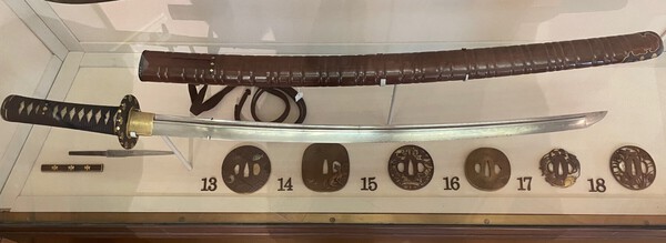

Wolfmanreid Posted September 26, 2021 Report Posted September 26, 2021 This sword is in the Fitzwilliam Museum in Cambridge England. Sadly the museum staff knew nothing about it and claimed it was a low quality mass produced piece. I rather doubt that as it looks to be in fairly high quality koshirae with a well executed bohi and complex hamon. Perhaps I am showing my ignorance and I would welcome any comments. 1 Quote
ROKUJURO Posted September 26, 2021 Report Posted September 26, 2021 Reid, thank you for sharing! It is a common knowledge that many museums do not have knowledgeable employees when it comes to Japan and its culture. I think your impression is correct that this could be a nice sword with an older blade and high-end KODOGU. Talk to the museum staff or take an expert (preferably from the NMB) there to advise them. 1 Quote
Brian Posted September 27, 2021 Report Posted September 27, 2021 That sword needs to be investigated further. Looks to be a high class traditional sword, and is 100% NOT a mass produced low quality piece. Put some pressure on them to have it evaluated. Quote
Gakusee Posted September 27, 2021 Report Posted September 27, 2021 Reid How many Japanese swords are there in this museum? Perhaps we can go and visit them as To-Ken Society of GB and talk to them and evaluate the collection. We are, for example, having a members' meeting at the Ashmolean Museum in Oxford in mid-October to view some of the Church collection of tsuba and swords that the Ashmolean holds. On to this sword, it looks like an interesting Bizen blade in high-quality mounts and merits a closer inspection. 2 Quote
Rivkin Posted September 27, 2021 Report Posted September 27, 2021 Its Bizen Ichimonji style. Kissaki proportions at the very least are not Kamakura, as is shape. There are "crab claws". There a big of fumbari here, but can be distortion from wide angle lens. I think, either Ishido from around 1640 or late Muromachi ...mitsu or Naotane in his Muromachi Bizen style. Boshi would be extremely useful to be more precise. I suspect Ishido, but I always say that. Got burned too many times on those Ichimonjis. Quote
Gakusee Posted September 27, 2021 Report Posted September 27, 2021 Kirill I do not think it is Ichimonji. The shape is later, the hamon is Oei+ (so from Oei onwards) with its slanting and crab claws. If we had better polish and detailed close-ups, views of the shinogi-ji and boshi and very importantly - hada, we might be able to say with greater certainty. Quote
Wolfmanreid Posted September 27, 2021 Author Report Posted September 27, 2021 On 9/27/2021 at 8:46 AM, Gakusee said: Reid How many Japanese swords are there in this museum? Perhaps we can go and visit them as To-Ken Society of GB and talk to them and evaluate the collection. We are, for example, having a members' meeting at the Ashmolean Museum in Oxford in mid-October to view some of the Church collection of tsuba and swords that the Ashmolean holds. On to this sword, it looks like an interesting Bizen blade in high-quality mounts and merits a closer inspection. Expand This is the only one at the Fitzwilliam although they have quite a nice collection of European and South Asian arms and armor otherwise. They do have a lovely kabuto in the shape of an abalone. Apparently this sword was in the family of the donor since the mid 19th century and the inheritor (a fellow Cambridge alum) donated it to the Fitzwilliam. Quote
BIG Posted September 27, 2021 Report Posted September 27, 2021 Quick research..https://data.fitzmuseum.cam.ac.uk/search/results?query=Japanese+swords+and+koshirae&operator=AND&sort=desc Bishu Osafune (No) Ju Sukesada Awataguchi Omi (No) Kami Tadatsuna BEST 1 Quote
Jussi Ekholm Posted September 27, 2021 Report Posted September 27, 2021 I would think it is this one by Sukemitsu: https://data.fitzmuseum.cam.ac.uk/id/object/163213 The description of the koshirae matches and as Michael and Kirill said above it seems to be Muromachi Bizen. 2 Quote
